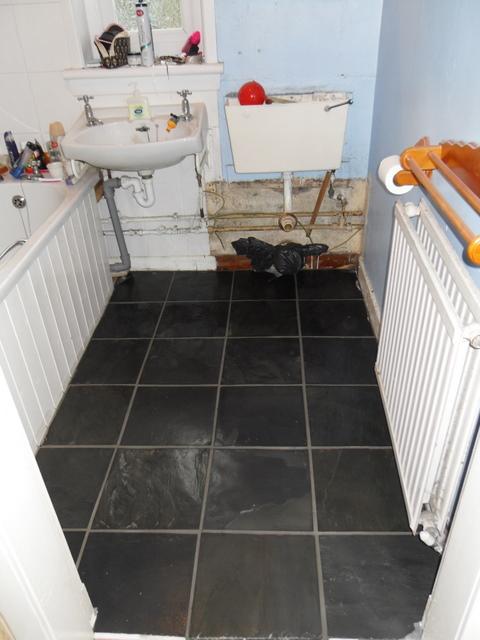

Hi - we are renovating a very tired small bathroom in our flat. It has a rather old toilet and basin that we are replacing with a close coupled toilet and basin and pedestal. There are small pipes behind the toilet and sink (which were previously boxed in) and there is a larger pipe coming from the bottom of the sink and going in behind the bath (obviously a drainage pipe??) Ultimately, I'd like to put beaded "tongue & groove" panels up to wainscot height along the one plain wall in the bathroom and carry it behind the toilet and sink. Can anyone suggest a tidy and fairly uncomplicated way to do this? Could I build a shallow frame for behind the toilet and sink to house cover the pipes successfully? Also, can anyone suggest where I might be able to find (reasonably priced!) MDF beaded panels? I've seen at B&Q and Homebase, but are very expensive. I've tried asking Jewson's but they didn't seem to understand what I was after. I must admit this is the first time I've renovated a bathroom before, so I want to make sure I get it right first time if I can!! Any suggestions would be greatly appreciated.

Pity you did not drop all the pipework to the floor or better still under it before tiling the floor. But If the new sink is to have a pedestal then move the waste and shoot it straight out through the wall directly under the sink and connect externally, the sink pipework should then tee'd off directly behind the pedestal just leaving the two pipes to box in which will only need a very narrow boxing, or lower them so you can just have a boxed skirting.
