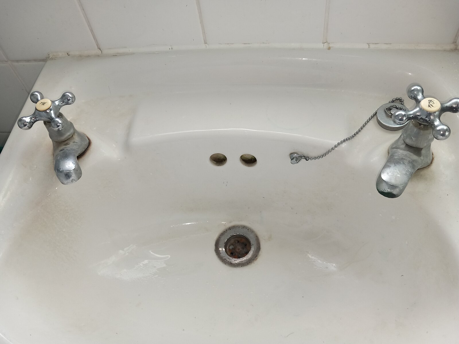

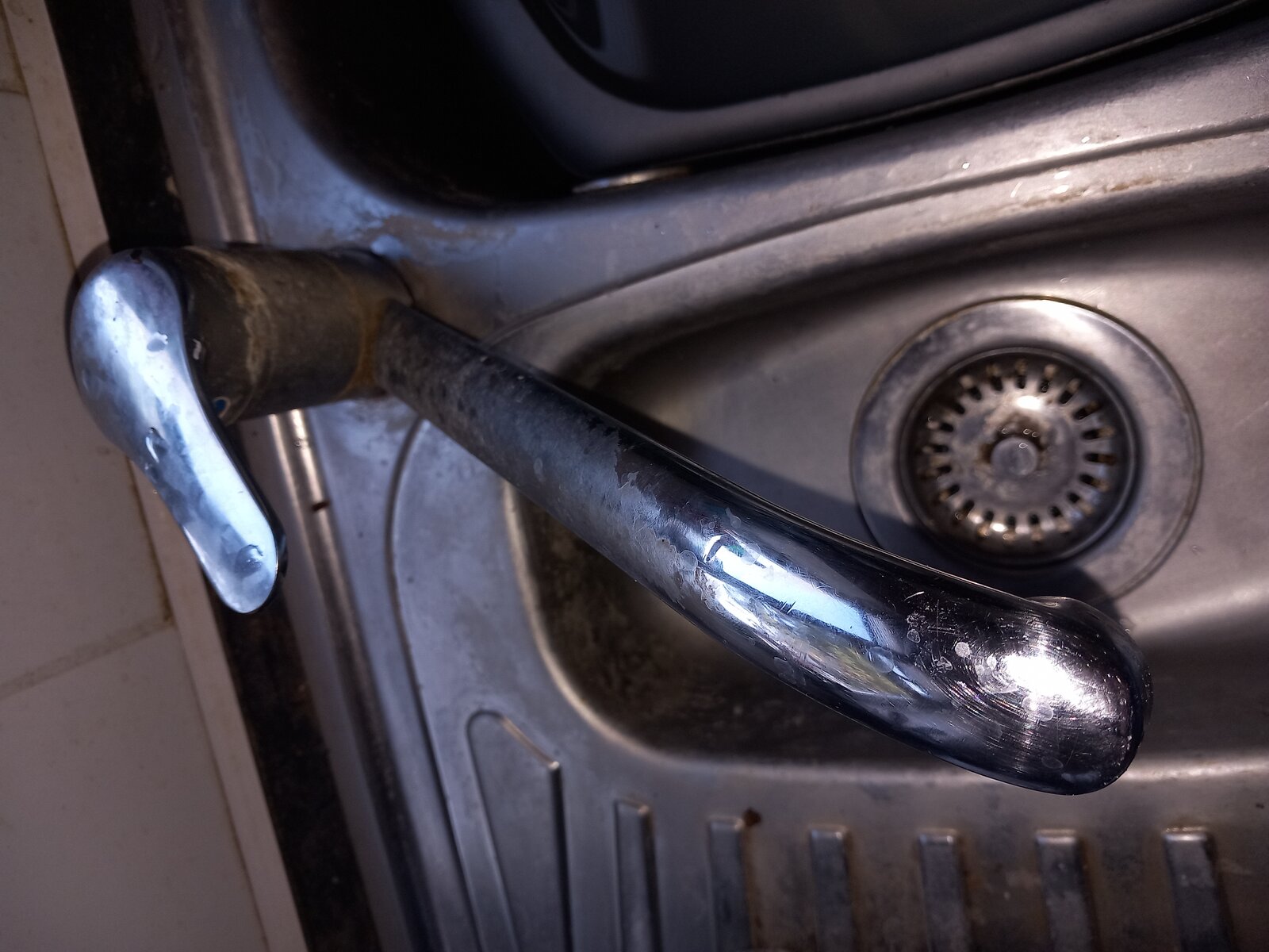

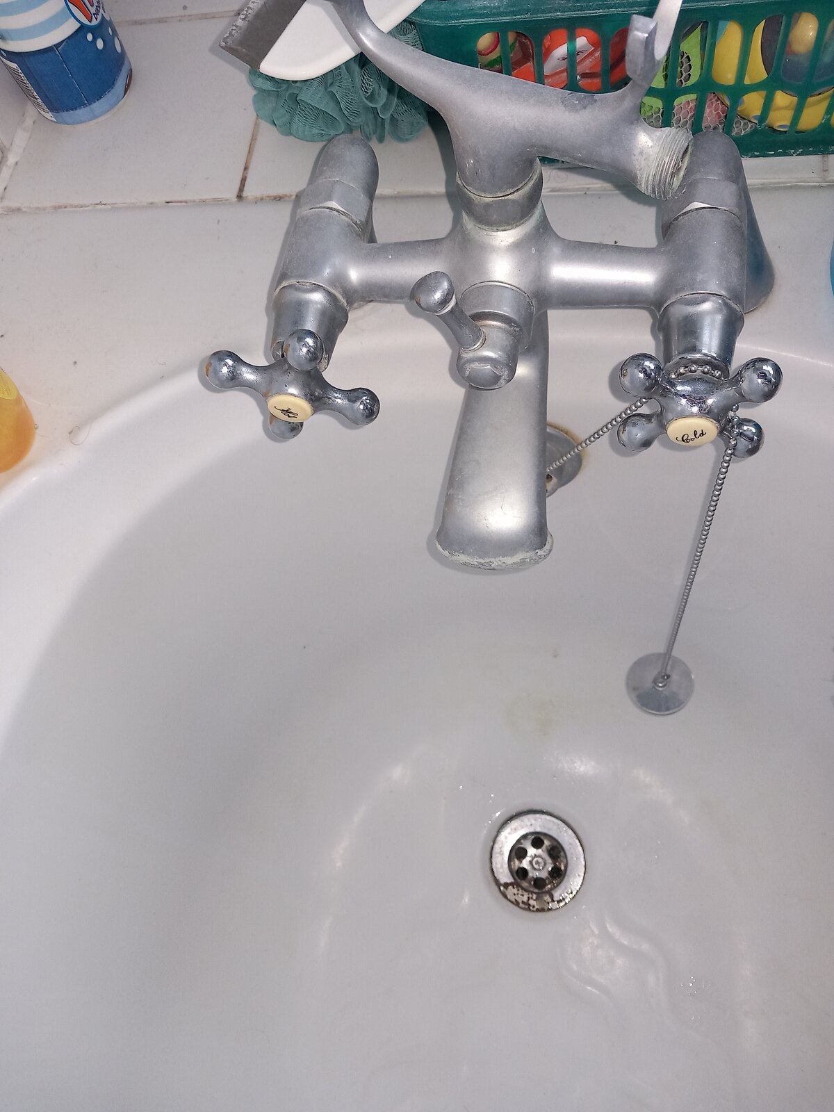

Is it easy enough to change my kitchen, bathroom sink's and baths taps? How do I do it? Tools- grips and spanner?
I would say you will need a proper box spanner for back nuts on bath and basin looking at state off them.
I would use a bahco type adjustable on connection nuts but if tight some sort of tap spanner may be required.
See you have a basin waste as well they can be very 'interesting ' to do without removing basin and pedestal.

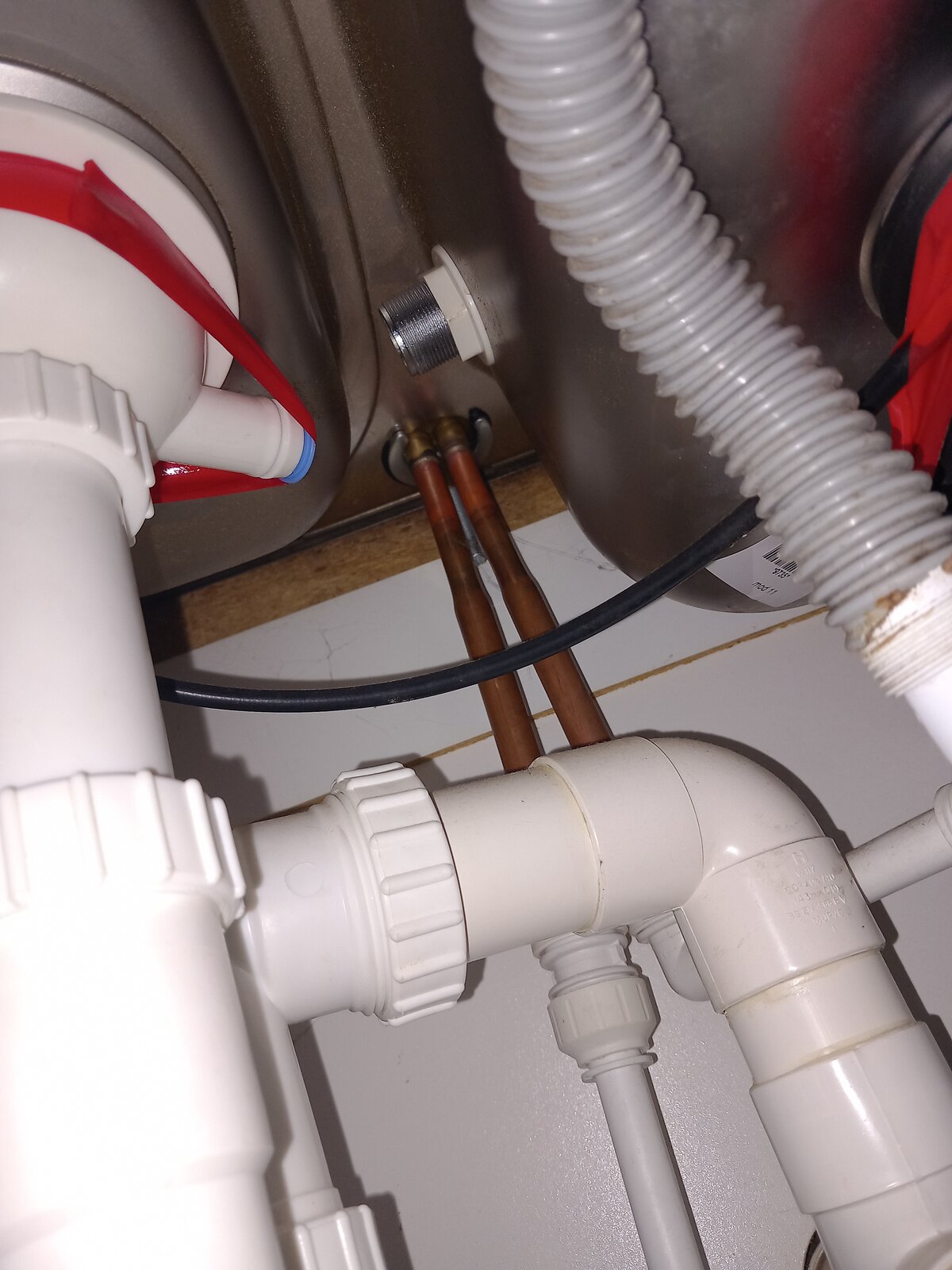

Sink tap just needs correct size box spanner to remove.
Get someone to hold basin & bath taps as you remove them
very easy to spin round and cause damage.
The best advice, if you really want to try and tackle this yourself would be to go onto youtube and find the relative vids, you should be able to find them all there. To explain all the possible ins and outs, pitfalls etc that you may come across whilst doing all of this would be a pretty large amount of typing.
The key things are -
Water off
Tools - adjustable spanners - monobolc tap box spanners - standard tap backnut box spanner - large pump pliers/grips
Materials - 1/2" + 3/4" fibre washers for the basin and bath tap connectors - silicone and basin mate

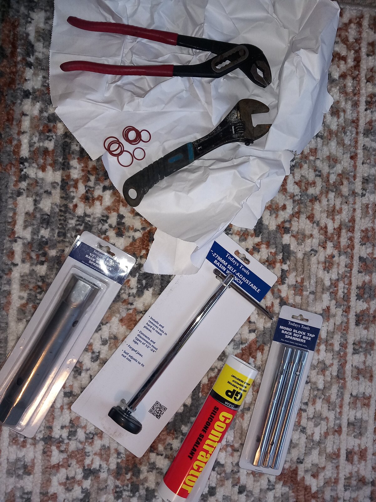

Are these all the tools and bits I need? I had grips and normal adjustable spanner already. £36
Yup, that should do you.

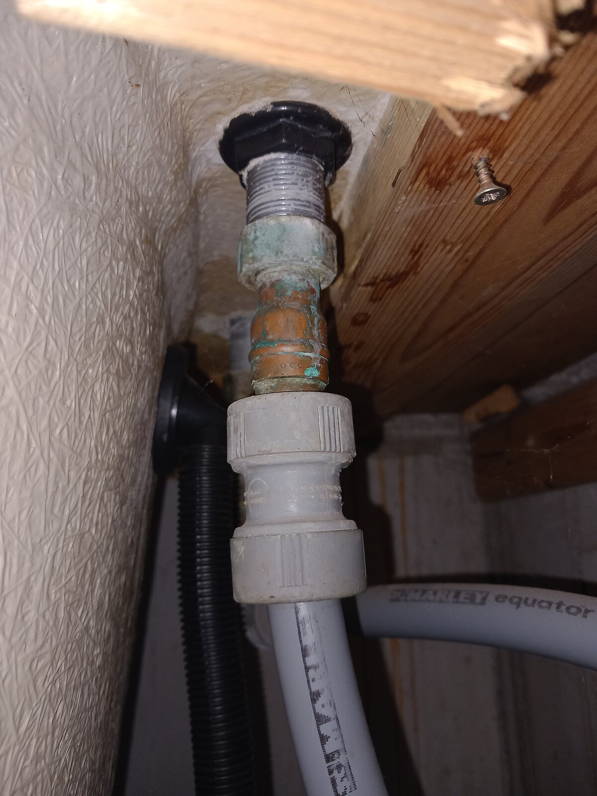

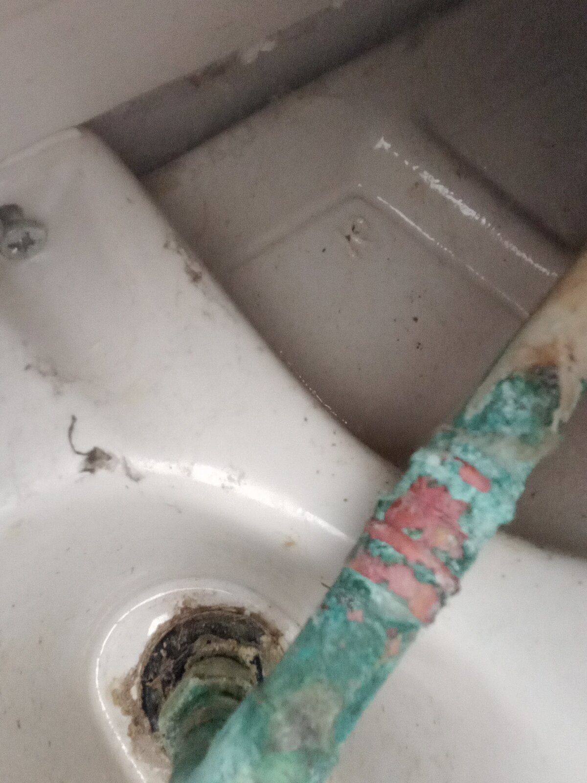

When redoing the basin taps, the nut on the tap connector at the end of the copper pipe will need to be pulled down fully, you may find the old fibre washer is holding it and it's hard to , it will eventually eventually pull down off on the end of the tap connector. That lets you get to the old washer and remove all the bits before fitting the new one.
Same with the bath tap connectors too.

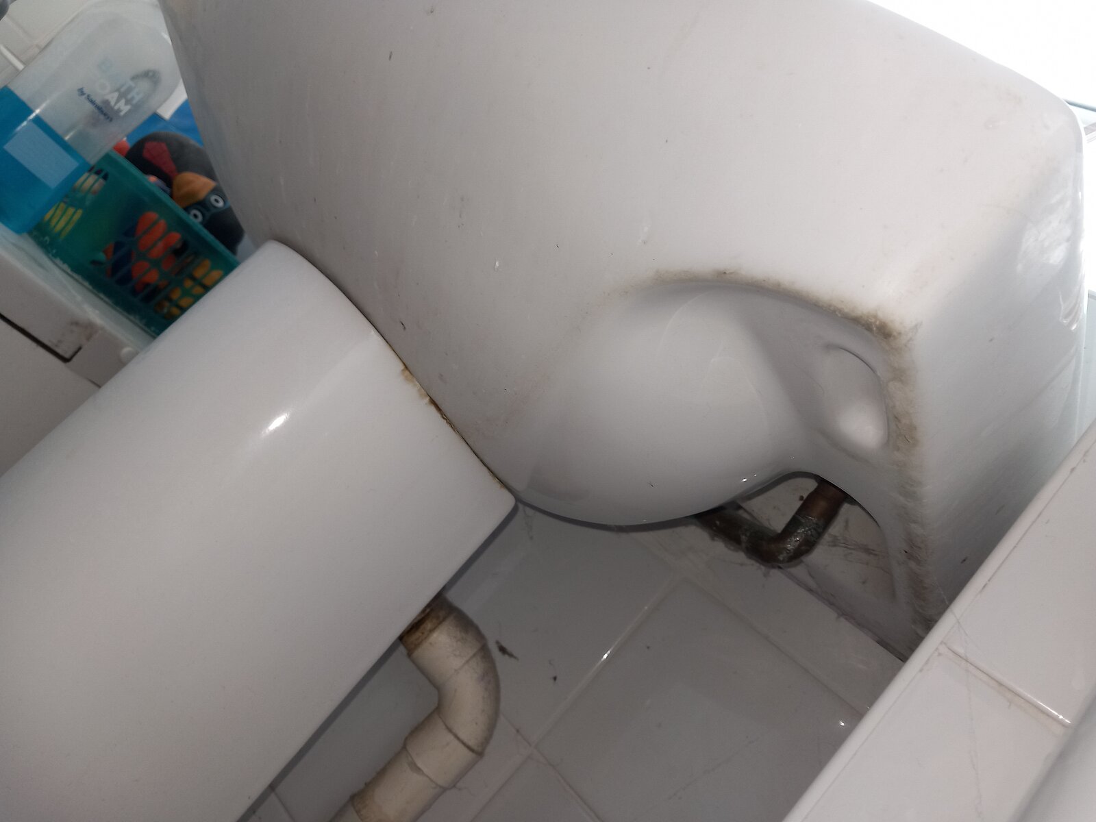

So, would you recommend removing the pedestal? If so, is it a case of two people? One holding the basin?

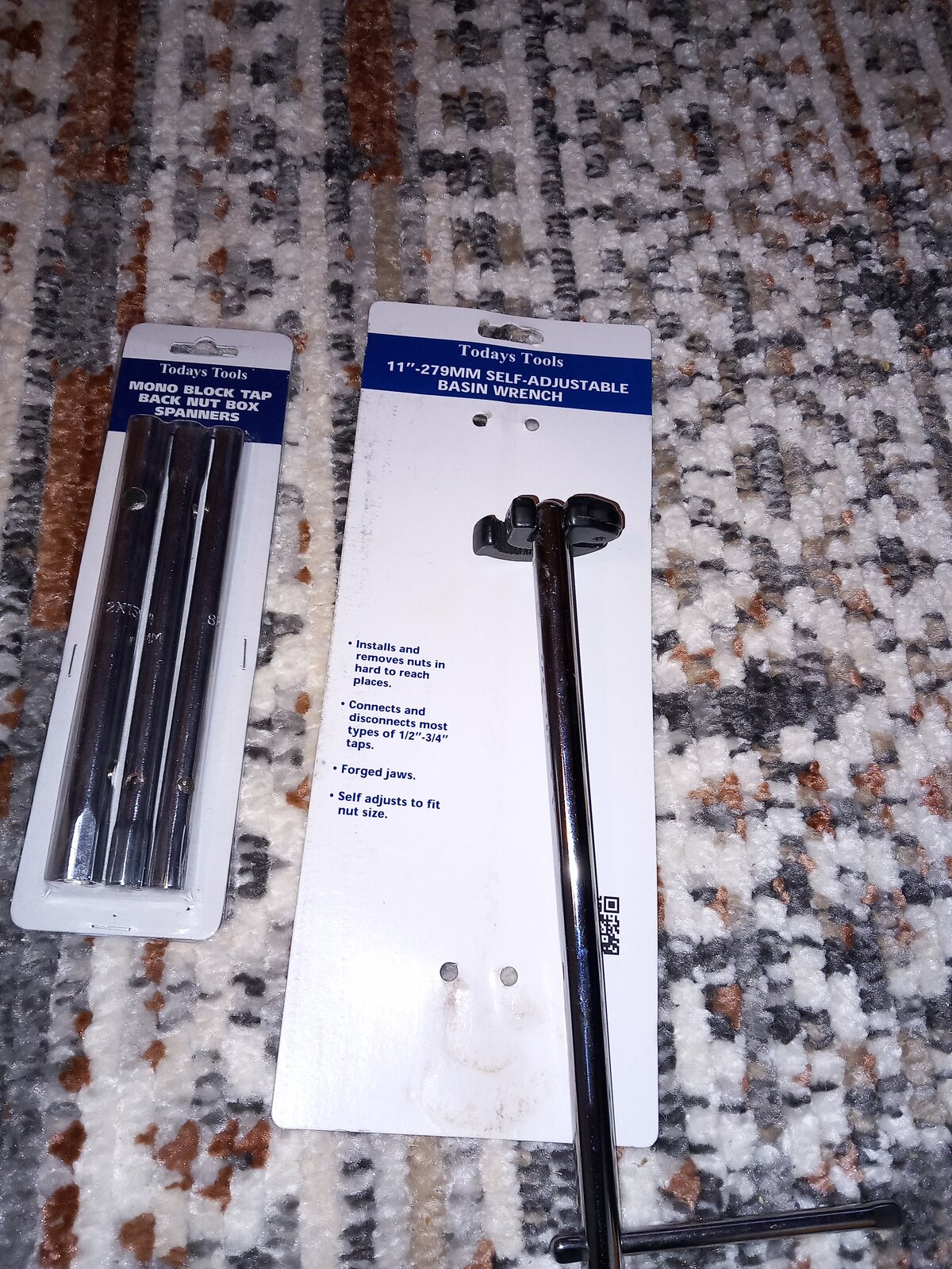

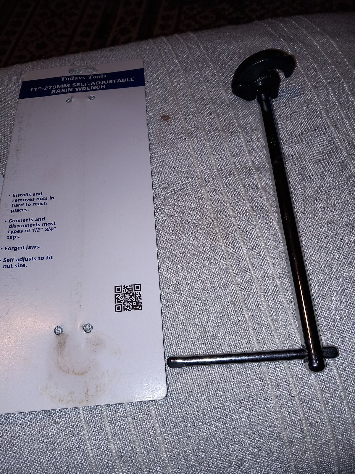

Is this adjustable wrench what use to do up and undo the tap's nuts? How does it lock tightly onto the nuts?

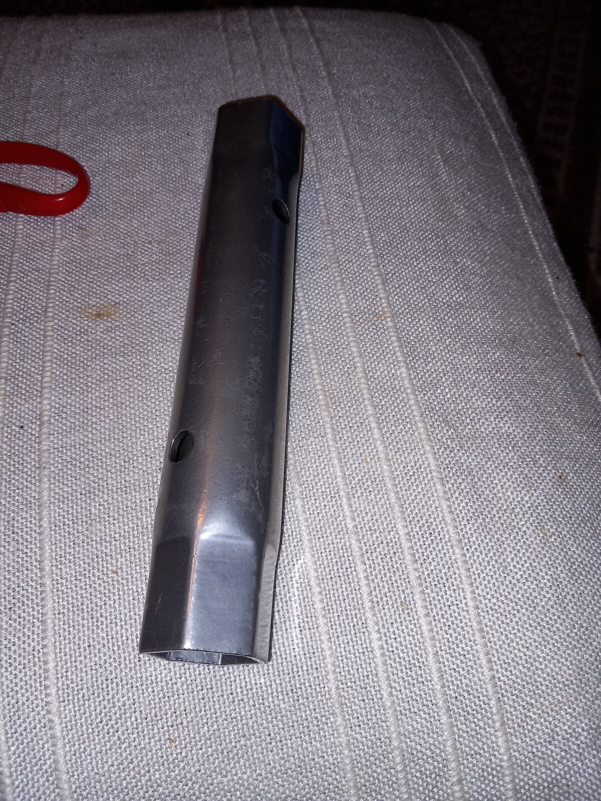

What are these used for?
If your having to ask its probably best to get a plumber ;)
Just spotted the username, another wind up!
Use the adjustable spanner at an angle to undo the basin tap connectors off of the bottom of the taps, those basin wrenches are a nightmare to use properly. The large box spanner, smaller end undos the tap back nut the larger end does the bath tap nut.
The 3 box spanner do the sink tap nut.

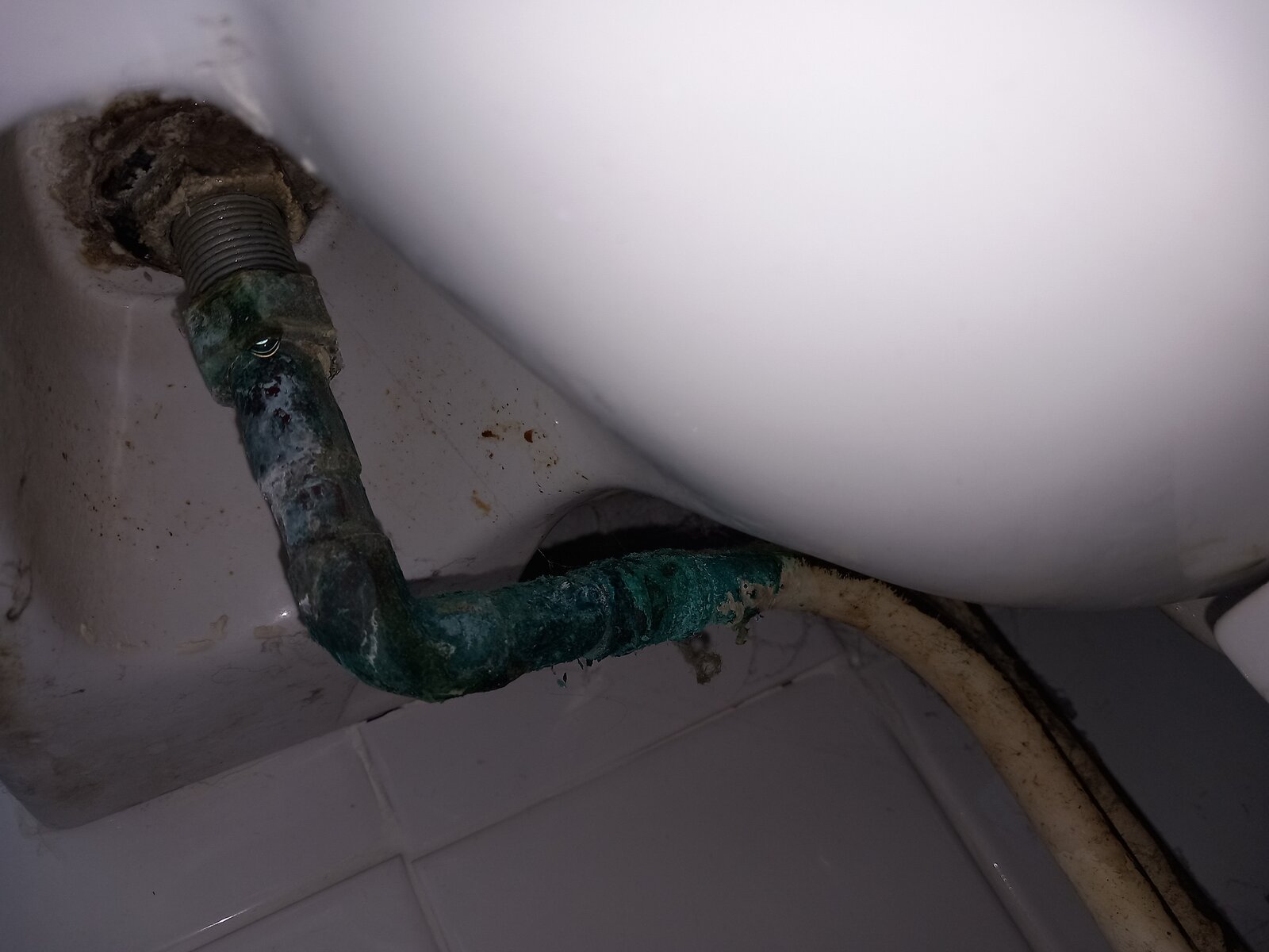

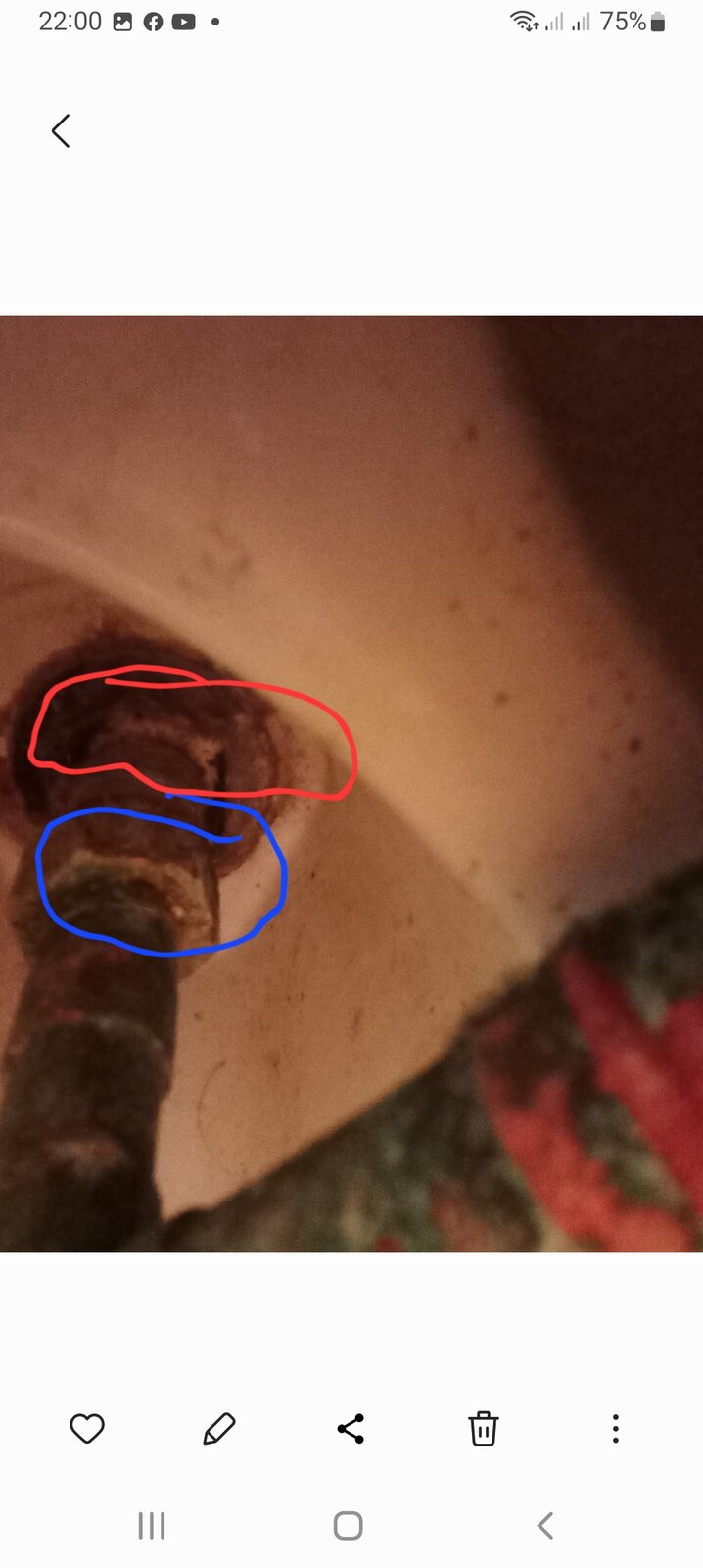

So, do I undo with normal adjustable spanner (nut circled in blue) then push the box spanner (in photo) onto nut (circled red) and undo that, inserting screw driver into box spanners holes?

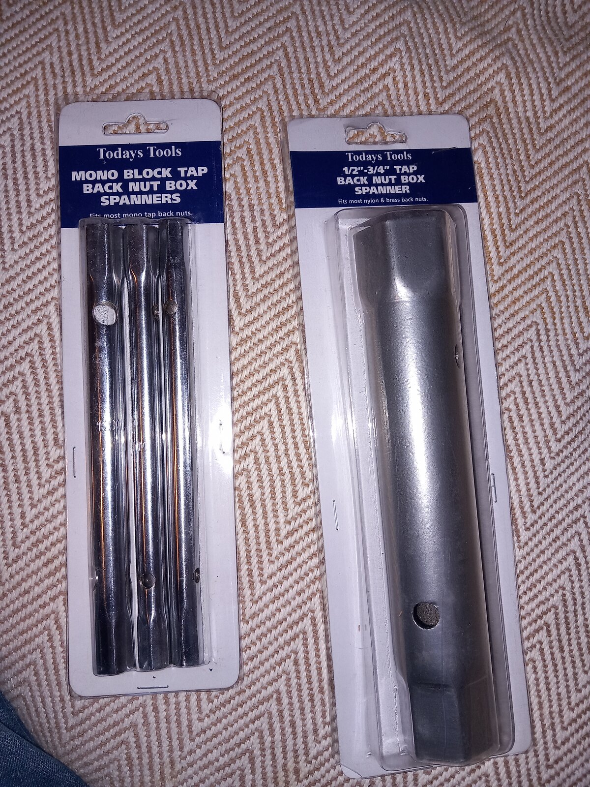

Are these tools needed below or shall I take them back?
Yes, normally you wouldn't need to use a screwdriver in the box spanner as the nut will undo by gripping the box spanner tightly, you will probably have to hold the tap whilst undoing.
It is fiddly to get the adjustable spanner onto the lower nut and grip it properly at an angle but with a bit of fiddling you can do it. If all else fails then try the tap spanner but they are fiddly to use properly and get a proper grip if the nut is tight.
Shall I return these tools? Do I need them?
What's a tap spanner?
Have a suitable length of timber to hand to prop and take the weight of the basin, then you can slide the pedestal out on your own. Just the timber prop in the way, makes for easy access to the taps and drain.
