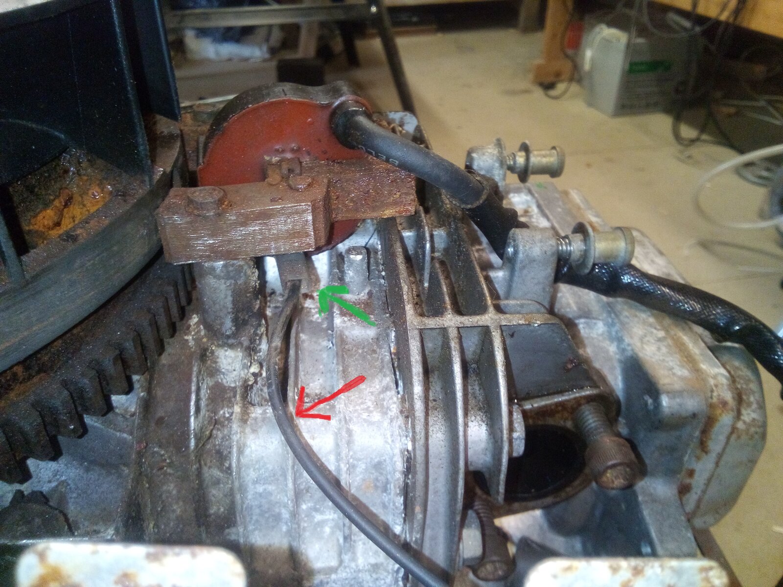

Hi as per heading I would like to know where this wire on my Briggs and Stratton engine goes. I am attaching a photo of the engine and the wire in question( pointed with red arrow) The green arrow shows where it is connected to the ignition coil using a female/male connector. I think it is the wire that takes charge the from the coil to the battery and have been given the impression from a very good video I watched that it goes to the I (ignition) connector on the key ignition switch that I have. Can someone please confirm this . Thanks in advance James
PS At the moment the other end from the attached one to the coil is not connected to anything at the moment
If the wire connects directly into the coil, its a cut out wire......the engine will produce a spark when turned, but the spark will cease when the wire is grounded to the machine metalwork.
John :)

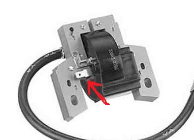

Hi John, Thanks for your response. The wire connects to a metal male "prong" using a female connector as shown with red arrow in photo of another similar coil here.
I was given the impression that the other end is connected to the I on the key switch. If correct does that mean that this I connector creates an earth connection when the key is turned to off position and hence the engine stops? Would it be also possible to put a cut off button halfway on this wire at some stage so that even when the key was in on position the button would create a connection and cause the engine to stop in an emergency? ( Hope that makes sense)

You are correct concerning the operation of the ignition switch.....have you checked out the wiring diagram from your earlier post? Obviously the wire colour is important.
Anyway, these engines have a flywheel magneto and only need a battery to spin them over to start up.
