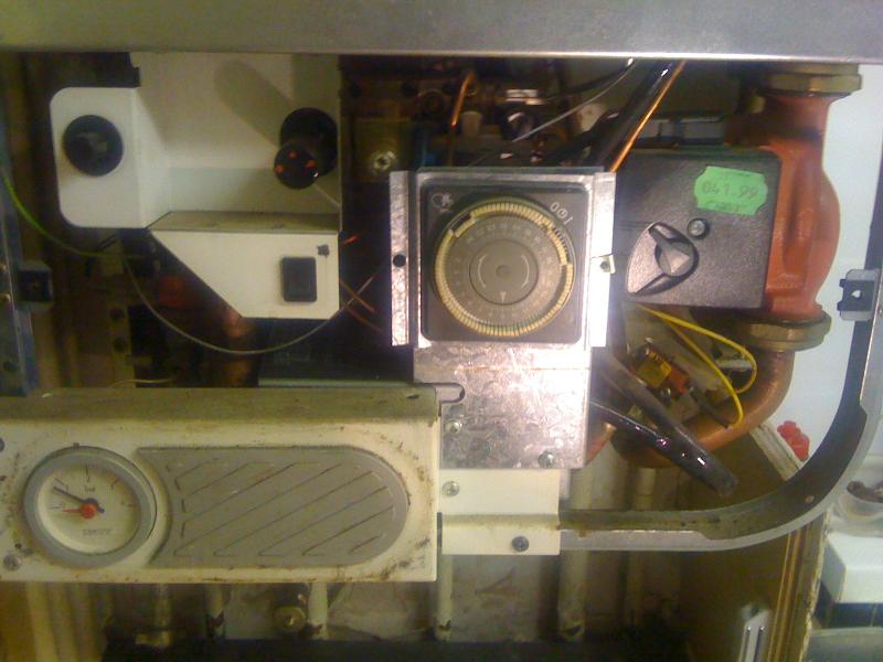

bleeding the pump could be a problem as the pump facing wrong way. i cannot access the screw that i need to turn to bleed it.
attached a photo of the boiler.
any other way around it would be appreciated.

Whitespirit quite correct - I'm not expert on your boiler. First question though will you be attempting soldering or are you a compression man and do you have isolation under the boiler on the flow and return pipes?
it does have isolation valve under the boiler on the flow and return pipes. why do you ask?
i was thinking of commpression fitting as soldering on a wet pipe does not bond as told by many post.
what do you recommend?
i have attahed a photo of the isolation valve i think under the valve.

Problems with Diynot apparently so I could not reply. Soughted out now. Looking at the photos I cannot see any isolation valves, where the pipe join the boiler. They just look like straight compression couplings. Due to age, even if they can be isolated, turning them off, could make them weep incurring more cost, so best leave alone.
I suggest keeping with your origional list for safety sake. Don't forget to add a inhibitor to the system when you refill it. If you do drain down the system via the drain off below the rad, it would be a good idea to replace the washer, before you start refilling.
