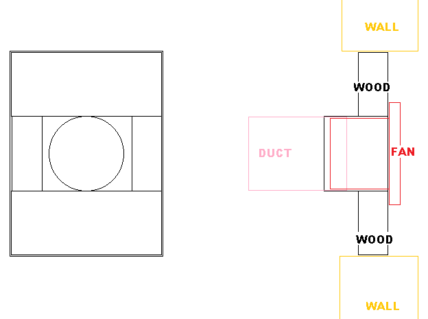

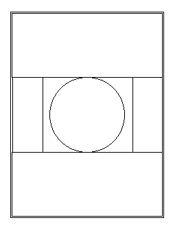

The similar thing i had was a big rectangular box about 12x9" with a 110mm spigot. it had been push fitted to the air duct which finished some 70mm inside the brick wall which meant the box was substantially in the wall then filled round with plaster.
When removed I had a 12" [300mm] high by 9" [225mm] wide hole in the brickwork. When the replacement fan was fitted to the duct the whole of the fan was at best 25mm within the line of the wall, I used 4 pieces of 94x44mm timber [4x2" PAR]
and glued them 44mm into the hole with gripfill using a piece of timber as a depth gauge to get them all flat and even. Once painted to match the room the fan sat in a fairly smart recess in the wall.
Which ever way it's done there will be an outline of somesort unless some decent plastering is done.
So what I'm saying is I agree with Tigercubrider for minimal impact.
Thanks for your input Rocky. The fan aperture is 19x19cm though the fan, which sits well within the aperture, is smaller.
Thanks for the detailed drawings Sunray, I think what I will do is, as you and Tigercubrider suggest, line the aperture with 2x1 or inch battening but also use a bright white chopping board, cut to size with a round hole (to seat the new fan in) to cover the aperture fully.
