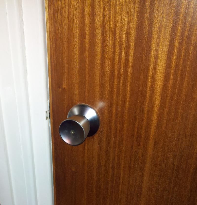

Hello all,
I attempted to remove the TESA privacy door knob today. removed the cover plate, but couldn't make any progress, i just applied sheer force using my screw drive, yes, i think, i am stupid in doing so.
The links in the web and you tube, seems not to be applicable for this, as i donot find any external slot /grooves to pop up things or turn screws etc
I am thinking of using a hacksaw to cut the lock. am I thinking right?
What else i can do?
Do i need to call a locksmith for this job? or which tradesman should i be looking to call, if i decide to seek professional help.
I managed to do it myself.
The is a small dull coloured spot on the inside of the knob. This got camouflaged, so i miessed in the fist shot.
but pressing that released the knob.
Hope this helps some one.
