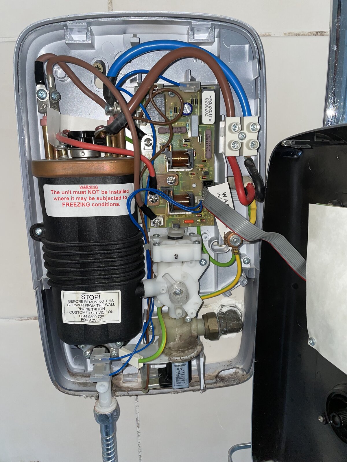

need to replace Triton Opal 1 electric shower, need same spec for fitting, any recommendations?

need to replace Triton Opal 1 electric shower, need same spec for fitting, any recommendations? Happy to try a different brand. Got photo of current shower for reference if needed.

Triton easi fit Are a good retro fit for most instantaneous electric showers.
A pic of the inside of your shower would be helpful.
Hi, thanks for your reply. Here is a pic of the shower.

What kilowatt rating is it 8.5 ?
The cables neutral appears to have damaged insulation ?
Triton easi fit models water inlet will accept bottom right connection ,as yours is ,and the wiring can connect right hand side too. So on face value would appear to be a suitable replacement. Is your opal 1 no longer produced , obviously that would be your first choice ?
