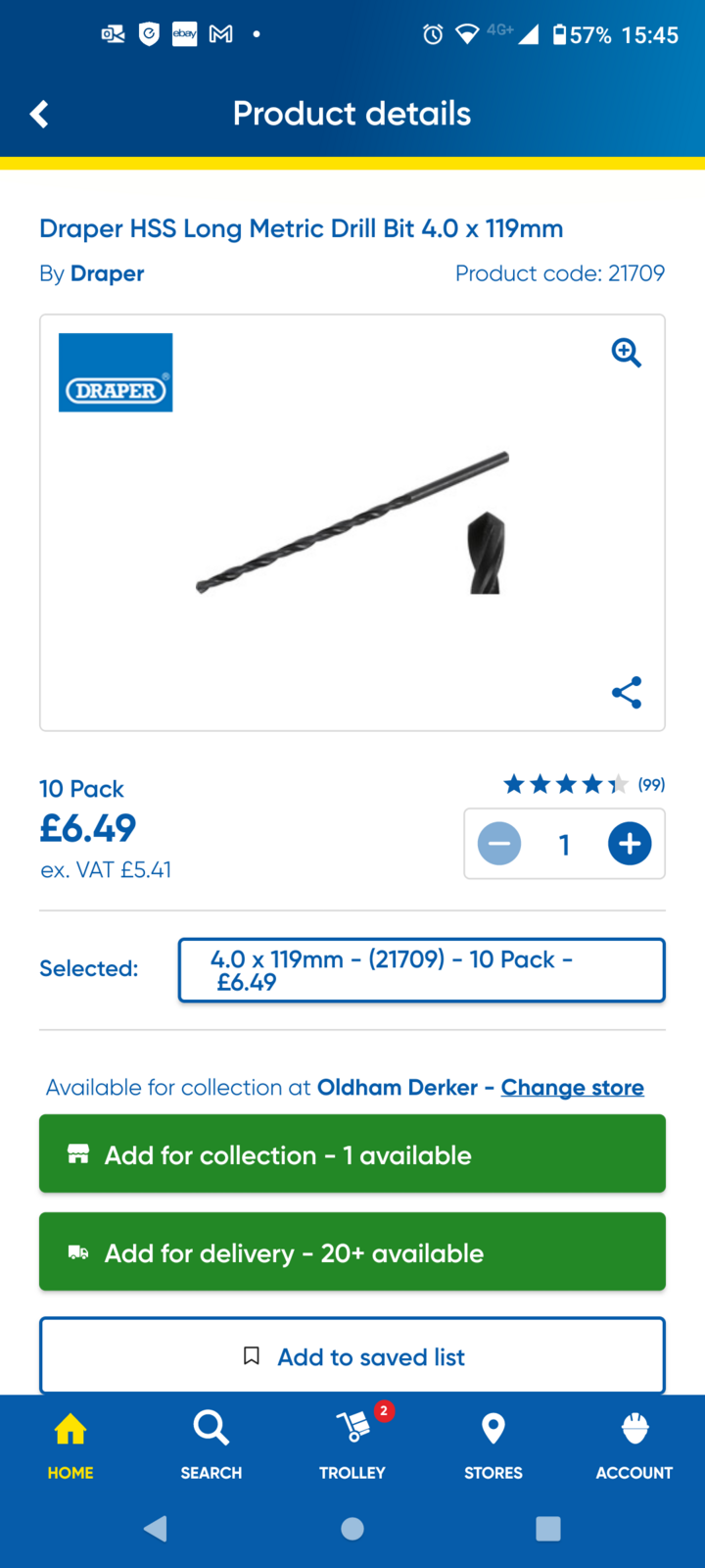

basically, I need to join some wood together for my outdoor work area that is being built at the moment. I have sistered two posts together, glued and screwed, as this is the door opening area, it will take the weight of me, + workbench and at least a table saw and mitre saws. This is just shy of 90mm, and the screw will go in face grain, and it will be going into end grain. The size screws I have for this section is 120mm, which should give it plenty of strength, but I don’t have or can’t find a bit that is needed for the size of the wood to drill a pilot hole. I need a 4 ø 120mm long bit. I can’t go higher in ø size due to the small wooden strip, and I need this to connect to the frame of the work area.
i asked the guy in Screwfix and B&Q who suggested I cut the sistered posts into 3, drill and align with the next bit, do the same until I have a deep enough hole… another guy in screw fix said, drill with a bigger ø bit that is long enough then pack the hole with tooth picks then screw…
oh, I can’t screw at an angle as there needs to be a metal plate there.
This:
Helllo, it’s not that I didn’t google, my wording makes bad results. My hole needs to be 4 ø and 120mm deep. The drill bit is that long yes, but it won’t drill that deep… it doesn’t say on this site, but amazon do for other drill bits and by Bosch blue multi mater bits they call it work length, and their size 8 ø x 120mm bit, the work length is 80mm.
I have put the drill bit into the drill fully ”seated” i then drill as deep as I can, then undo the drill chuck and slide the drill bit out 15ish mm, then drill again, I repeat this until I have either gone through deep enough or it’s no longer safe for the drill/drilling application.

200mm x 4mm here: https://www.ebay.co.uk/itm/304642996443
