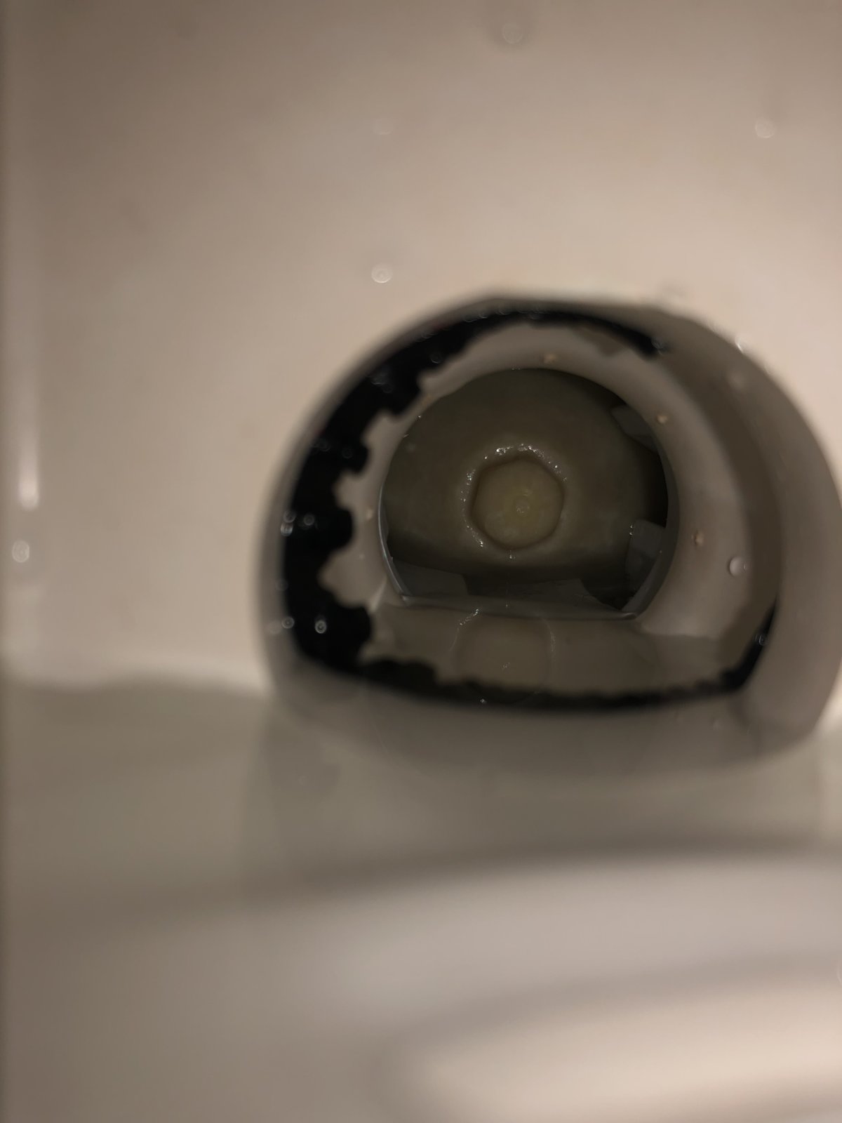

Upon closer inspection I noticed that the water is tricking in from a hole inside the machine near where I assume the water hose is connected. It seems to have washer which doesn't look in particularly good shape - could this be the cause? I've attached an image if it helps.
Is this most likely to be the problem? How easy is it to disconnect it all to replace this washer if so?

Pull it out, takes the sides off and inspect what happens to the filling loop and tanks. The inlet valve on these things can get gunged up with fat over the ears and the mechanism may get stuck....so it is telling the dishwasher to fill when it is already full.
Common cause is syphoning from the sink connection , the hose MUST have a high point higher than where it discharges into the waste .
