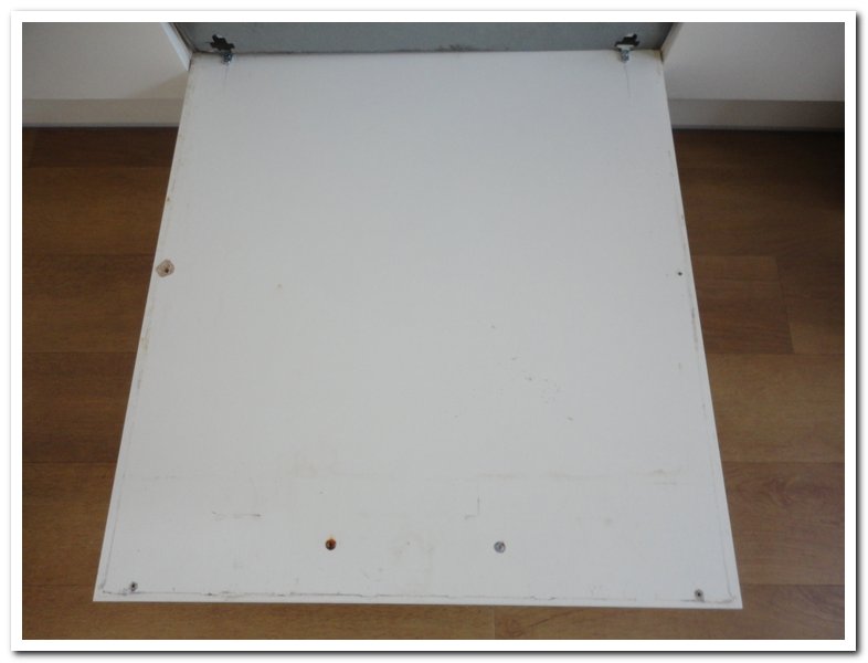

Having read previous threads (about other makes) I hoped that I could unscrew the (MDF) panel, fill the damaged screw holes (Araldite was suggested) and re-fit the panel.

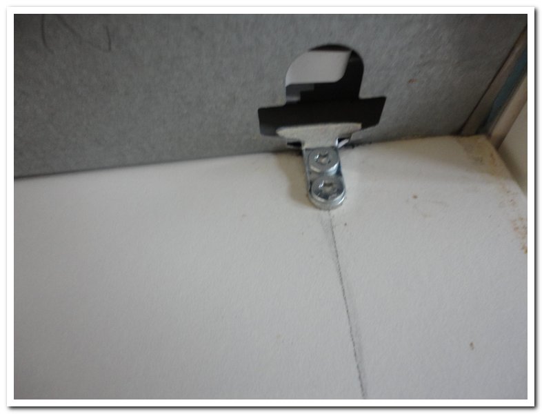

I have now taken the panel off, and see that, as well as screws at midpoint and top, the panel is held at the bottom by hinges which clip into the metal sheet; the sheet is broken at the LHS clip
and deformed at the RHS.
The full panel looks like this:

If you remove the two bottom short screws and carefully drill through the metal panel you can swap the previous middle long screws into new material of outer the door panel.
Thanks to both jj4091 and assuhors for your replies. I'd looked at a few spare parts sites but hadn't seen one with a metal panel. I haven't fully removed the decor panel yet but hope that undoing the two screws in each hinge will be a reversible operation. Drilling new holes into fresh MDF seems a better idea than filling the existing hole; removing the metal panel will let me see that there isn't anything vital hidden away where I need to drill.
