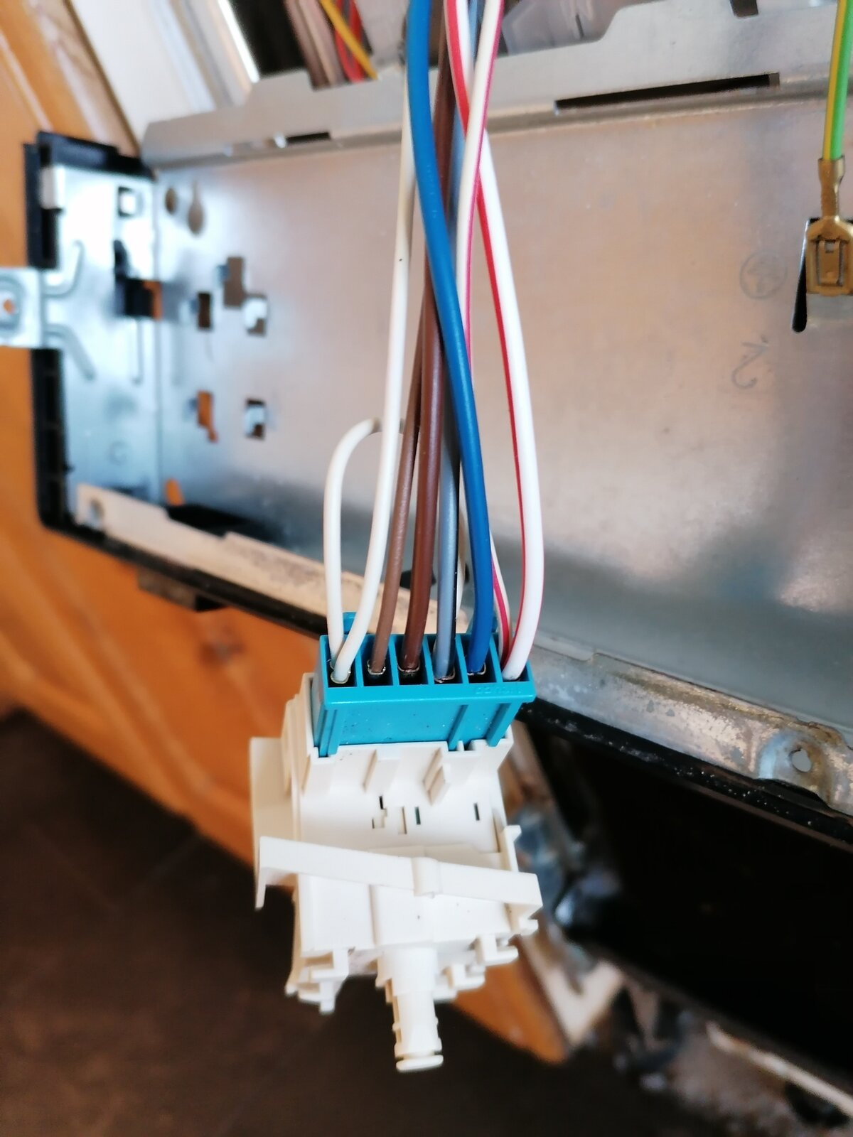

Neff dishwasher panel has no lights, I tested the power and it's getting to the on/off switch.
I'm not 100% how to test the switch as there are 6 terminals but I do know the following.
Thick brown is live
Thick blue neutral both reading 240volt
Grey/black striped & white cables go live when I turn the switch on
Thinner brown & red/white striped remain dead. (grey/white goes to control module)
The door close switch has 2 brown & 1 red/white striped (red/white goes to on/off switch)
All 3 remain dead.
Does it sound like the door switch is OK could my problem be the control module?
The machine is old, I'm guessing around 13 years?
Maybe a new one is the best option.?
