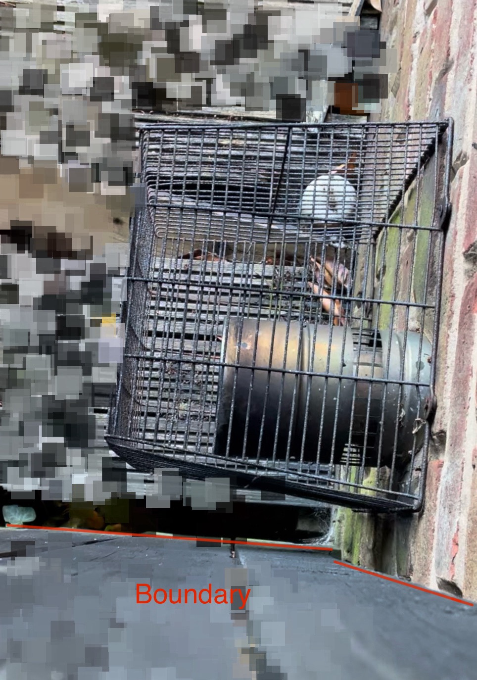

Any chance of posting a photo of this flue?
An expert here may be able to advise if a flue diverter is suitable.
Here is a photo taken from above. I’ve pixelated out some features.
You can see all the green algae around the wall - sign of a lot of CO2?
It’s also very noisy and roars like a jet engine (I know all oil boilers are and I cope with the noise of it didn’t smell so much).
It’s particularly nasty this morning Can’t even sit out in my garden.

If heat exchanger gone it would more than likely be leaking flue would look like granny's washing day when running.
That flue looks to have some heat discolouring so very incorrect set up or baffles gone.
It really matters little what cause is you need your neighbour to cure.
Or you take it up with environmental health department at your council.
