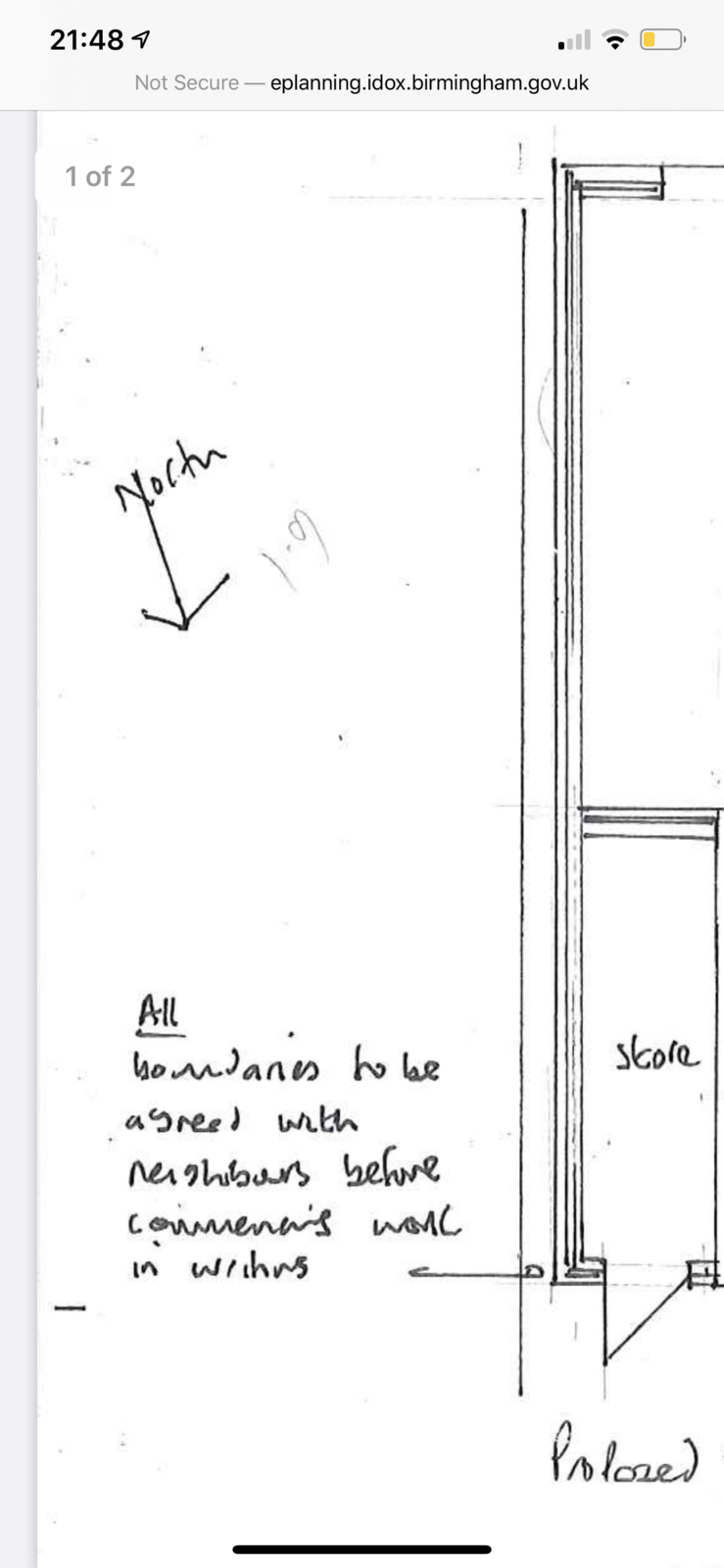

What makes your friend think or are of the understanding access will be required to their property to construct the foundations?
The drawing attached says so..
To me, that just means confirmation of who owns what boundary is required before work commences!?! If it didn’t mean that, the wording does still state ‘in writing’ so that is what your friend should be waiting for... in writing so some kind of formal agreement.

It appears the Planning applications part of the website is down atm so can’t remember which one is no. 106... to the north or south? If it’s to the north, then the plan does show a gap between the existing wall and the new side wall. Foundations don’t have to be centralised under new walls so they may look to adopt that approach if excavations would be too close to the boundary. They should also be considering their duties under the PWA (as mentioned above).
In relation to the scales, the LPA were happy with what had been submitted hence why they validated and then determined the application. What actual dimensions go on any Building Regulation/working drawings is anybody’s guess. If your friends had concerns the extensions were not being built in accordance with the approved drawings, then they can get in contact with Planning.
Edit: The website is back up now and your friend is to the south. Similarly to above, they could probably design an eccentrically loaded foundation along that new side wall. Or if there is a gap of at least 150mm to the boundary, a traditional 600mm wide foundation would ‘fit’.

It looks like the aim is to stay within the boundary. The confirmation of the boundary is a basic requirement to stay within it, not a planning issue etc. It would be a civil action/imjunction you'd need to take.
You can definitely refuse access to construct new stuff, and it would be a trespass if they built across on your side. They can get access to maintain but not improve their property though. And they can get access for work on party structures, of which presumably there are none at present.
Worth bearing in mind, if they build the whole thing from the other side the finish might not be acceptable to you.
Your friend won't own the boundary as it's an imaginary line, they may own the boundary feature, which means it's likely the boundary is the neighbour's face of the boundary feature, meaning if they build it only just touching and no overhang, then it's entirely within their property.
