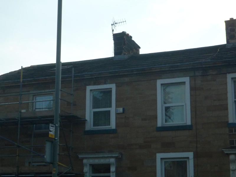

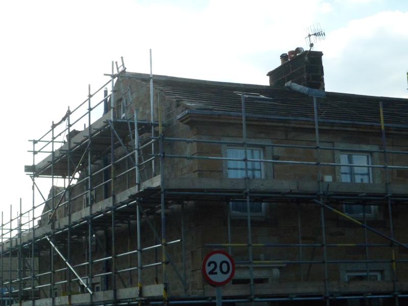

Hi,
I've since read the letter and it transpires:
- Sounds like the chimney stack is the one at the front of their house (which is not shared - still party wall?).
- A roofer has looked at it, and said it needs rebuilding.
- Scaffolding to be placed on my roof.
- If this isn't done, the chimney could collapse.
- If I deny access and the chimney stack falls, they will not take responsibility.
I've attached a couple of pictures taken from either side of their stack:
As far as I can see from a non-builder point of view it looks to be in great shape (better than my own). Thoughts?
Its not clear from the pics where their house ends and your's begins - perhaps post full front and rear elevation pics?
Pics of any scaff on your kitchen or main roof would help.
The pics also appear to be slightly dated?
Do you have any chimney breasts or fire openings (even blocked up or vented openings) on that party wall?
If their chimney breasts or stack is on the party wall, even if its non-shared they must seek agreement with you before commencing any work. Nothing can be done on a party wall, so to speak, without the other parties permission.
I don't see the problem, they are maintaining the stack which is in your interest too as it might well end up falling through your bedroom ceiling.
It is accepted that a householder can ask for access to your property to carry out maintenance at a reasonable time.
As long as they take responsibility for any damage to your roof why worry?
Hi,
The stack is at the very edge of my property on the left hand side in the pictures, my property is on the right in the pictures.
The boundary is where those scaffolding boards abut i.e. an imaginary line at the left hand edge of the window and door upwards.
The stack isn't shared and there is no evidence of it ever having been, it's the one at the back that is shared, but I don't think they are going to do anything with that one.
Is there no potential structural risk? I'm not even sure what they are going to do exactly, so I'll ask for details.
