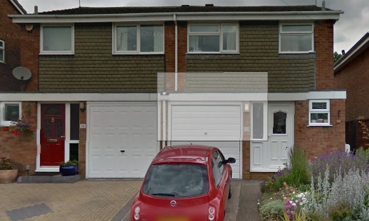

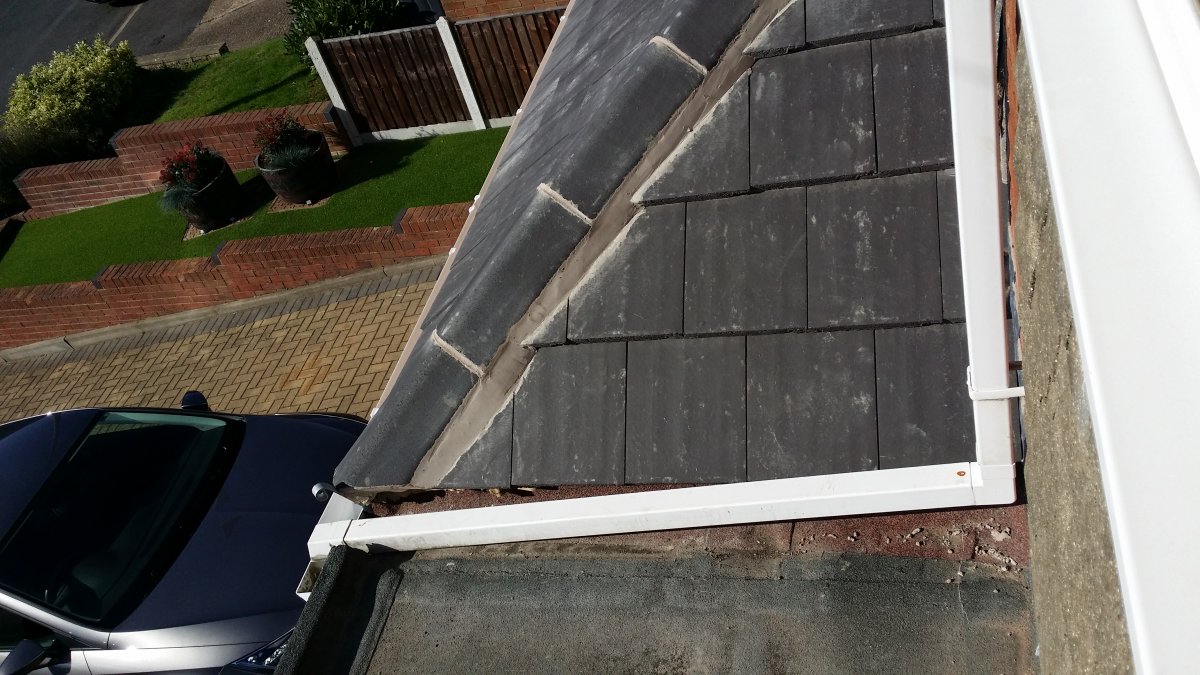

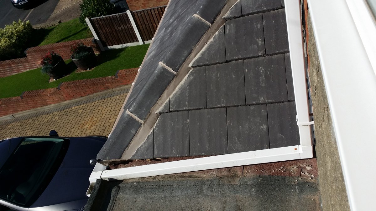

Thank you for the replies. I didn't receive any notices but my neighbour told me it was going ahead and how much it would be to have the two roofs done. It's hard to get a better photo from the front as the house is on quite a steep drive and the street is lower down but attached is one from the front upper window.
Thank you for the replies. I didn't receive any notices but my neighbour told me it was going ahead and how much it would be to have the two roofs done. It's hard to get a better photo from the front as the house is on quite a steep drive and the street is lower down but attached is one from the front upper window and one from Google maps pre roof.

hopefully a roofer will comment on how it should have been done. Are there any other houses in the road like this? Any idea what this cost to build? It definitely needed a gutter at the very least.
What is the orange stuff? is that felt? have they just built this on top of the old roof?
Well a simple solution would have been to run a short length of gutter and letting it drain into the hopper instead of that length of rain water pipe, and then the shared down pipe could drain into the short length of guttering that in turn drains into the hopper.
It looks like there's a bit of an upstand so seems a shame he didn't use a bit more nous to achieve a better solution.

but look on the map pic and it's the brickwork ! so there is in effect a small upstand of the party wall between the garages.

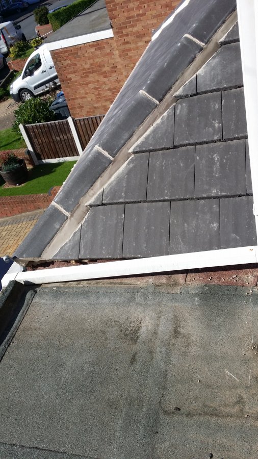

Thank you for your replies. Yes the orange is extra felt he put on top of mine to create the join between the two roofs. It cost about £2000 for the neighbour's roof. Would have been about £1800 each if we both had it done.

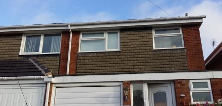

I've taken another photo from the road which might make it a bit clearer.
I can see why you didn't waste £2k - its pointless - is the boundary at the edge of the tiles or the horizontal drain pipe?
Does your neighbour like it? - its got to be chopped back and as a minimum a gutter added, but really he should have sealed and flashed it to stop water running under it. I suspect the water gets under the roof as easily as its pooling on yours. In which case their roof will also get damaged.
