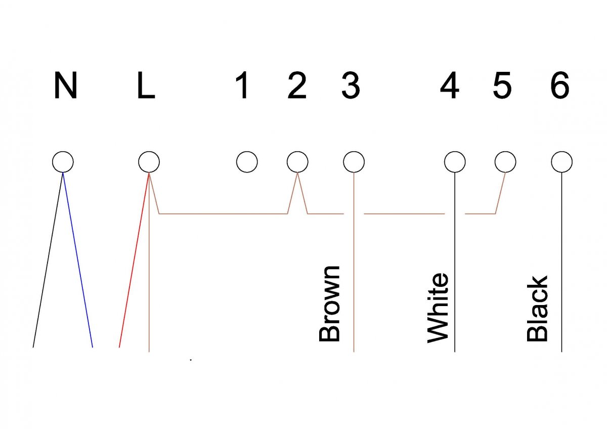

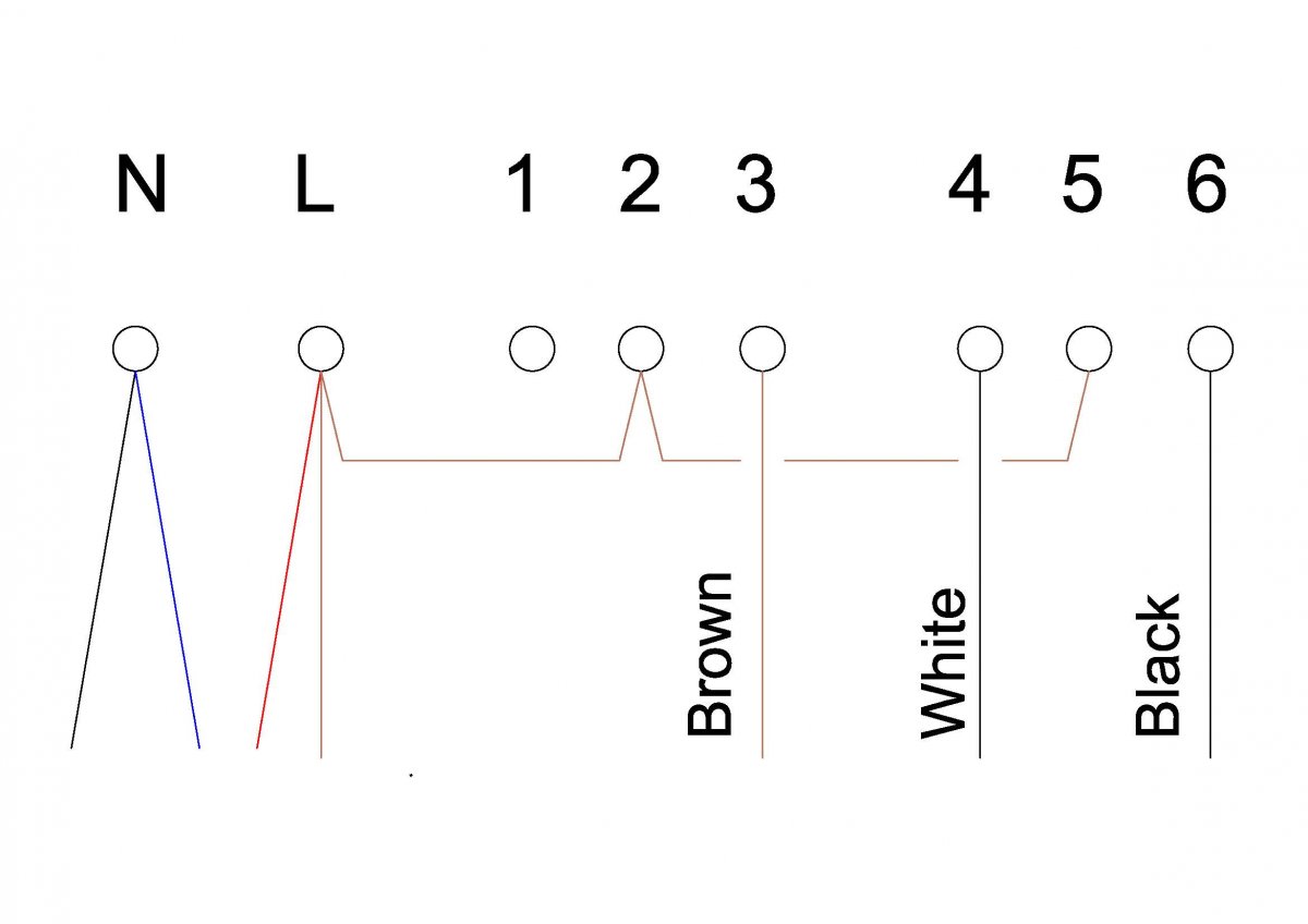

I'm interested in installing a nest 3rd Gen in my house now it can cope with Hot water and heating. Had a look at the current setup which is a Honeywell Timer for Hot water and Heating which seems to be wired as follows.
so the first pic is what i had so i just wired in the new heat link the same it turns on and connects to the stat but no power to boiler?
Link L to 2 and 5
Brown to 3
White to 4
Black to 6

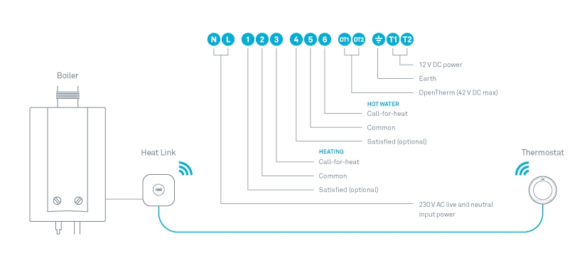

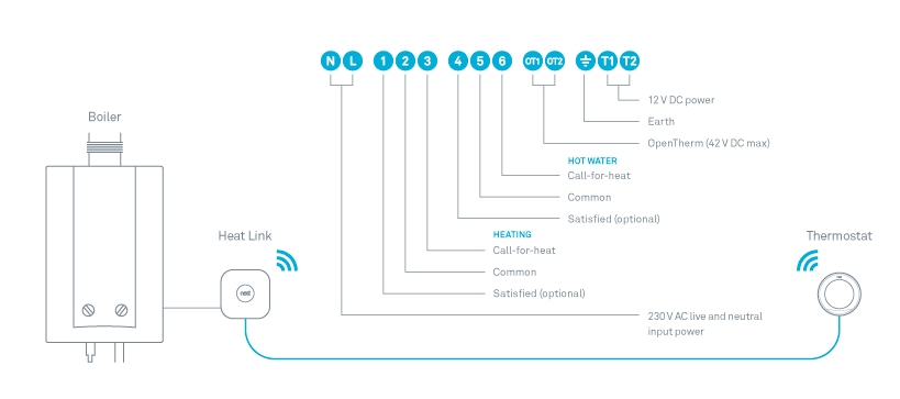

First of all you cannot just swap the wires over 'number for number' because they are different products from different manufacturers and do not correspond. Were there not instructions
with the Heatlink explaining what each terminal does? Like this.
Anyway, it's good that you took a photo of the original wiring. The wires at your original programmer were as follows:
N= 'Neutral' Blue & Black wires
L = 'Live' Brown and Red wires
1 'Hot Water Satisfied' = White wire
3 'Hot Water Call for Heat' - Black wire
4 'Heating Call for heat' = Brown wire
The good news is that the N and L will be correct as you have moved them, so if you look at the diagram for the Heatlink you will see which terminals correspond to the others. In fact johnmdc has already told you.
Brown to 3
White to 4
Black to 6
You also need to link the L terminal to terminals 2 and 5, again as already advised.
The main difficulty comes if you have an existing wired room thermostat, which will need decommissioning, so that the Nest can take full control of the heating. Unfortunately it can't just be disconnected otherwise the heating won't work. If you do have an existing room thermostat and need further help, post back.

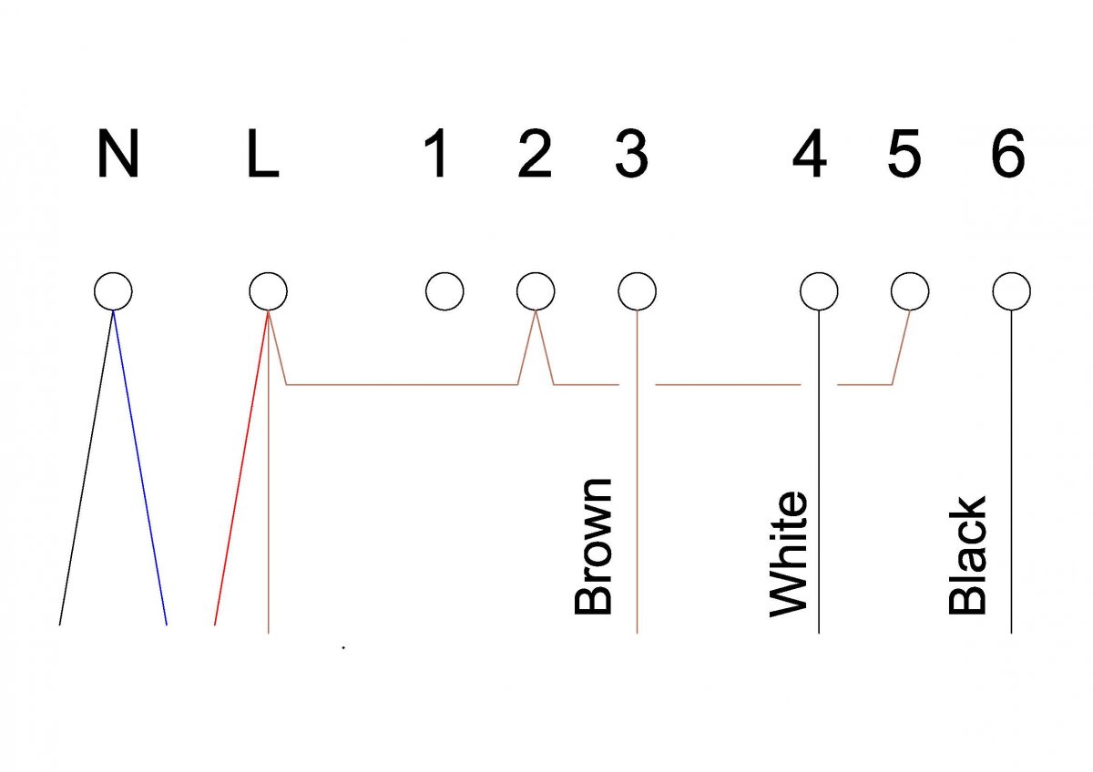

Here's a sketch for you.

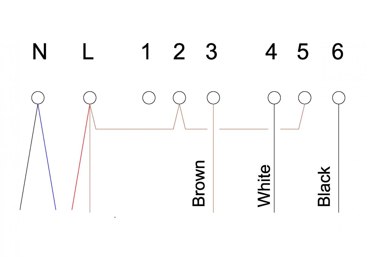

Edit.
So from the sketch it looks like I have to use another wire to go from L Ter to Terminals 2/5 is this correct?
Thanks for the help
Yes that's the idea.

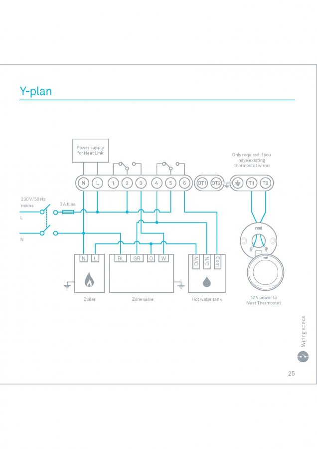

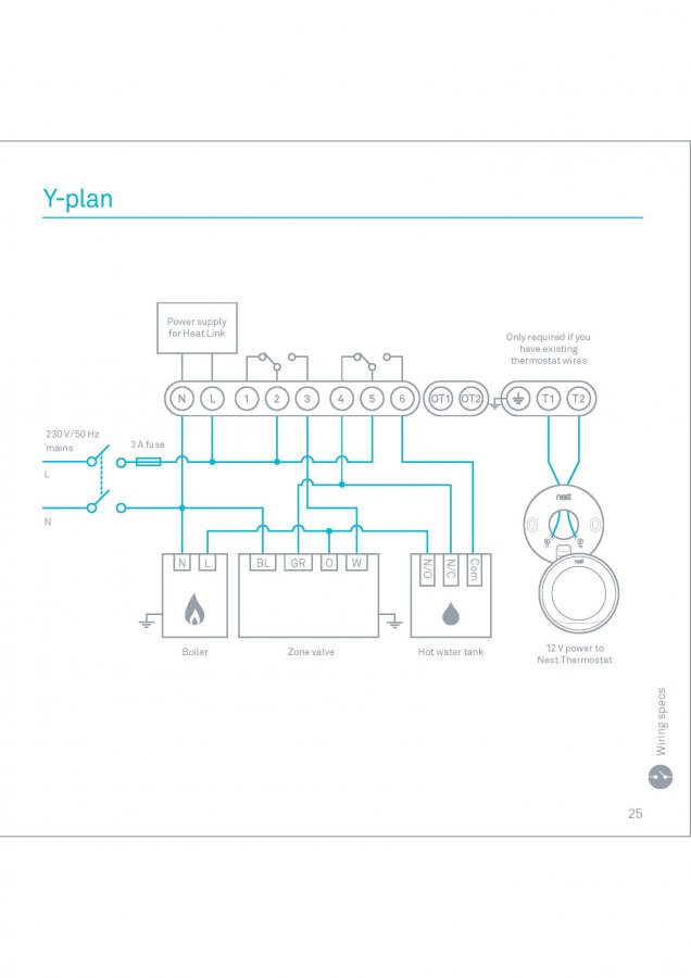

Were there no instructions with your Heatlink? Page 25 shows L, 2, and 5 linked together.

Oh just to let you know it's a Y plan set up I have don't know if that makes a difference

We knew that already as we can tell from the wiring. In fact, if you look at the page of the manual I posted you earlier you will see that it's headed Y Plan.
