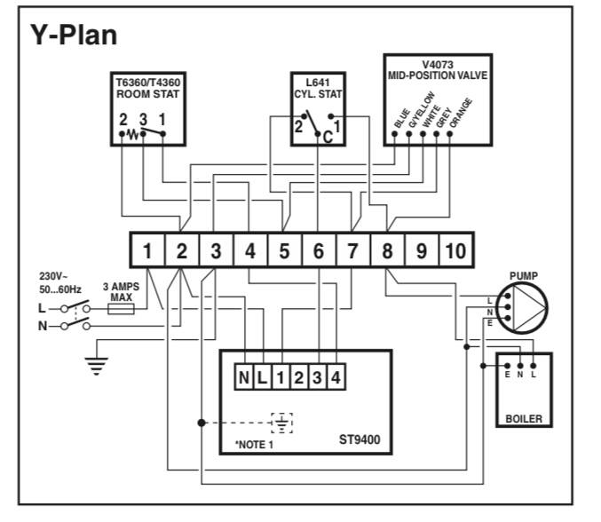

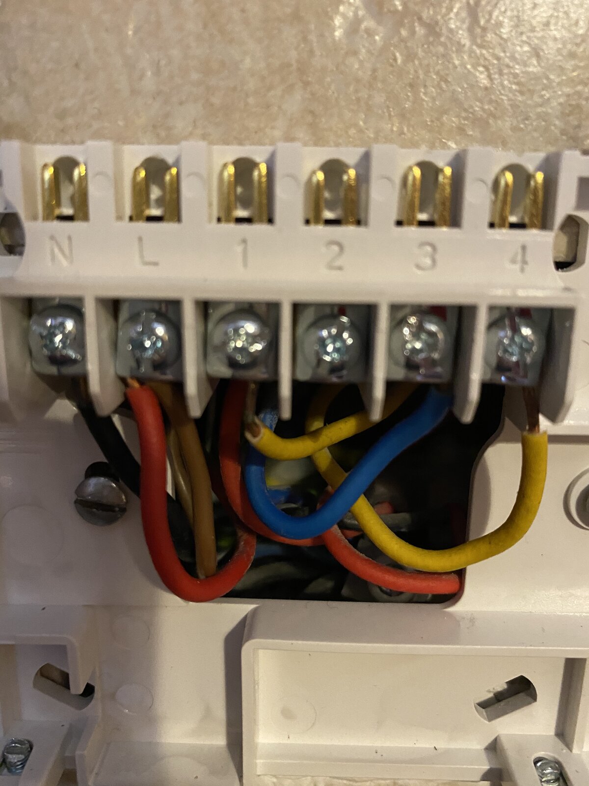

I currently have a Honeywell st9400A on my Y plan system with a Honeywell room stat. I’d like to know what wires go where from my existing controller to the nest heat link. Also what would I have to do to the existing room stat.
I was looking at installing the link next to the water tank so that I can use the existing thermostat wires to put the nest stat in the same position as my Honeywell one.

First of all Gillsboi24 welcome to the forum and congratulations on an excellent first post that actually contains helpful information. :)

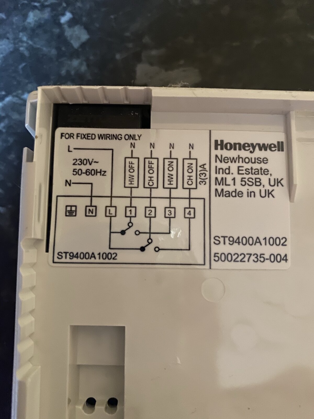

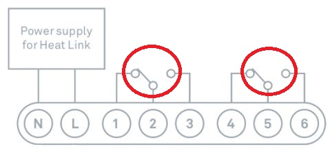

Step 1. The Nest Heat link replaces the ST9400 programmer as it carries out the same electrical switching functions. If you wish to locate the Heat link in a different position to where the ST9400 is you will have to relocate the wires.

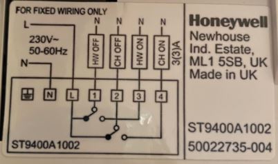

From the your diagram of the ST9400 below we can ascertain that the yellow wire currently in 1 is 'Hot Water Satisfied', blue in 3 is 'Hot Water Call for Heat', and yellow in 4 is 'Heating Call for Heat'.

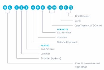

They are moved to the terminals at the Heat link that have exactly the same functions as follows:
1. The Hot Water Satisfied wire then goes to '4' at the Heat link
2. The Hot Water Call for Heat wire then goes to '6' at the Heat link
3. The Heating Call for Heat wire then goes to '3' at the Heat link
4. The 'N' and 'L' supply is self explanatory and is just moved from the ST9400 to the corresponding terminals at the Heat link
5. Heat link terminal 'L' also needs linking to the two common terminals '2' and '5' (these connections are made internally with the ST9400)

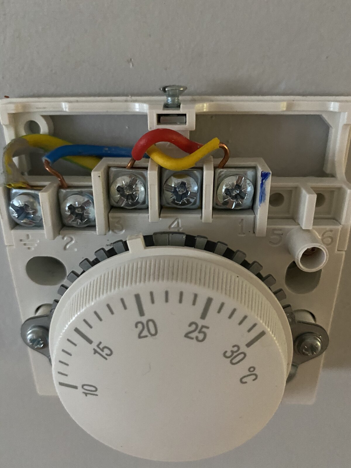

Step 2. Removing the Room Thermostat
Because the Nest carries out the functions of the room thermostat, the old wired thermostat needs to be decommissioned to prevent it overriding the Nest. It can't simply be disconnected as this would leave the heating wiring 'open circuit' and it will not operate. Trace the cable from the room thermostat back to its origin, when you find it, note where the red and yellow wires are connected. Now disconnect the cable and all of its wires that go to the thermostat. Once the old cable is removed, insert a link to join together the terminals that you have just removed the yellow and red wires from so that they are now electrically joined together.

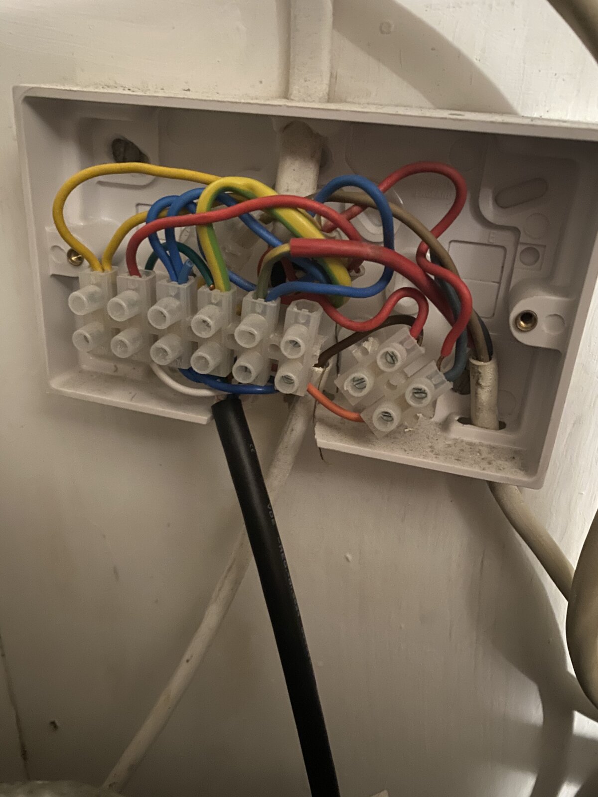

The quality of the existing terminations is poor, there is too much copper protruding from some of the terminals. Also the blue wire in ST9400 terminal 3 is being used as a live conductor, not a neutral, so should have a brown sleeve over it to show this.

If by "controller at the boiler" you mean the ST9400. You can remove it and put the Heat link near the hot water cylinder, but as I said before, you will have to relocate the wiring accordingly. To do that you will need to understand what each wire at the wiring centre (shown in your last photo) does and is what each wire is connected to at its other end.
Unfortunately all of these installations are different, one installer may use a yellow wire to connect A to B, another may use a red wire to connect A to B. It's what a wire is connected to at each end that determines its function, not the colour of its insulation.

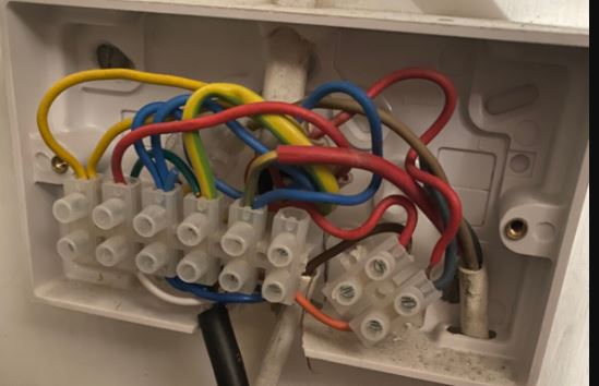

Probably makes sense. If I was going to do it and move the Heat link to a different location, I would start again from scratch rather than try and move things around. The wiring centre could do with some attention though.....
.....whilst the electrical terminations appear much better than at the thermostat and programmer, the cables should be securely fixed. The electrical connections themselves shouldn't be the sole means of supporting a cable. An accidental tug on one of the cables could pull live wires out of the terminals. I've seen a few that are located in airing cupboards and have been pulled out whilst someone is moving laundry, one even caught in a coat hanger hook. If that happens as well as being dangerous, finding out which terminal the wire has come out of can be tricky.
Proprietary wiring centres come with built in cable clamps to hold the outer cable sheath in place.
If you don't want to replace the wiring centre the cables could be fixed by clipping them securely to the wall, or enclosing them in trunking.

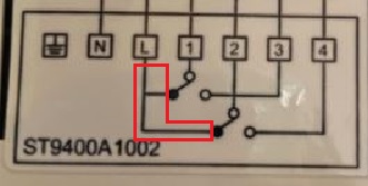

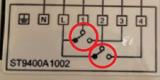

From an electrical point of view, it's a simple exchange. All you are doing is taking out two switches, and replacing them with two identical switches.
Even the extra links you made between L, and the switches 'Common' terminals (2, & 5 at the Heat link) were already there, but made inside the ST9400.
So as you can see, from an electric circuit point of view, when it comes to the ST9400 and the Heat link wiring, you aren't actually changing anything from what you had before. Therefore, provided that you have the wires connected correctly, nothing will have changed.
The room thermostat wiring modification is generally the tricky part as it involves tracing the thermostat cable back to its origin. I don't know if you have done this part yet, but to start with, to test the programmer / Heat link exchange, you could leave it connected and just set it to its highest setting, This would allow you to test the Nest and make sure it is working before decommissioning the old room thermostat.

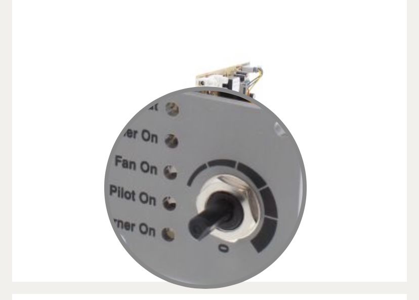

I’m currently at work but been doing research. I have a dial on the front of the boiler behind the little cover. This is set really low. I wonder if this is to do with it keep cutting out. Maybe if I turn the dial it might help. I’ll post a picture of what I’m on about.

OK, so you have a Baxi Solo 2 or 3. It's difficult to say what yours is set at, because the operating knob is missing from the spindle. That dial controls the temperature of the water that leaves the boiler. Anticlockwise is minimum, and then off [off is the position shown in the diagram] Fully clockwise is maximum. The burner will then cut in and out to maintain the selected temperature.
However I can now confirm that what you describe:
The boiler comes on fires up for about 1 minuet 30 goes of for about a minuet and then comes back on. It just repeats that cycle.
Is exactly how it is designed to work, it's regulating the temperature of the water heading for the radiators. It will do it regardless of the setting, the on and off periods will change slightly as you adjust it. Nothing wrong there. (y)
