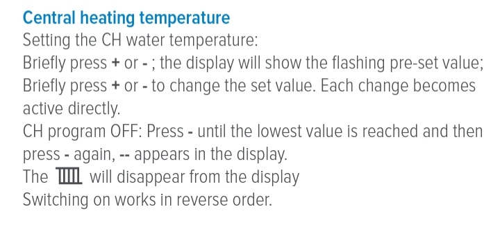

I don't think i can just trigger c/h from the boiler itself, unless I am reading the manual wrong?
If I've got the correct model, just keep pressing the C/H temp down button until a dash appears in the display?
I see, thank you.
