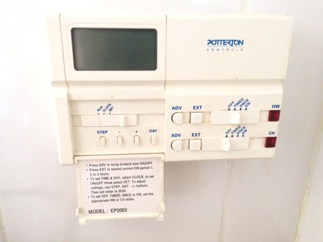

Potterton EP2002 Programmer (can currently control CH & HW independently) Pic 1
Potterton EP2002 Programmer (Wirings) Pic 2

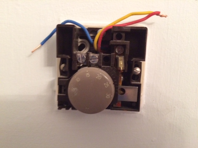

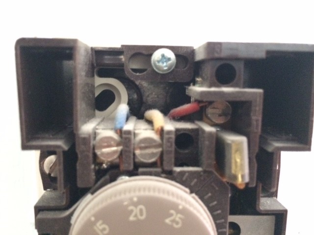

PRT100 Thermostat Pic 3
PRT100 Thermostat (Wiring) Pic 3.

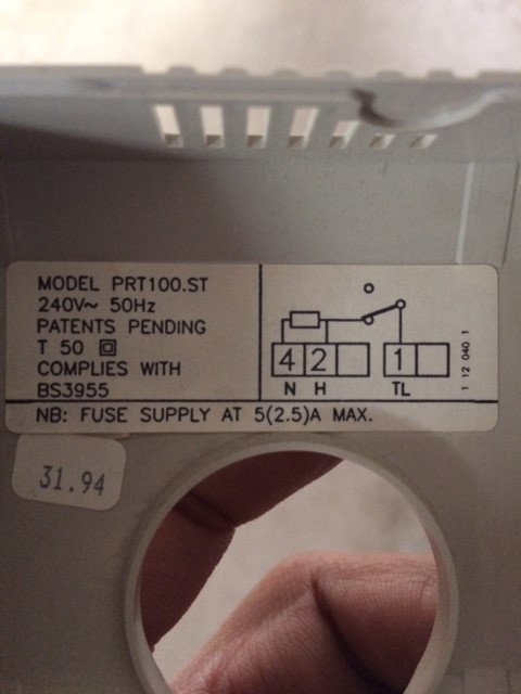

2. I have PRT100 thermostat, which I assume high voltage? How can I use Nest on it?

The Nest unit incorporates an integral room thermostat, so the PRT100 is redundant and should be removed.
The two wires used for switching that are presently connected to PRT100 terminals 1(TL) & 2(H) should be connected together. Do this at the wiring centre end, then the existing cable to the PRT100 can safely be disconnected and removed.

The wiring at the EP2002 is presently as follows:
N=Neutral
L= Live
1=Hot Water 'Satisfied'
2=Not required [Heating 'Satisfied']
3=Hot Water 'Call for Heat'
4=Heating 'Call for Heat'
5=Link to L terminal - Note:The red wire left when the link is removed from here, should go to L on the Nest Heatlink.
So you will see that above, I have used the same terminology as the Nest Instructions so that you can make a direct substitution. The Nest Wiring is:

Unless your existing room stat is wired back to where the heatlink is going, no wires are connected to the nest stat.
Yes, the current Theromstat PRT100 is wire back and its a high voltage. So i bought a Nest Stand and connected the NEST thermostat to it.

Just like, Mr.Stem said in the above/below comment..i need to take out the old thermostat (PRT-100) and connect the PRT100 terminals 1(TL) & 2(H) and leave it behind the wall..i am not sure it will solve my problem or not..Do youve any suggestions sir? Many thanks.
Terminals T1 and T2 provide a 12V supply from the Heatlink to power to the new Nest Thermostat. They are nothing to do with control of your heating. You don't even have to use them if you choose to power the Thermostat using a separate power supply that can be plugged in. As I said before, your old Thermostat PRT100 needs to be removed and the switching wires joined together at their source. I suppose you could then use the redundant cable to get the 12V from the Heatlink to the Nest Thermostat if it happens to be installed in the correct place. Many aren't because they go to a wiring centre rather than to the programmer.
I will do as you said i.e connect the PRT100 terminals 1(TL) & 2(H) together and left other one alone. I will add the tape and put them back in to the wall. I didnt do this last time when i replaced EP2002 with HeatLink. May this is reason why, even when i change the temp in NestThermostat, i can see sound from heatlink and not any movement from the boiler. I will do that today and let you know sir.

Just like, Mr. Stem said in the above/below comment. I need to take out the old thermostat (PRT-100) and connect the PRT100 terminals 1(TL) & 2(H) and leave it behind the wall..i am not sure it will solve my problem or not..Do youve any suggestions sir? Many thanks.
You need to find where the old thermostat cable is connected back to , and fully disconnect it, then fit a link in it's place. If the stat is wired back to the heat link position you can re purpose it to feed 12V to the new stat, using the t1 and t2 terminals at both ends. If the old cable doesn't go back to the heatlink position you will not be able to make use of the t1+t2 connections and will have to power the stat with the plug in power supply. Do not connect the old wires into the t1+t2 terminals as it currently is or the new stat will explode. The wiring of the stat is sort of explained in the installation manual.
It is also unacceptable to just join the old wires and shove them in the wall behind the new stat.

I have disconnected the old thermostat PRT100 and joined the wires together. Please see the attached picture.

Those live wires sticking out of the thermostat are giving me a heart attack. Find the junction box where the thermostat cable connects back to and disconnect the old thermostat cable. Put a wire link between the terminals where the thermostats red and yellow wires connected to. Do this first before someone dies.
