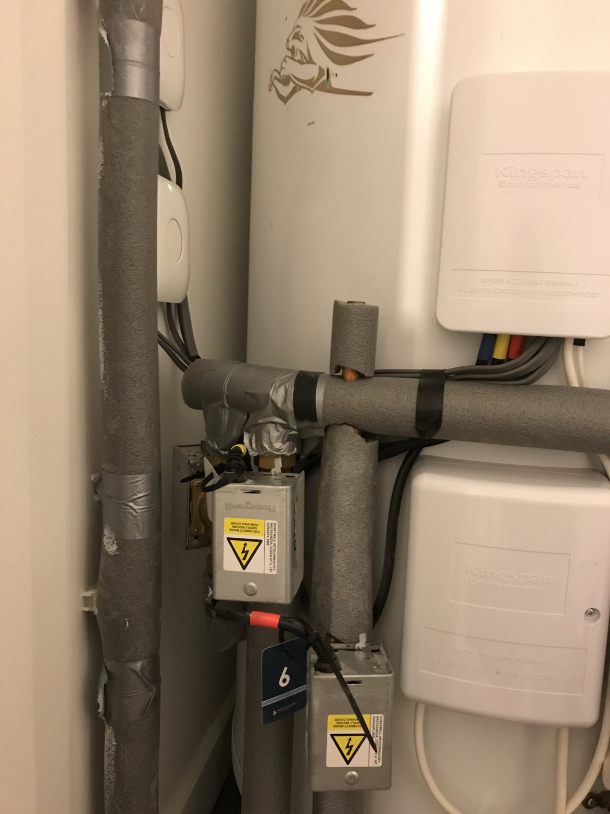

Take a photo of your cylinder layout including the motorised valve(s), as you said it’s as you believe?
Water valve is on left behind and 2 zones at front. Hope that helps.
S plan.
HW off / CH off are not required, which is why they are not connected to anything.

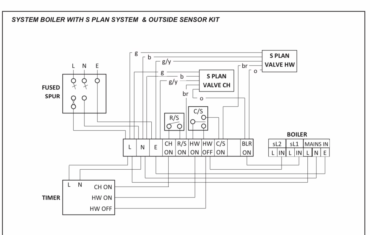

I’m looking at the diagrams for wiring for the boiler and then with the weather comp for S plan. It looks like if it has weather comp then it has HW OFF hooked up on the cylinder stat and then to SL2 on the boiler, maybe this isn’t hooked up correctly if the HL isn’t providing HW off?. In theory if I remove weather comp and SL2 it should work as expected?

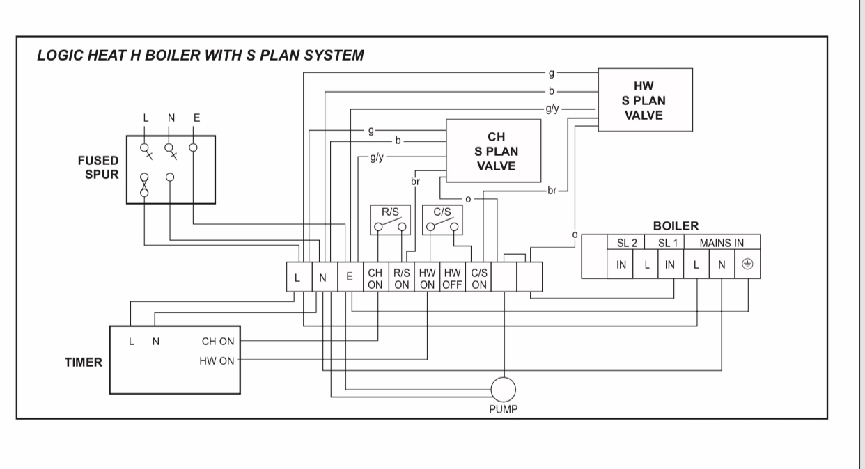

The nest is turning on/off the valves as I can hear them. The old danfoss thermostats that were connected had the HW OFF wired in when I cross reference the diagrams for the tank/danfoss/old photo. The boiler wiring suggests it only needs SL1 connected and this should get triggered by any of the three orange valve wires that are connected. The boiler also has weather compensator attached and SL2 wired, the wiring diagram the comp suggests that the SL2 comes from the HW OFF so is solely for the weather comp. So my thinking is since the nest doesn’t have the HW OFF connected, I either need that connecting or I remove the weather comp and SL2 in which the boiler should then work solely on SL1. Does this make sense?

Ideal tell me it fires when it should be off because the HW OFF isn’t connected which should be live when no HW so neither SL1 or SL2 are live.
