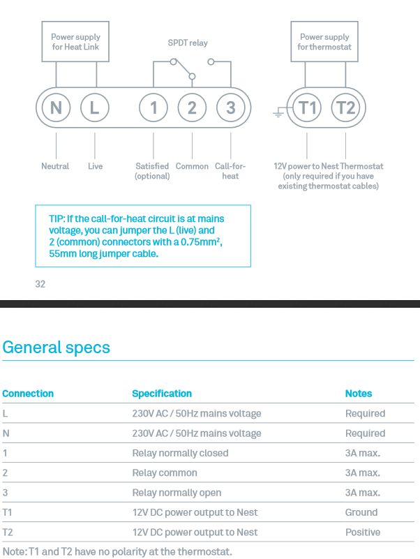

... the following image is from the Nest manual:
Looks like I would attach:
brown = 240v L => Nest L
black = 240v N => Nest N
green = SL (off) => Nest 1 (Satisfied)
grey = SL (on) => Nest 3 (Call for Heat)
dark brown = link wire between Nest L and Nest 2
is this correct for CH heat control only in place of the existing stat which is also CH heat control only ?

If you did want to add hot water control then you need to alter the wiring centre. It's quite simple to do. Connections as above for the heating (trace back the Salus wires and swap them out for the correct Nest terminals) but also link 5 to 2, then on the hot water side link the hot water demand from your existing programmer to Nest 3

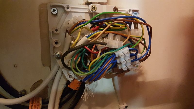

now got a clear-ish image of the wiring centre. As you can see its a bit of a mess so I didnt want to meddle with it but I can if necessary ! Seems like the sparky (or plumber?) used any old 4 core cable he could find hence the use of earth cable for live feeds !
The Salus cable is white one 2nd from the right at the top (with my screwdriver pointing on it).
brown = 240v L => #9
black = 240v N => is hidden in the pic but goes to the central block, 4th connection down (from the top).
green = SL (off) => #3
grey = SL (on) => #4
#3 SL (off) and #9 (240v L) seem to be connected together via a red link - I cant see the reason for this.

The green cable on 9 (then going to 240v L on the receiver) is actually a switched live when the CH is 'on' on the programmer. This means when the CH prog is off, the receiver is powered down so needs to pair again with the wireless sender each tie it comes on - this explains the 10 minute delay currently when the CH first comes on! I guess if I leave the CH permanently on then Nest can stay like this also so doesnt power down.
per Andrew's recommendation
#9, brown cable = L => Nest L & 2
middle block, black cable = N => N on Nest
# 4 grey cable = SL (on) => 3 on Nest
is this correct ? what is the purpose of the link between 3 (SL Off) and 9 (240 L) and would it be ok to remove it ?

That's not a mess, THIS is a mess...
Having said that, they have mixed colours in yours without marking them which is not great (some greys are live, some are neutral)
For wiring a 3rd Gen Nest with hot water into your wiring centre (may as well go for it now!)...
POWER OFF
CHECK POWER IS OFF!!!
Remove all four programmer wires, one at a time making sure that you put back any other wires that get pulled out at the same time. Use a process of undoing a terminal, removing the required wire, then tightening the terminal up again before you move on to the next one
Repeat the above with the thermostat wires. You can re-use the two bits of flex you now have to wire in your Heat Link
Nest L, 2 & 5 => WC 7 or 11. You can link L, 2 & 5 at the Heat Link end if it's easier, then just connect Nest L to WC 7 or 11
Nest N => Any of the bottom three terminals of the vertical block of the WC
Nest 3 => WC 4
Nest 6 => WC 10
Nest Earth => Any of the top three terminals of the vertical block of the WC
Power on and away you go
thanks Andrew - very helpful. Like you say, I may as well bite the bullet and swap out both the programmer and the wireless stat/receiver for the 3rd gen. bit more effort in cabling/wiring but better in the long run (assuming I dont c**k it up). So just to confirm,the red link between the #3 (SL (off)) and #9 (240v L) is surplus to requirements / pointless ? why would the previous installer have done this ?
Can I keep the heatlink in the attic by the wiring centre or does it need to be nearer the nest stat ?
The red link is unneccessary, but once you've removed the old stat wires it won't be connected to anything anyway so you don't really need to remove it. The minds of installers are for them and them alone to know! The Heat Link will be fine in the attic, assuming your house isn't a mansion. It's good for 30m range
