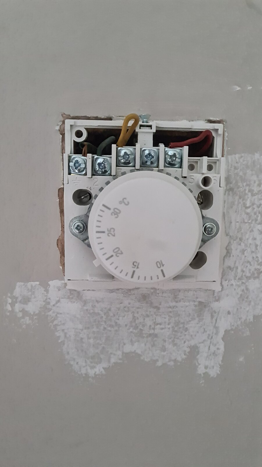

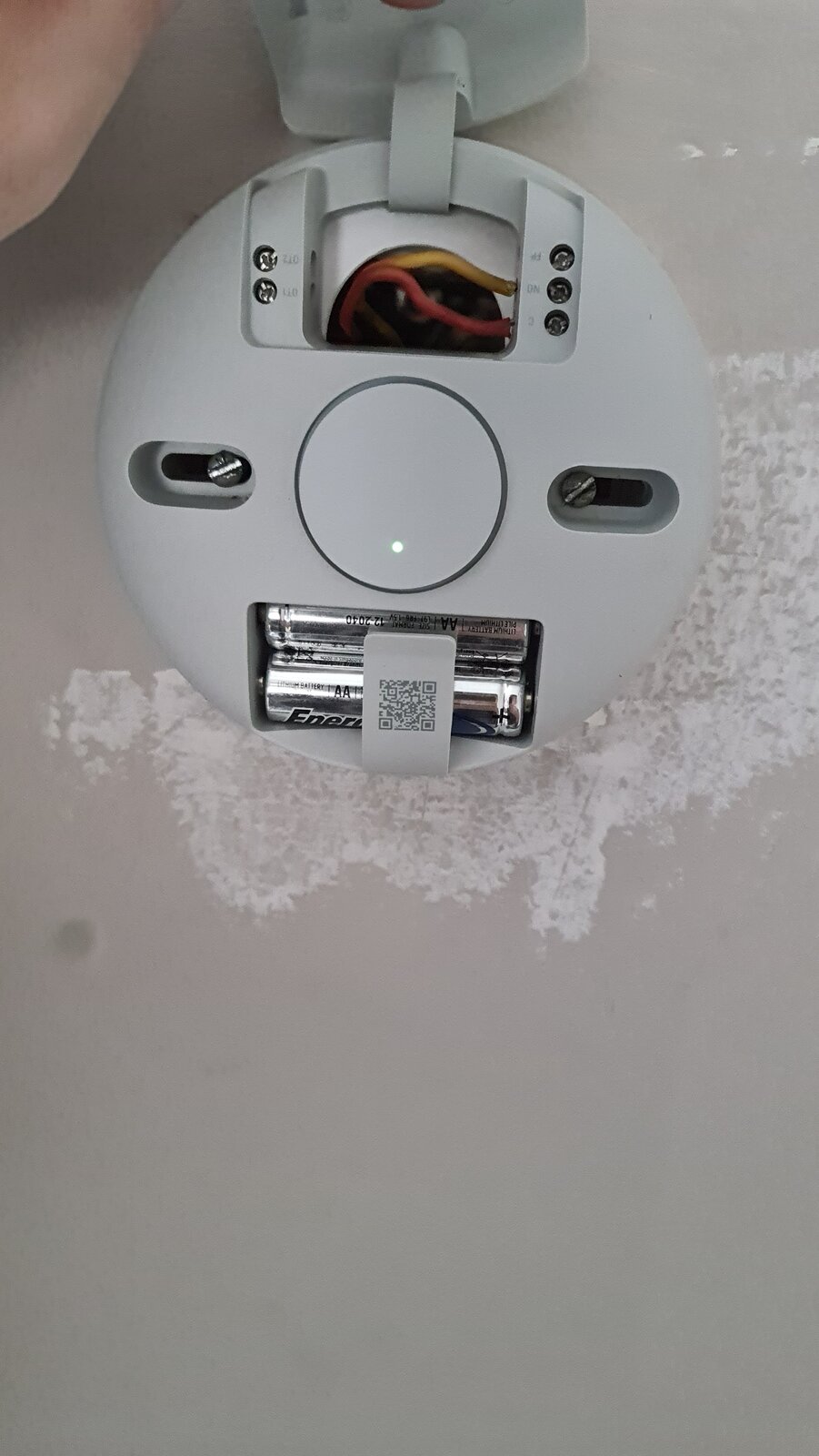

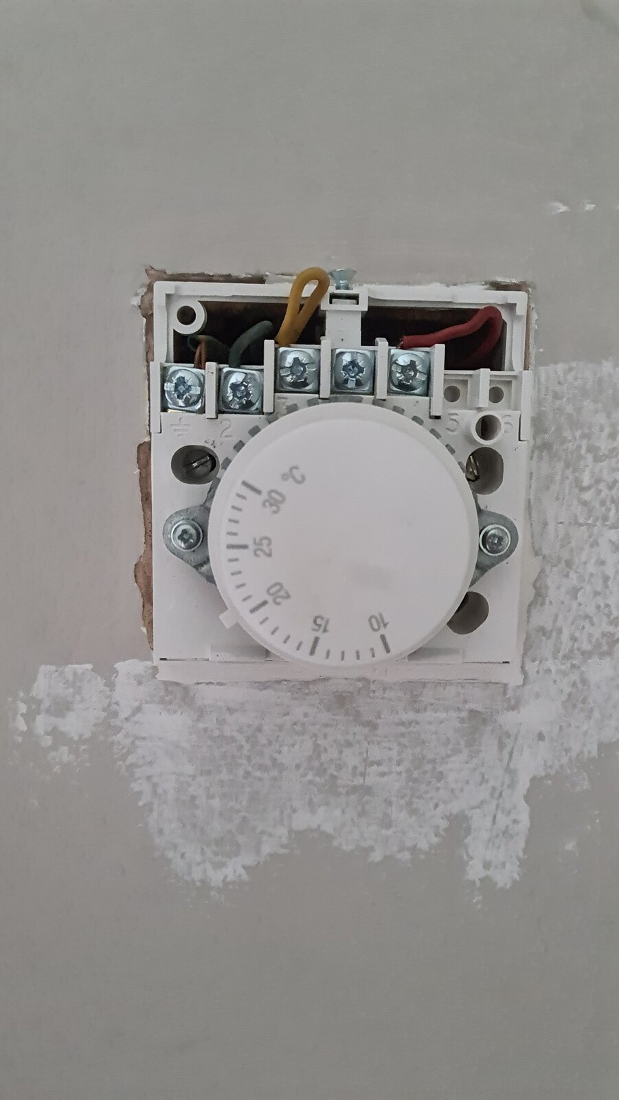

I have a nest E thermostat which I've put in replace of a honeywell t6360. I've wired this is before at a previous address with no issues. However this time round no matter what wires I put in what place the heating stays permanently on. The nest thermostat is on the off setting yet the boiler does not cut out.

I have a combi boiler. I've tried refitting the honeywell and that works and turns the boiler off perfectly fine. No issues. Just checking I am putting the wires in the correct place

So it should just be live and switched live to Com and NO. That’s it.
That's what I thought. But still the boiler just stays on even when the nest is set to off .. I'm confused haha
I would remove one wire and put it safe in a choc block as a test, boiler should then stop working, it does seem a fault with Nest e, but taking the N/O wire out will prove it.
As to melt in the heat, there must be a secondary problem as the TRV's should turn radiators off, so all that should happen is boiler fire up, by-pass valve open, and boiler turn off again.
