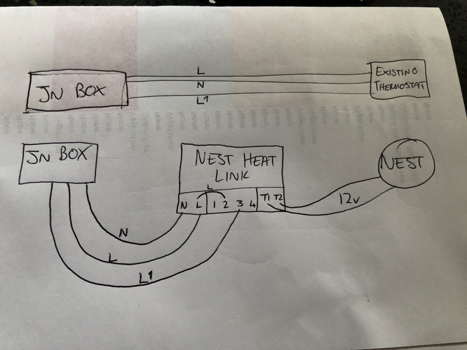

However, I am struggling to get my head around how the Heat Link will be wired.

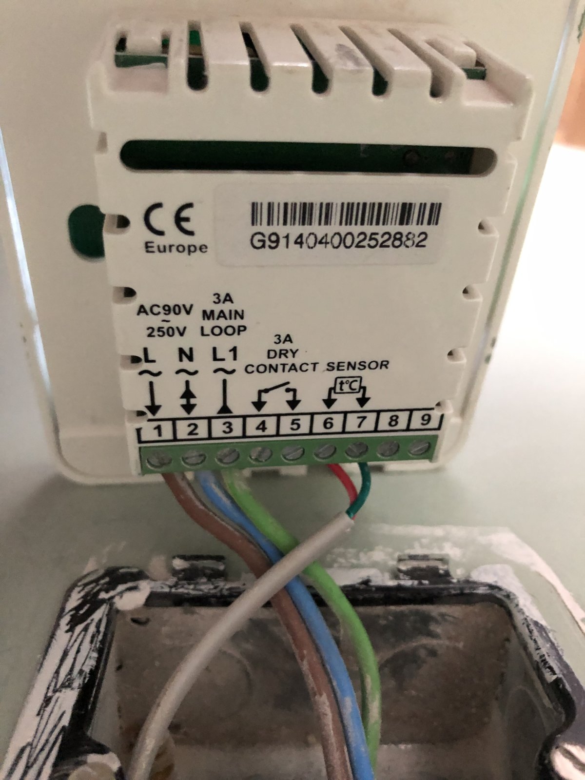

Nest is in essence a switch, and I'm replacing the existing wired 230v Thermostat, which has 3 wires going to it: L,N,L (3A) (Please see photo)
Am I right in thinking that the current wiring from the (messy) junction box to the wired Thermostat should be replaced as follows and I don't even need to touch anything there?
From:
JN Box > Existing Thermostat
To:
JN Box > Heatlink > Nest
I have attached a diagram with the assumed wiring, does this look right?
I'm aware the temperature sensor will be surplus to requirements.
Any help gratefully received. I'll say at this point that if this is wrong or I need to open up the junction box I will employ a friendly local tradesperson ASAP. Thanks!
Yes that will work, would be good practoce to put brown or red sleeving over the green wire or some red or brown tape to identify it as a live wire, will work without it just good practice
Many thanks Ian, your input is much appreciated.
Yes I'm aware that the wire is the wrong colour (the same bodge has been used upstairs also for the previous BRD91) and I will ensure the wire gets labelled.
The only thing I really wasn't sure about was the need for the jumper wire from the Live to 2 on the Heat Link?
yes you need that link for your setup, other setups can be used but that is how yours was originally wired
