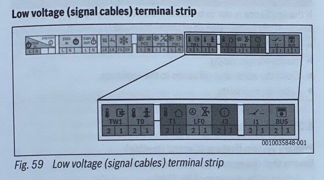

Existing - Boiler, Fused spur & fixed room stat ( 2 core low voltage
I am happy with the wiring, however, I would like to confirm the connection from heat link (Terminal 2) to LR (Radiator symbol) fig
Replace existing wall-mounted room thermostat (2 core cable in place)

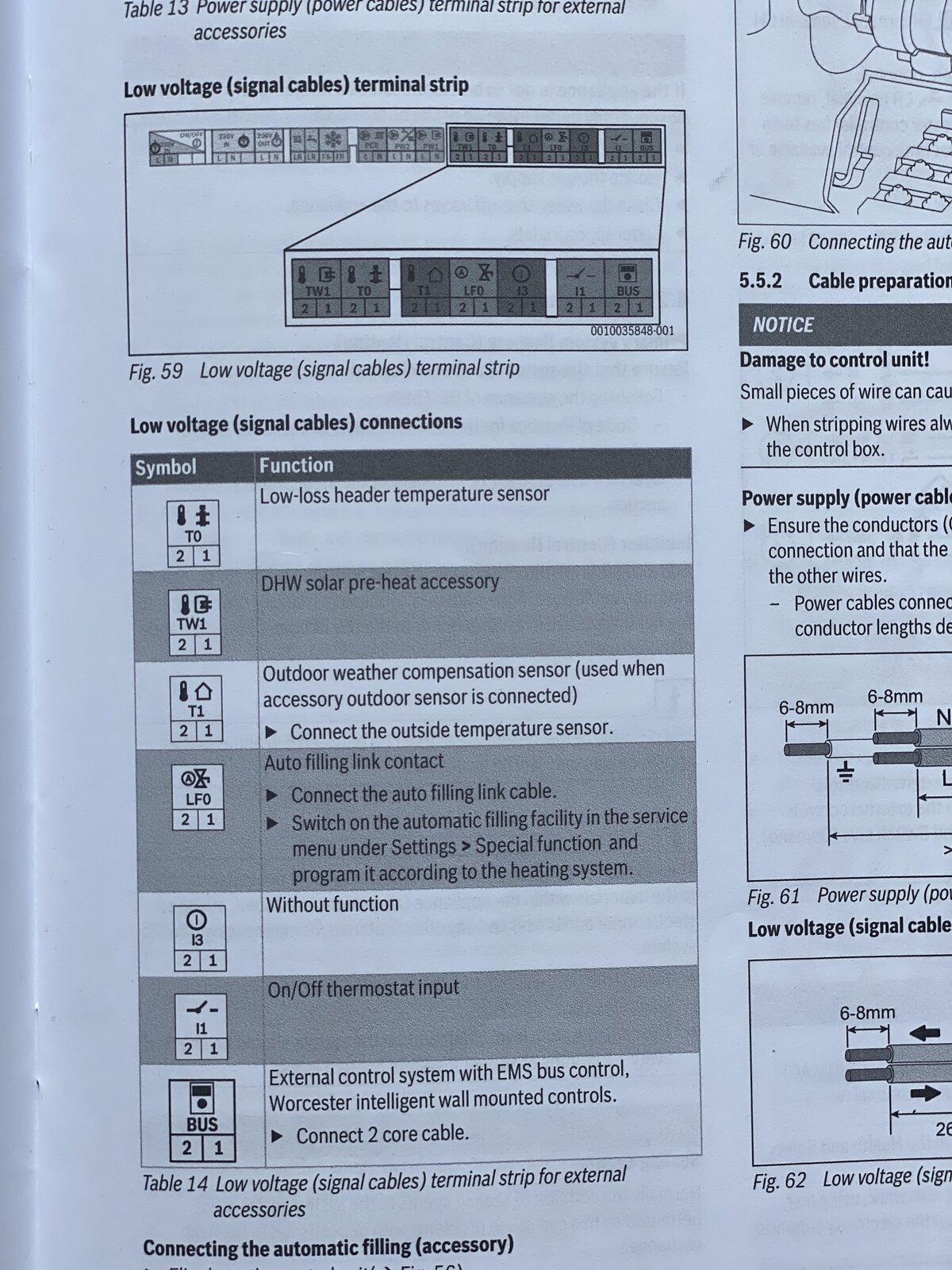

Can I just confirm the Heat link terminal 2 is connected to LR (Rad Symbol) as per boiler manual
Heat Link Boiler Thermostat
L /N L/N 230 OUT
Term 1 L 230 OUT
Term 2 LR ???

You've posted your enquiry twice and both are in the wrong forums, so have broken two of the forum rules in one go...but as you're a newbie here's the info you require :giggle:
The mains supply you have right, and also the T1 & T2 connections.
For the Heatlink
No connection is made to terminal 1
Terminal 2 (Heating Common) link to Heatlink L
Terminal 3 (Heating call for Heat) goes to boiler LR (CH Live Return)
You don't mention an earth, but an earth is required to the earth terminal which is to the left of Heatlink terminals T1 & T2

Just for clarity, as it’s a bit confusing, the T1 and T2 only go from heat link to Nest thermostat for power supply and not on the T1 - 1/2 on the boiler terminal strip, as this is for weather compensation.

Oh dear, I am 99% sure the BUS is NOT Low Voltage but in fact extra low voltage, so likely everything else shown as low voltage is also extra low voltage, this is not USA, we should abide by ISO rules.
