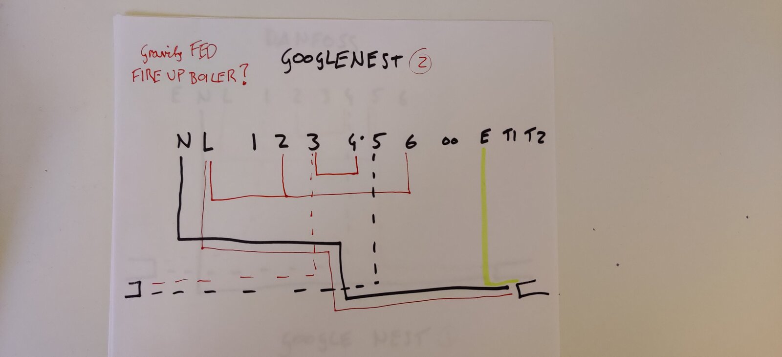

Hey guys

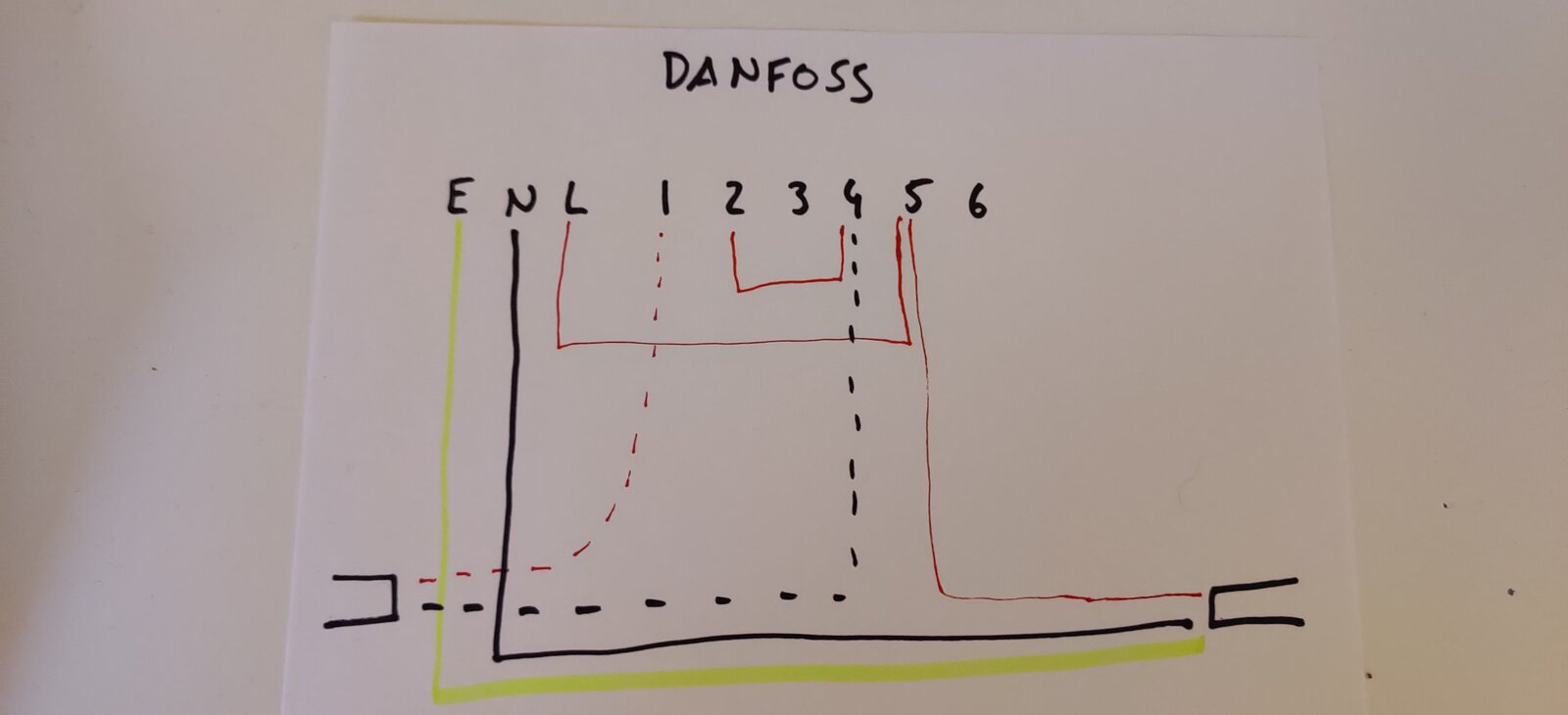

I have moved to a house with a oil Combi boiler and a thermostat Danfoss which is on the wall in the kitchen. The system is configured where the Heating can't be on without the hot water being on too.
Can I replace this with my Nest Learning Thermostat?
From the attachments you can see the current wiring in the Danfoss.

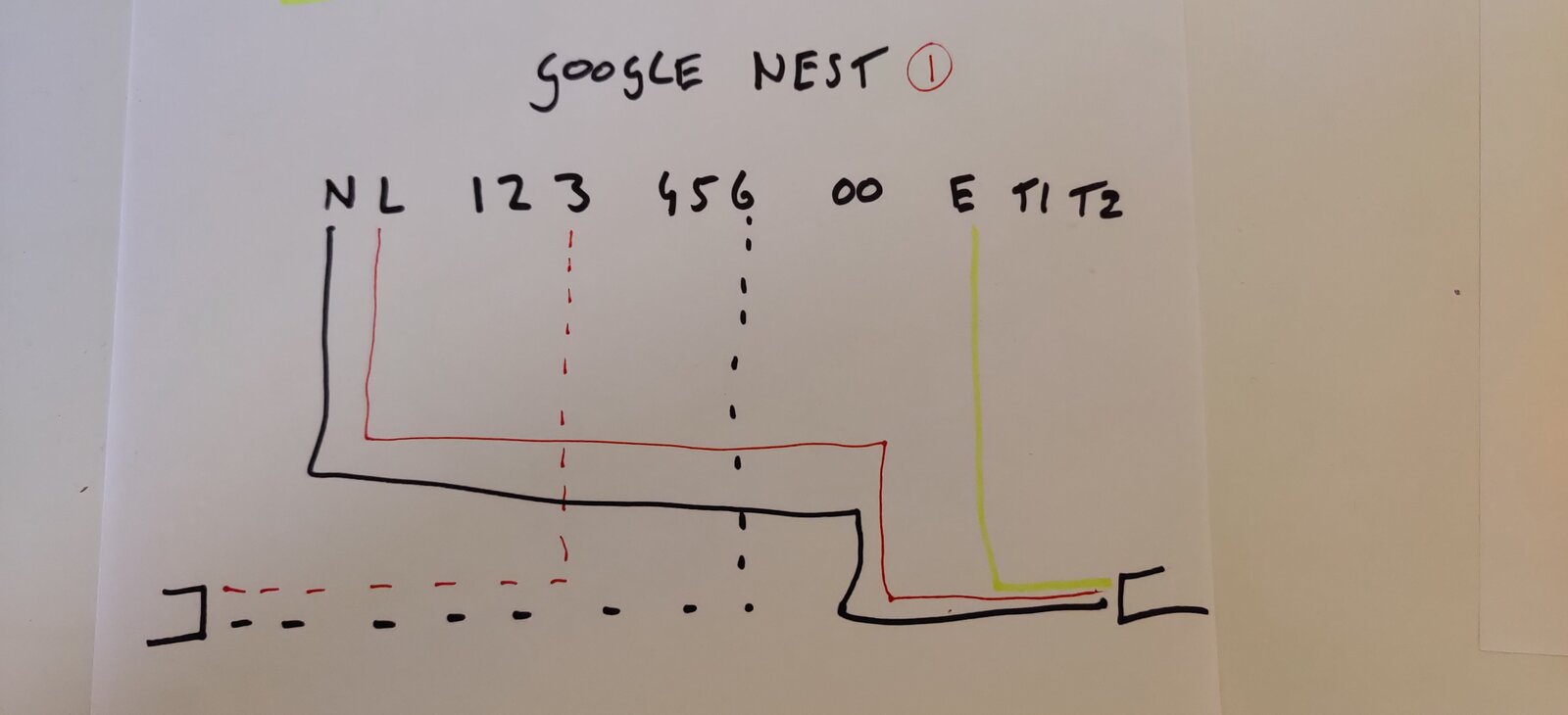

I attempted to wire as seen in Google Nest (1) diagram but the boiler was not firing up.
I asked the previous owners who said he had a Hive and changed the settings to gravity fed, but I can't do this with Nest.
If I wire up as seen in diagram Google Nest (2), will this fire up the boiler?

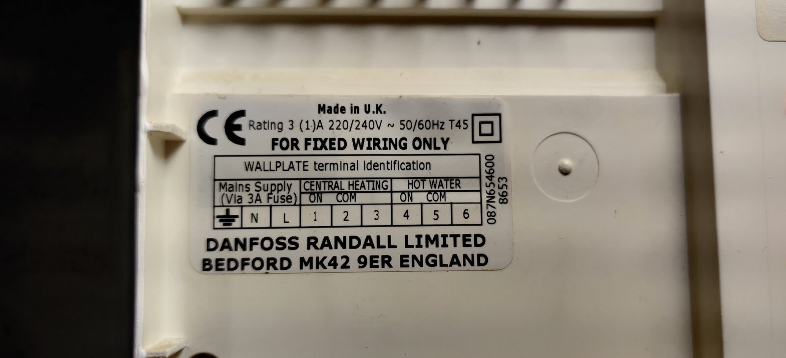

Not sure if this is a stupid question, but, the flexes currently in the Danfoss at the wall as you can see in diagram 2, there are only 2 flexes, the one on the right is the 3A fused spur? And the left flex only has 2 wires, black which was linked to HW common on Danfoss and red wire, connected to call for CH on Danfoss. There are no neutral wires as seen in your diagram, are these necessary?

Unfortunately there are many ways to wire heating systems up. Yes your boiler and pump will need a neutral connection to work so if they are working now they must have it. Whilst the diagram I have drawn shows the 230V supply coming to the Heat link. They could be connected to N elsewhere in the heating circuit. It's down to the personal preferences of the installer and the layout of the various components in relation to each other inside your home.
The red wire in Danfoss 1 is the 'heating on' connection and so should be the live to the pump and would go to Heat link 3 Heating call for heat
The black wire in Danfoss 4 is the 'hot water on' connection and so should be the live to the boiler and would go to Heat link 5 Hot water common
Based on that, your diagram 2 would appear correct.
