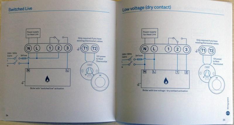

The UK Nest is slightly different (completely different) to the US model. There's not much online about this new Heat Link they provide, as such I've snapped the manual which might help you/others...

Aha, you've posted some snaps.
2 and 3 are the volt free contacts for the boiler, these switch your boiler.
N and L power the heat link.
T1 and T2 are the 12v to power the Nest.
Do NOT link N / L to anywhere else on the Nest system!

That makes sense, so at the minute the Blue & Brown connecting my stat, runs back to the voltage free connection on the boiler. So, remove from the volt free end on the boiler, and drop in to T1/T2 on the heatlink.
Then run new copper from the volt free connection on the boiler, to 2/3 on the heatlink...
Having a certified electrician run the power...
Yep that sounds right to me, looking at the diagram, but I've never installed one.
I do know that it's imperative to use the existing stat wire only to supply 12v from the heat link, and nothing else.
That's more like it. The diagram I got up on the internet must have been the US one as it made no sense to me. The diagrams you have put up make perfect sense. I'm not familiar with your boiler. Is it a combi or do you have zone valves?
Yeah the US one wasn't really UK friendly... They've obviously been working on this solution for a while, as they've always been silent when quizzed when the UK would get it.
The Saunier Duval Themaclassic F30E I have is a combi, no zones - single stat. Apparently the boiler is horrible and should be replaced... but, it's plodding on for now. Touch wood.
Anyhow, thanks to your help (and patience), I'm now up and running!

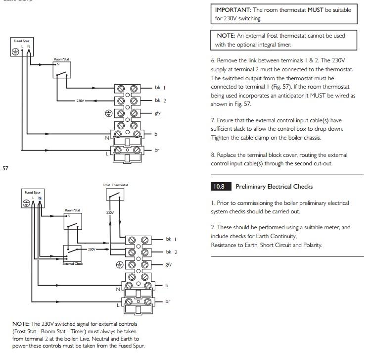

Hi guys
In process of buying a house with a Potterton Heatmax Combi boiler that has NO room thermostat.
Been looking at the nest but struggling with the installation of the Heat Link.
My bolier states that the room thermostat MUST be suitable for 230v switching, but looking at this thread it & reading up on nest it needs to be 12v max?
Any help on wiring the heatlink is much appreciated.
Pic below from the boiler manual showing electrical connections.
Any help greatly appreciated.
Thanks in advance
Dave :D
Yes use the nest as in the LOW voltage diagram even though it will actually be switching live to the switched live wire.
Are you removing the external timeswitch (if there actually is one) and connectiing the heatlink directly to boiler terminals 1 & 2 ?
