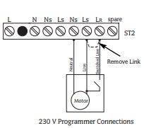

There is a diagram in the 28 Si II boiler installation manual showing the connections to use:
OK, the Nest Heat link doesn't physically have a motor, but it still requires the 230V supply to power its electronics.
Ns = Neutral supply.....Goes to Nest Heat link N
Ls = Live supply.....Goes to Nest Heat link L
Lr = Live return, marked as the Switched Live wire in the diagram.....Goes to Nest Heat link terminal (3) 'Heating call for heat'
The Heat link will also need to have a wire link inserted between terminals (L) and (2) 'Heating Common'
Thanks everyone for your response but special thanks to @stem the help with above. I have managed to install it using this. :)

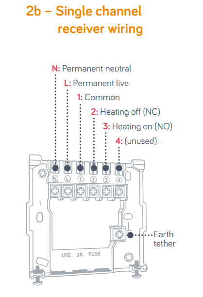

For a combi boiler without a stored hot water cylinder (aka Hot Water Cylinder) you would require the single channel version of Hive.
Ns = Neutral supply.....Goes to Hive N
Ls = Live supply.....Goes to Hive L
Lr = Live return.....Goes to Hive terminal (3) 'Heating on'
Then add a link between the two terminals Hive L and Hive (1) 'Common'
