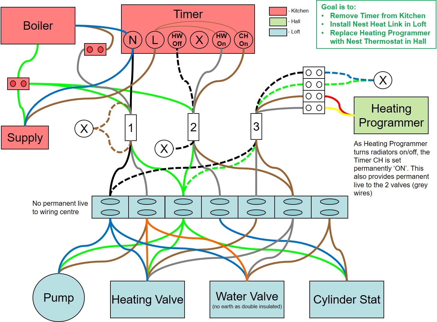

Hi all,
Just about to purchase the 3rd gen Nest Heat Link & Thermostat but first I thought it would be a good idea to do a little research on how it works and how I would replace the existing setup. I've drawn out how the current system works and how I propose to install the new system. Wondering if more knowledgeable installers could check to see if I have everything covered.
Many thanks.
It all looks good to me. I assume the brown loops between terminals 2 & 3 and 5 & 6 represent the internal switching of the Heatlink and not wires that you plan to add.
Stem, yes that is correct. The loops between 2 & 3 and 5 & 6 represent the internal switching - it helps me understand the path through the wiring. Thanks for your comment
Also, it ties up the original ahem....... untidy installation nicely too (y)
I inherited the current installation when I bought the house. It works but it is a bit of a mess with a few wires in the timer, thermostat and wiring centre not connected to anything and not labelled correctly. Luckily I can use a multimeter so I could determine the current situation and plan for a replacement. The main reason for doing this is the current Honeywell thermostat/timer temperature sensor isn't very accurate and the lcd screen is failing so instead of buying a direct replacement, I thought I'd look at alternatives.
