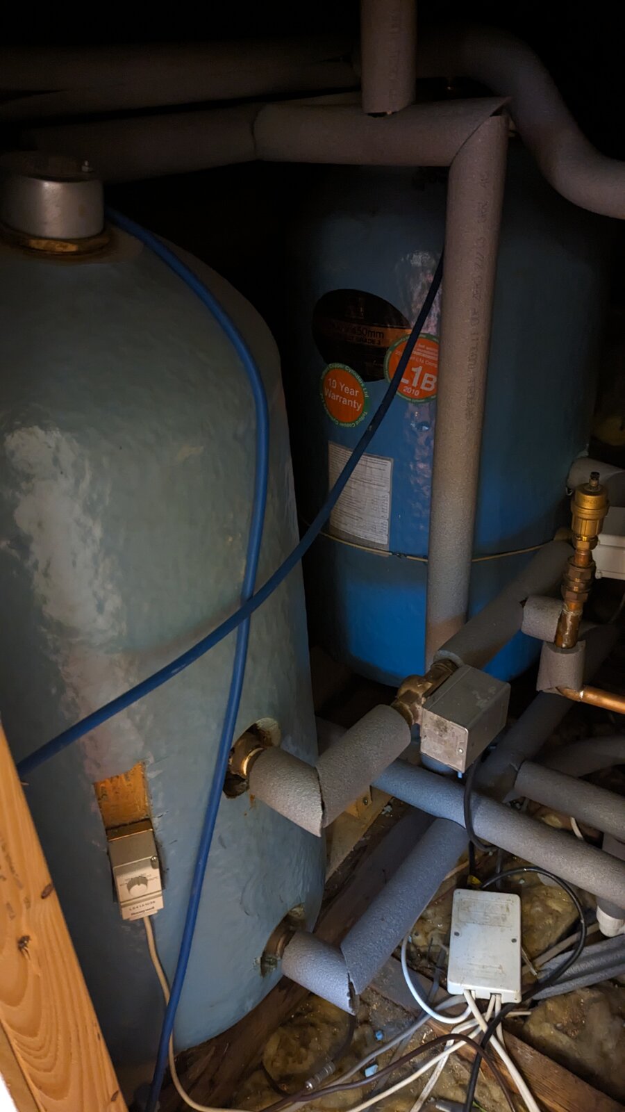

Sounds like a faulty motorised valve rather than the nest. Do you have a 3 port valve? - likely to be in the loft or wherever the pump is located.
Does this pic tell you anything? Everything was working as intended for the past few months so I don't think it's port valve fault but something related to nest settings.
Does this pic tell you anything? Everything was working as intended for the past few months so I don't think it's port valve fault and something related to nest settings.
Yes, appears to be a 2 port valve. Other thing to check, I believe the Nest has a legionella setting - try to access that
Thank you for the suggestion. Bacteria setting is disabled. As soon as I put hot water on, my gas boiler starts. I want the nest to use electricity to heat water and gas boiler to central heat the house. I don't know how can I tell it to use different functions for heating and hot water.

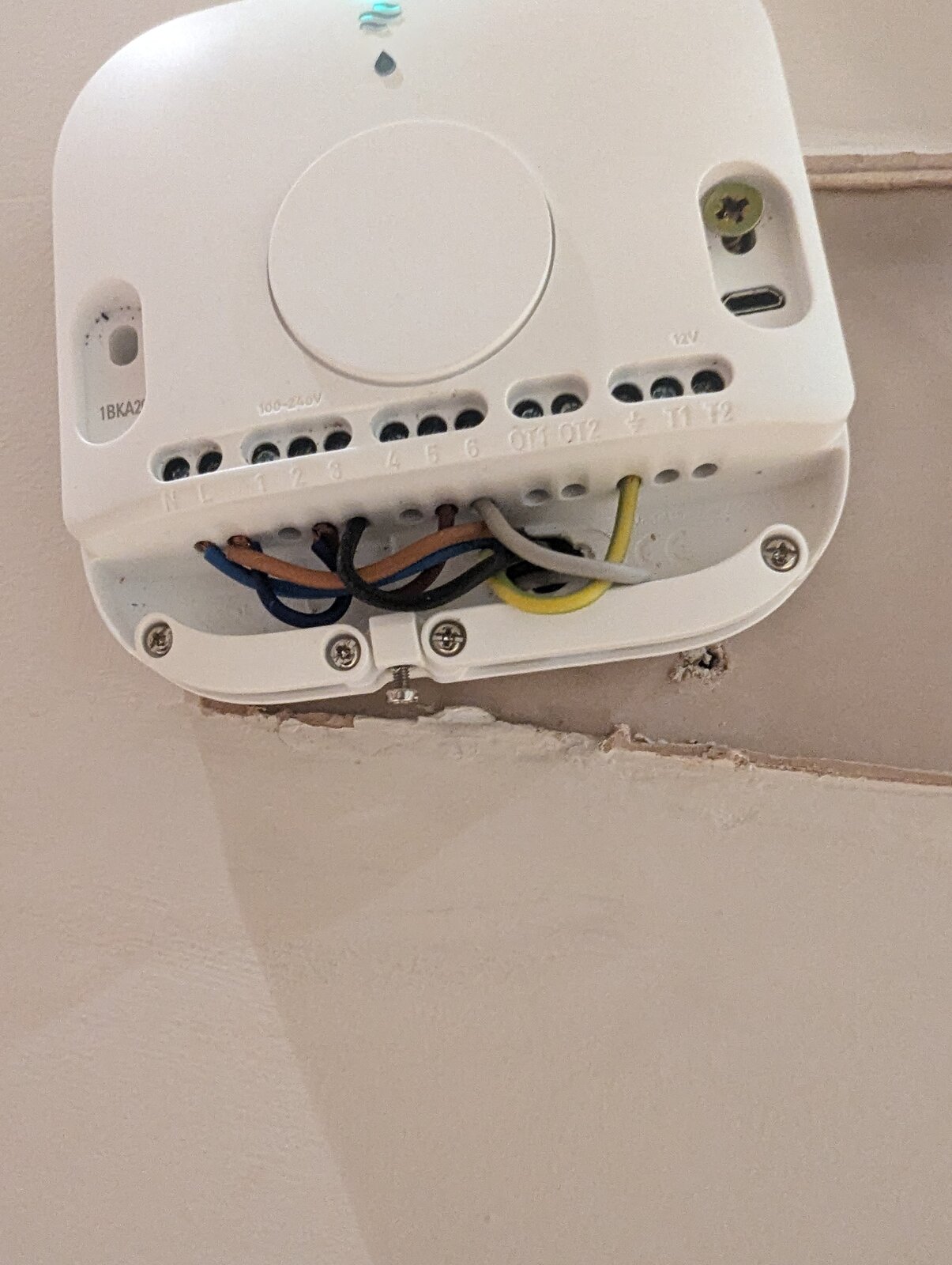

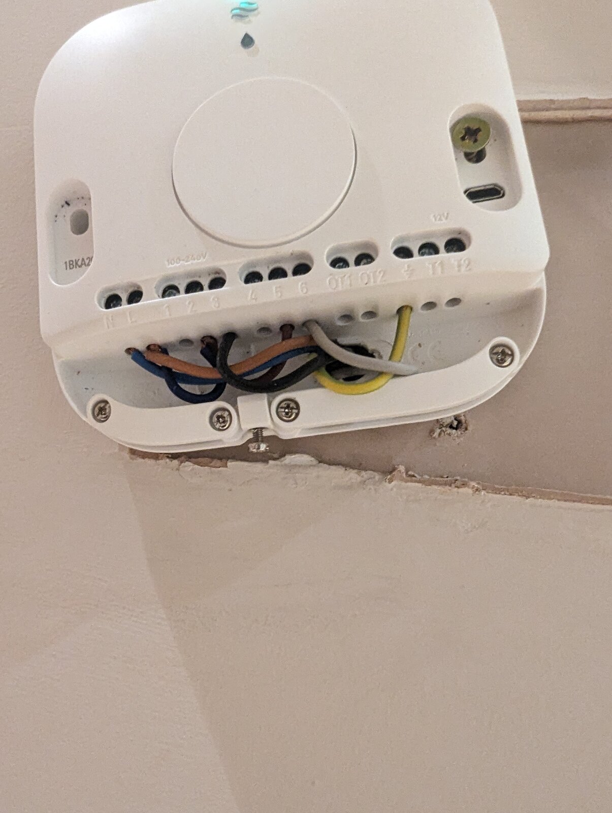

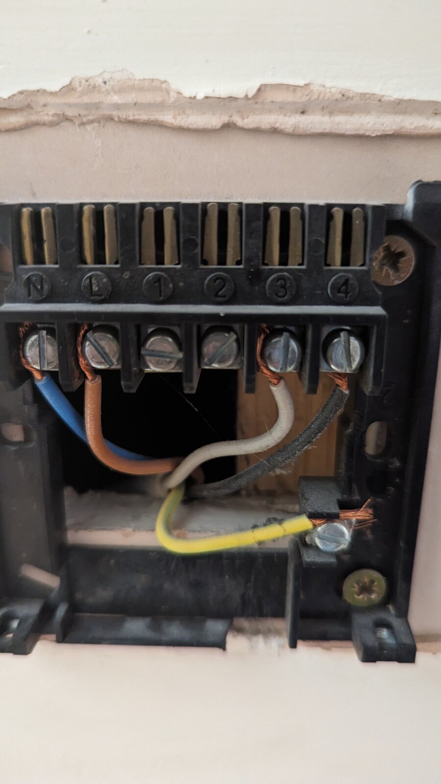

Below is the picture of wiring of UP2 (black) and the nest heat link wiring I have done. Hope these are done correctly and is not the reason of the issue I'm facing.
