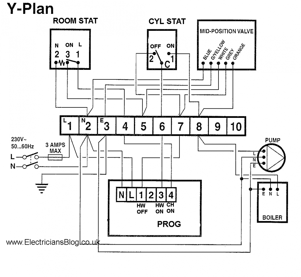

Another thing that is really confusing me as I done a bit of research online tonight. I googled YPlan wiring diagrams and studied 3 or 4 of them from different sites. They were all the same as you would expect.
On all the wiring diagrams I viewed online, the Grey wire from the Y valve is connected to the Cylinder thermostat 2 connection, and the orange wire from the Y valve is connected to the Cylinder thermostat 1 connection.

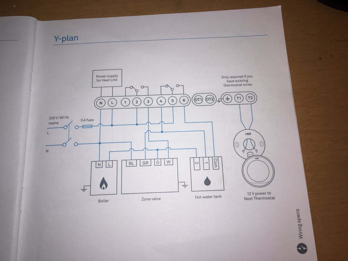

On page 25 of the nest installation guide, its the opposite!
It shows the Grey wire from the Y valve is connected to the Cylinder thermostat 1 connection, and the orange wire from the Y valve is connected to the Cylinder thermostat 2 connection!!
See below photos as an example.
Which is correct? I would have presumed if the manual was wrong it would have been highlighted here, but by the same token, all the online wiring diagrams conflict with the Nest instructions re these terminals.
Its important because it asks for the grey wire from the Plan valve to be connected to terminal 4 on the heatsink. But Im unsure whether that Grey wire should also be connected to terminal 1 or 2 on the Cylinder thermostat.
I can't check my own system until tomorrow night, but thought I would ask re these two issues for your thoughts and opinions in the meantime.
