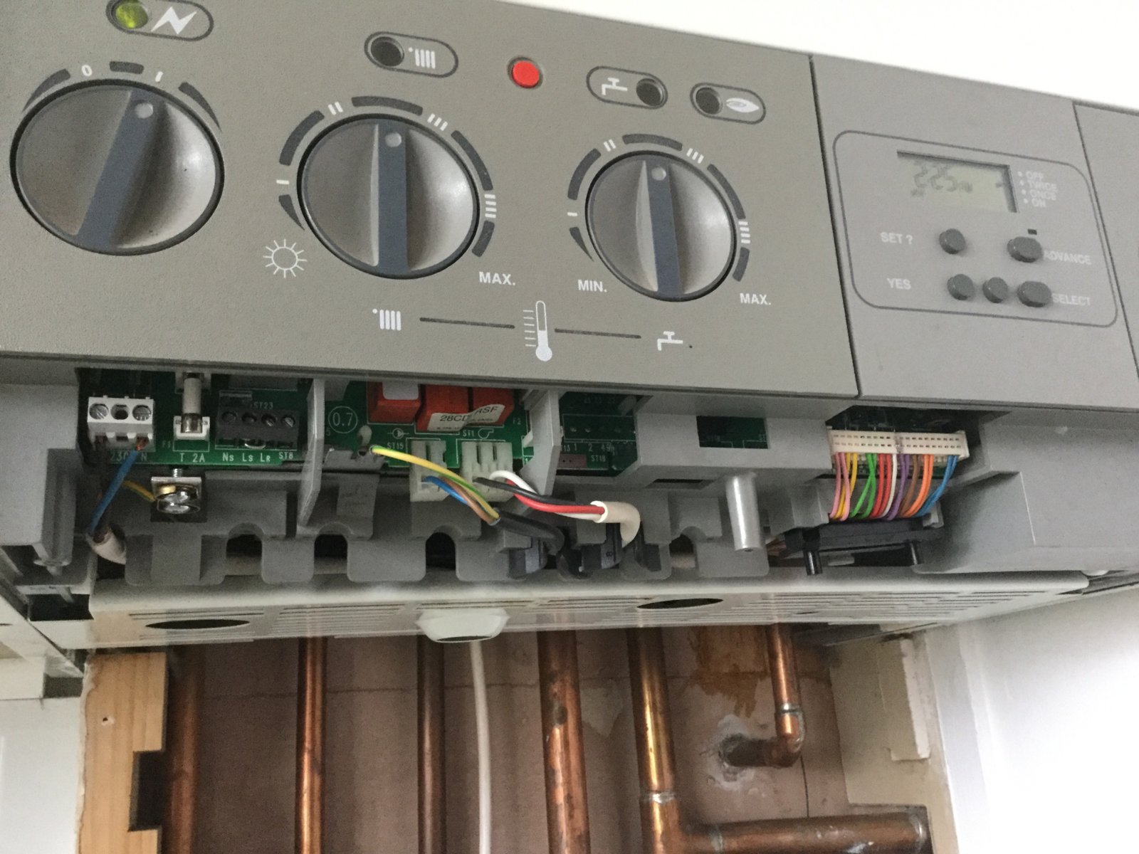

looking to instal a nest thermostat to my Worcester 28cdi boiler, I have no other thermostats connected just have a digital timer.
Do anyone have any photos or wiring diagram to help me out.

Thanks stem, I have searched but unfortunately can not find anyone that has wired up to my specific model.
The manual I have for the WB 28 cdi shows the boiler connections as:
Which has the same terminal labelling as the example contained in the link I gave you.
Lr= Live return
Ls=Live supply
Ns=Neutral supply
How is yours different?
OK, so it's not different, three terminals marked Ns Ls & Lr
Which is the same as the original post I referred you to.
So, the wire link is removed
And the instructions to connect the Heat link are therefore also the same.
1. Ls (Ls = Live Supply) This would go to the Heat link (L), and also be linked to the 'Heating Common' (2)
2. Ns (Ns = 'Neutral Supply') so self explanatory
3. Lr ('Live Return') this goes to Heat link (3) "Heating Call for Heat"
4. Earth to earth as applicable.
Should I just leave the LCD timer connected or disconnect it
As it's an integral part of the boiler it will need to be left in place but set to be permanently 'on' 24/7 otherwise it will interfere with the operation of the Nest.
