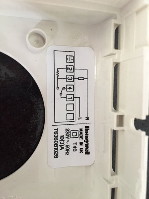

I have recently purchased a 3rd gen nest to replace my timer and hopefully room thermostat. I have everything working well thanks to some very useful posts on this site but now I am moving onto the room thermostat replacement and am getting stuck.
Here is what i currently have:
The problem that I have is how do I replace the room thermo with the nest thermo? I understand that the T1 and T2 should be used to power it up but what do I do about my 3-3 connection? Should I just remove it? Here is the diagram on the current thermo...
Anyone with any ideas? At the moment I have it all working providing the thermo is constantly set to always on, not ideal!

That's it! I only have a heating on and a common for heating. So if I jumper the 3 to live it could work? Is that what you are saying? Thanks, Ben

Ben,
Is it an S Plan or Y Plan connection you are doing (or other)?
In either event, first thing to do is connect two cables between T1 and T2 on the heatlink and the Nest stat. (any way round , it doesn't matter). I would suggest using the L and N cable from your diagram. Connect to the Nest at your thermostat connection using the 2 screwed connection points. At the Heatlink, just move L and N over to the T1 and T2 terminals. That will provide 12v to the Nest stat.
The 3rd cable at the nest side can be taped up or terminated as you won't need it there. Then connect "3" at the heatlink to either the white wire on your Zone valve (for Y Plan connection) or the BW wire on your heating valve (for S Plan connection).
If you are unsure whether you need to do an S Plan or Y Plan connection, have a look at your valves at the tank. If you only have one running to the junction box, it is a zone valve shared between heating and hot water (Y Plan), if you have 2 or more valves (i.e. one for hot water, one for heating and possibly even 2 or more for heating) then it is an S Plan connection you do.
Be careful, once all wired double check the nest connection to T1 and T2 as it only takes 12v to power the nest. If you power it to L and N you will destroy it.

Thanks for the responses everyone. Paul, I will go and check the Y or S settings tonight and see if I can see any of those colour wires. Totally understand the 12v connection to the Nest stat but for the moment I am connecting via USB to rule that out. Once I have it all working then I will connect it up to T1 and T2 over 12v.
