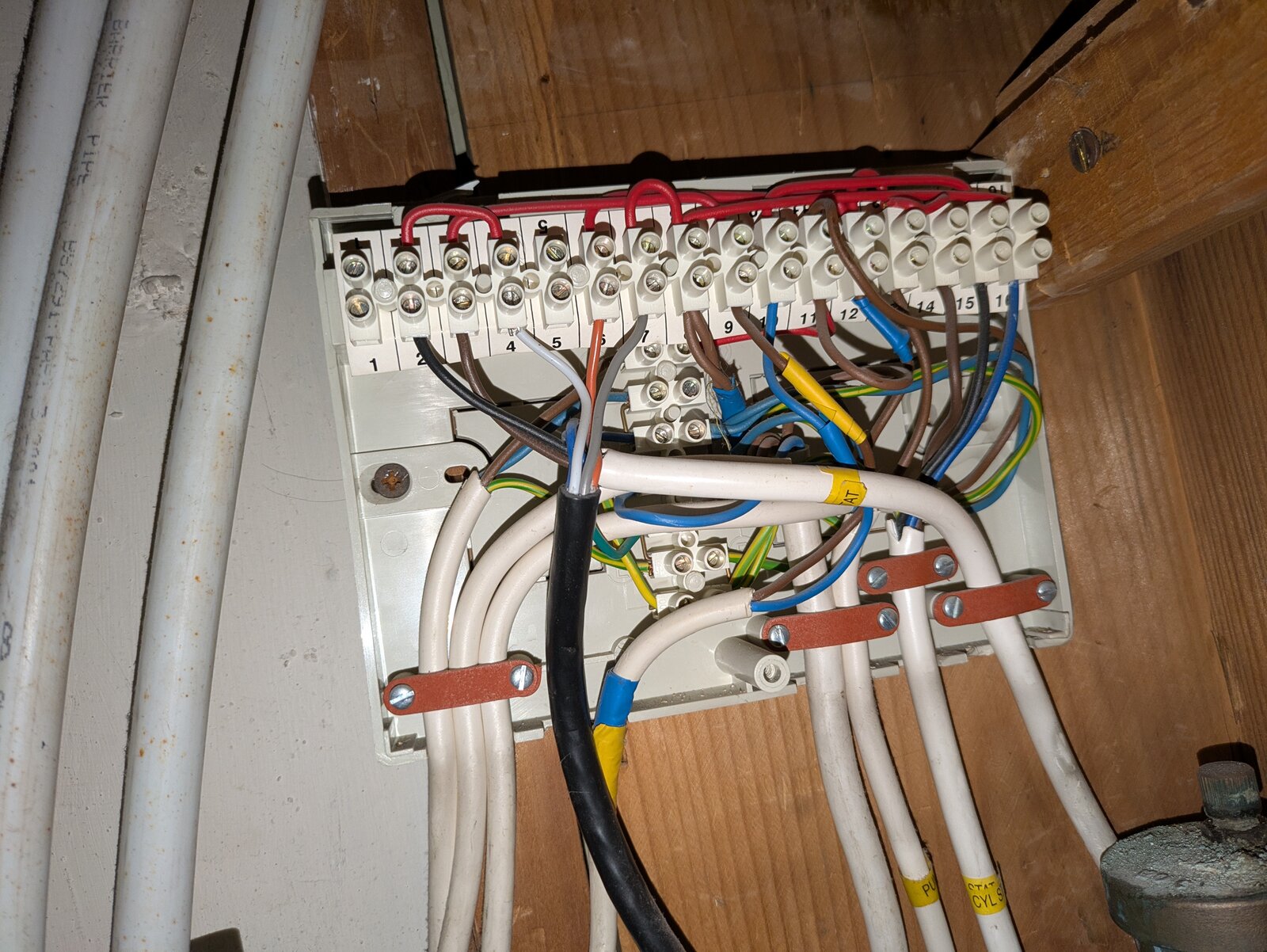

Well I have a wiring centre in my airing cupboard, and I think (unless im sorely mistaken from following wires around the house) that my existing honeywell thermostat from the 1980s is wired into that centre.
So in theory... I'm wondering if I can wire the relay into the wiring centre, to perform the call for heat.

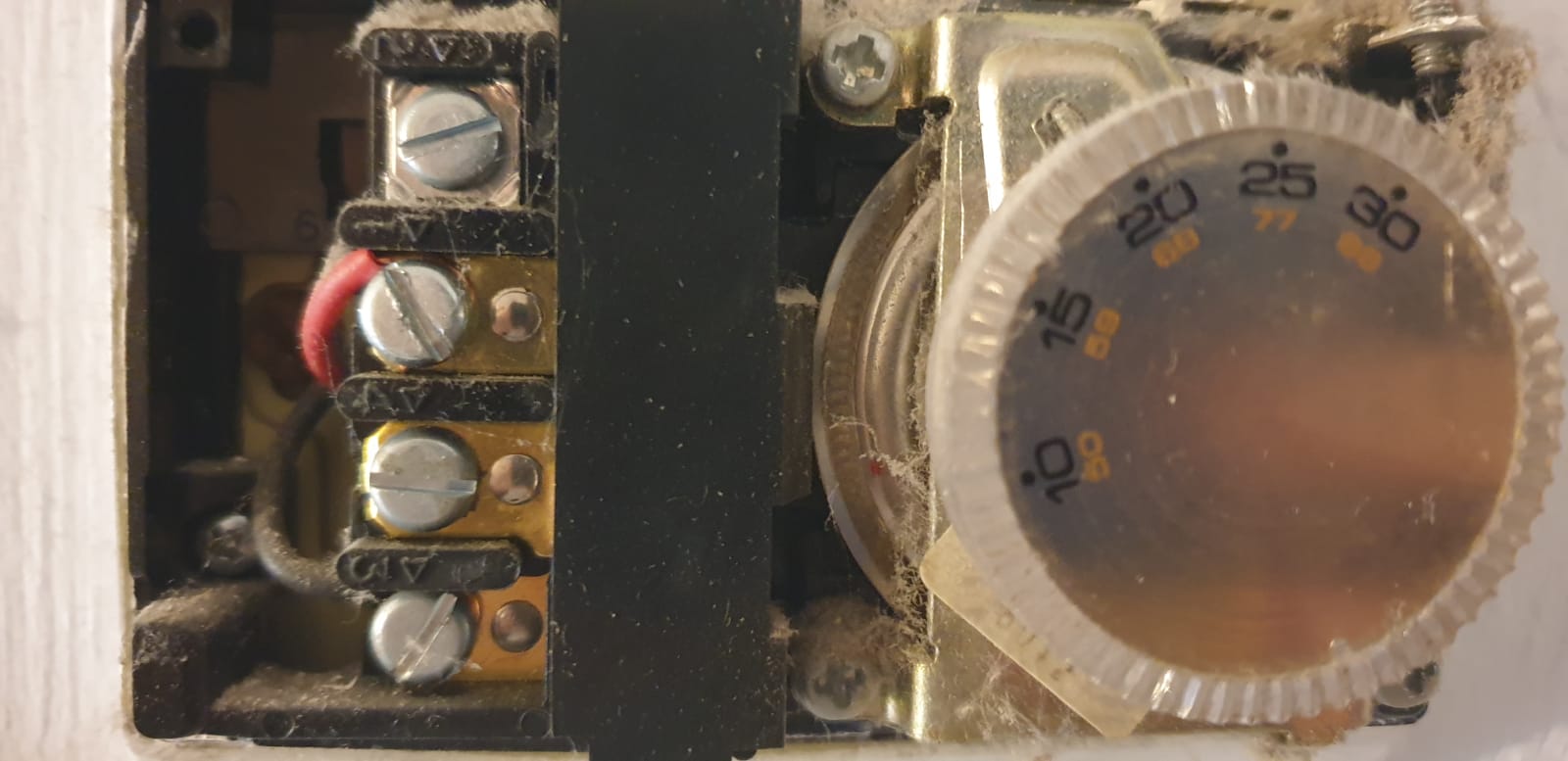

I have a red wire going to terminal 1 and a black going to terminal 3

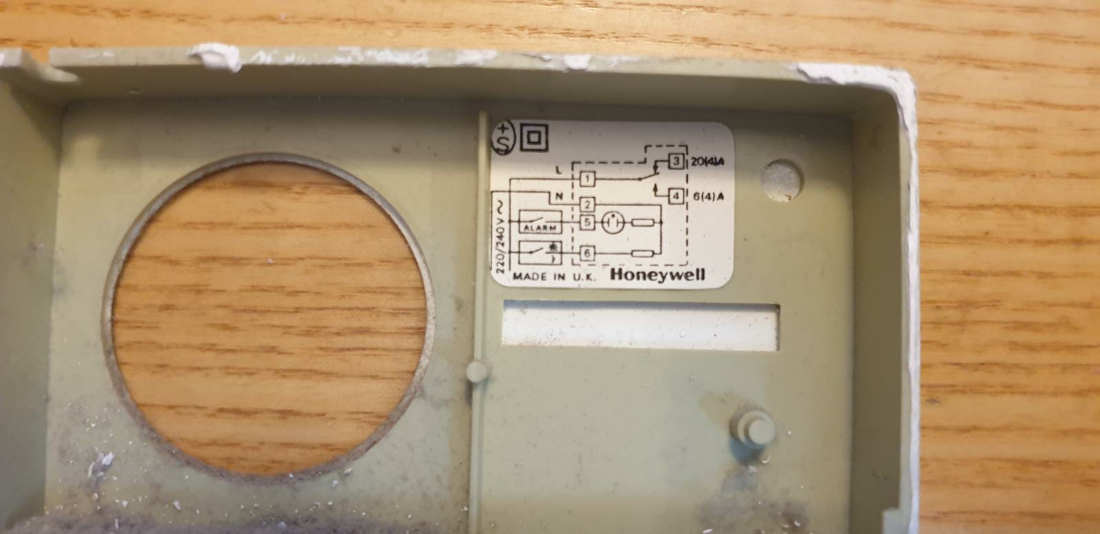

According to the following diagram that is:
basically wired across a switch. Thermostat connects (or maybe breaks the connection) terminal 1 and 3 together = call for heat.
So looking at the wiring centre where that black and red wire goes...

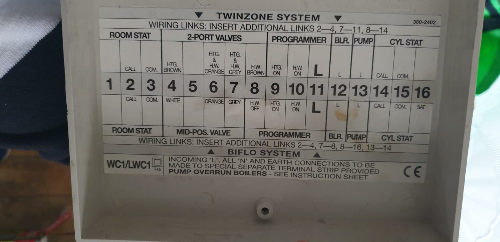

I have not a f.... clue. So lets check out the diagram inside the wiring centre to try and get some idea where that wiring would go?
I think... it should go to 2 and 3? am I right?
Any ideas?
Then I've got to workout how to wire this thing up to that box.
I assume Brown and Blue are for Live and Neutral (so i'd just wire it into the vertical terminal block?) and the black and grey are for the switching so would be terminals 2 and 3?
Any ideas?
