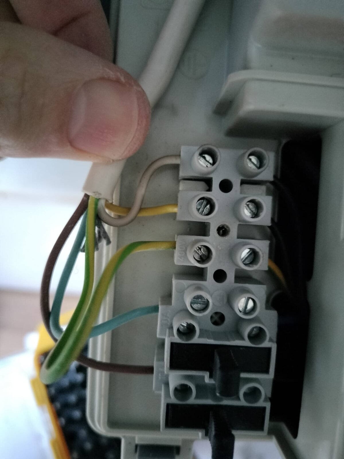

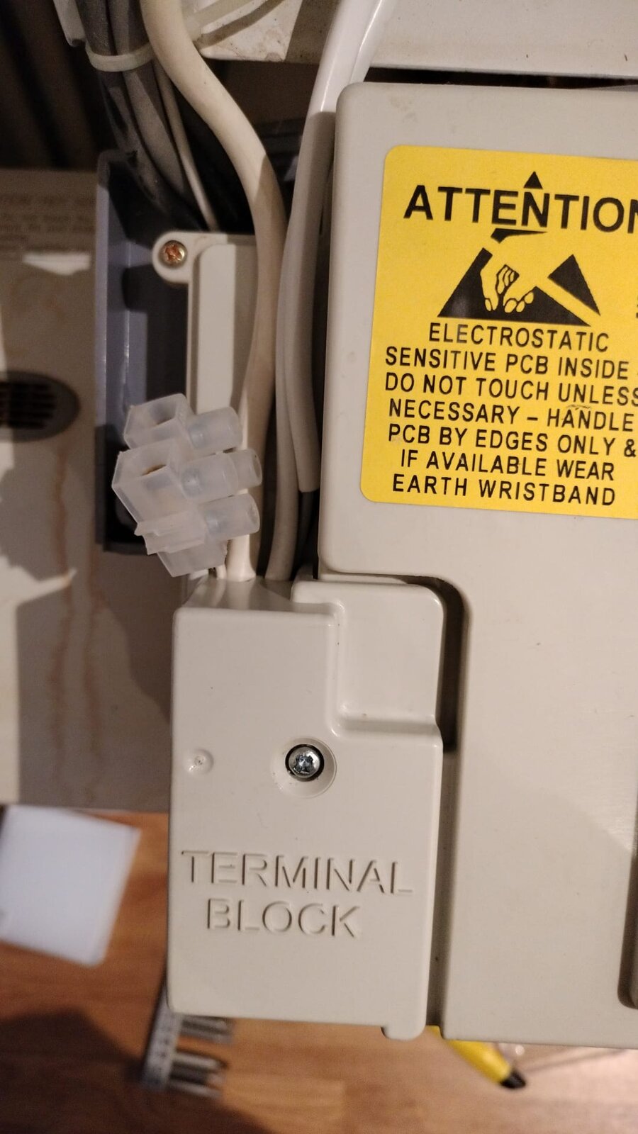

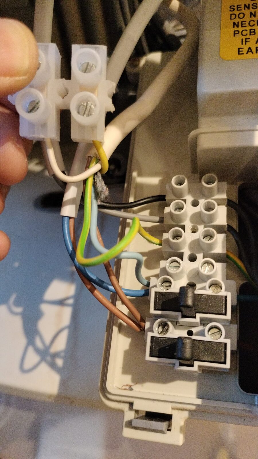

Thank you, you're absolutely right - I hadn't realised the power came through that wiring too. I can easily add the Netatmo wires into the block, and presumably I then need to remove the old stat or disable it.

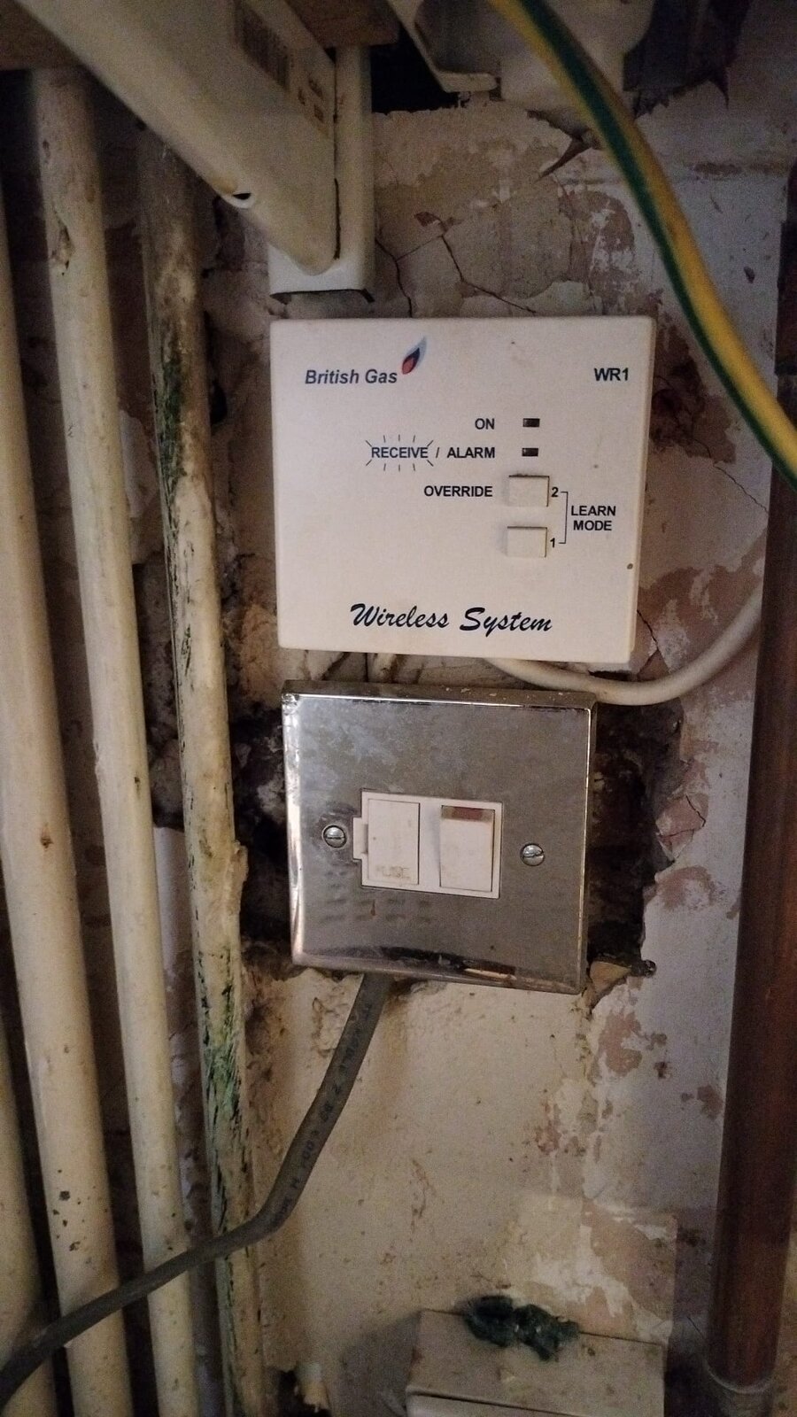

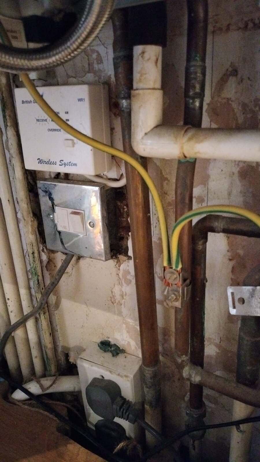

Here are a couple of photos, one showing the power and the stat, the second showing some earthing wiring.
You could do, but as it is only a receiver, and it's out of the way, there's no real need to do much about it, as long as you take...
The grey and yellow wires currently in terminals 1 and 2, would be removed and safely isolated in a separate terminal block.
If you want to explore further, it appears that the flex is daisy chained from the FCU and through the BG receiver; having a look at the wiring behind there (with power safely isolated) may show us what's going on.

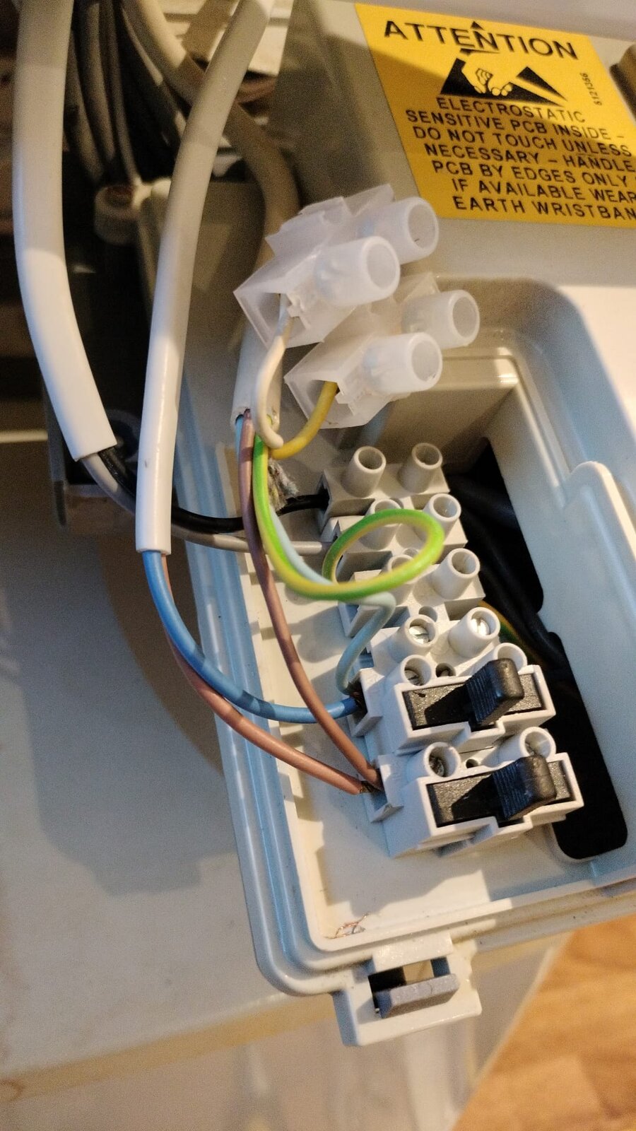

Thank you so much. I have wired up as you said (see below) and it all seems to be working. Can you confirm this is what you meant about isolating in a separate terminal block, and would you consider this safely done? They wouldn't fit in the area labelled terminal block, so the two wires are sticking out of there as you can see in the last photo.
Well done, that's a good job :)
Yes, that's perfect.
These wires shouldn't be carrying any voltage; we just want to ensure they are left in a way that it's improbable for them to touch any other wires, or components.
