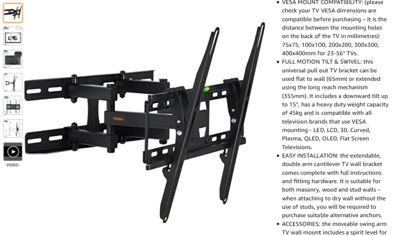

Your wall bracket should be a full motion job something like this, but a version suitable for the size of screen you're hanging. This solves the cable access issue because the screen can be pulled forward when required.
If any of this is going to prove to be too big a thing to tackle then stand mounting is your friend.
