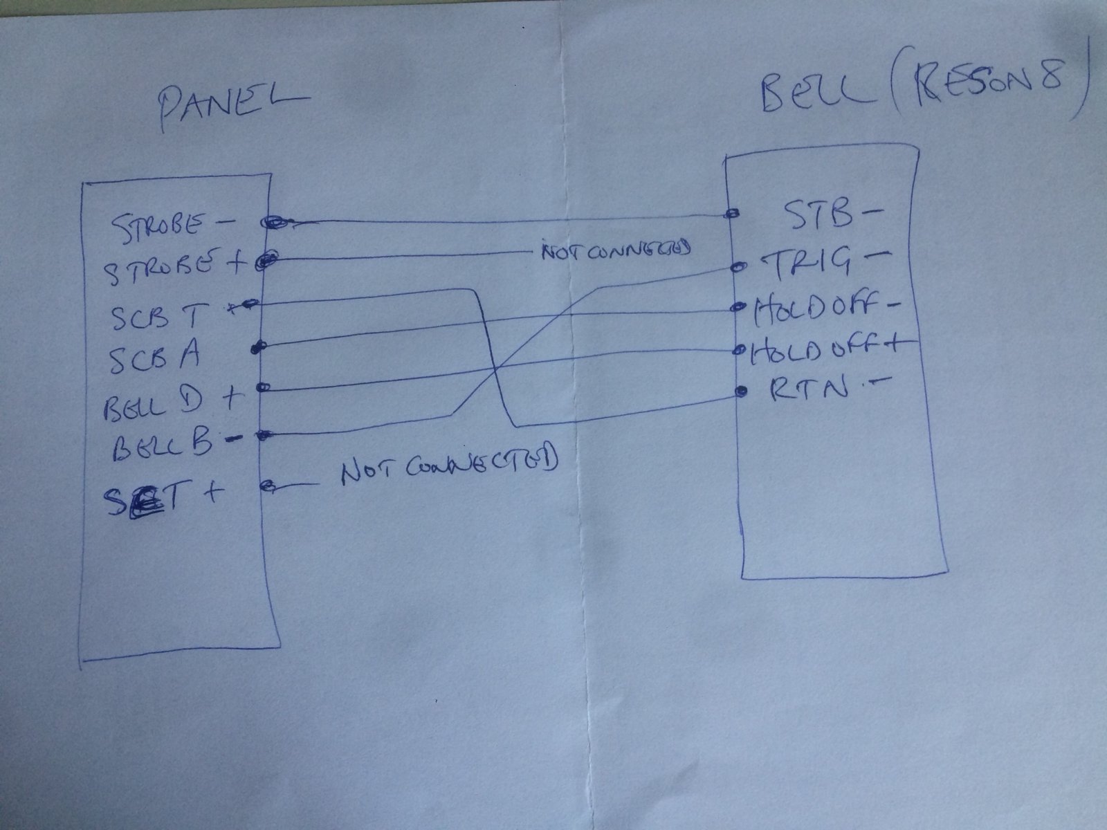

Hi all, i have an Accenta G3 alarm system. Ive just changed the siren from an old Sonade 2000 to a Reson8. Ive checked the connections which i believe are correct, but its not working. When i connected the siren battery i got a short bleep confirming that was ok, but apart from that nothing happens. Ive tried a test and the keypad sounder goes but not the siren or strobe. The LED's don't appear to be working either. Any ideas please?

Hi, thanks for the reply, I will take some pictures, in the meantime the diagram below is how ive wired it up. I changed the bell as the original was about 10 years old and had rust on some of the components, plus the strobe had stopped working some while ago.

well your diagram suggest you have done it correctly, need a multi meter to check your have power unless the bell bix ?
you can take the bell trigger wire to the -ve hold off in the panel.
strongly suggest if your are struggling to use a short cable directly to the panel and get it right before you put it back up, at least then you know its working.
