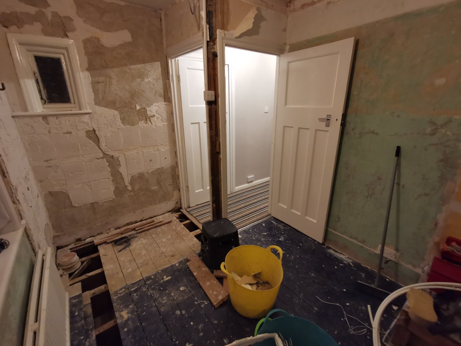

View from hallway, in the far right corner there was a toilet and there is still the cast iron soil stack, now temporarily capped off.
Looking out into hallway, previous and future toilet on the left.

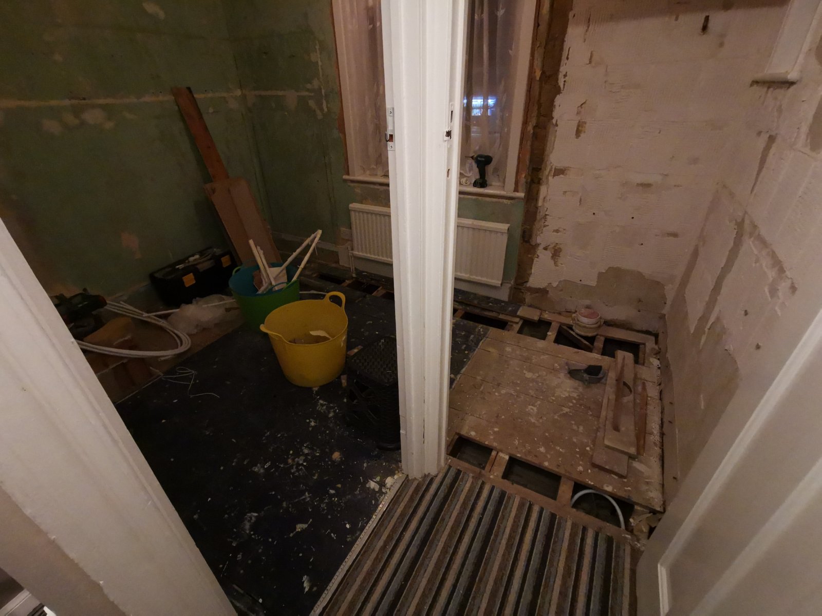

My list of 'demolitions' includes (no particular order);
  1. Getting the radiator out,
  2. removing the two sockets (one is a spur so I can do, the second might be better done by a sparky).
  3. Replacing the single glazed tiny window with fixed obscured glass.
  4. Replacing the main window panes with obscured glass
  5. Taking out the door on the right of the first image and rebuilding as a stud wall.
  6. Probably rebuilding the other door as well
  7. Tracing and removing a wire that wanders through the floor from the cavity wall cavity (removing is going to be a job for aforementioned sparky)
At that point I think it'll be more or less fully cleared. Before I put anything in I'll definitely need plans, for me and for BCO (if they need to be involved)

its not clear what fixtures are going in? what size plastic pipe is that?
the little window could be bricked up with an extractor fitted?
is the outside rendered?
any signs of dampness in any outside walls?
all redundant pipes and cables should, if possible, be removed.
if you remove the "post" and square the room then what, if anything, is going to need supporting in the ceiling joists?
is the main window DG?
Sink, toilet, L shaped bath. Exact details tbc (plans!)
That roll laying about is some 15mm stuff that was previously run through the loft to provide cold water. The hot water comes in under the floor, just for consistency. It probably won't be reused for this job but I'm sure I can find a use for it somewhere else. The soil stack is 110mm.

you've got massive room for fixtures.
15mm is to be avoided - go for min 22mm.

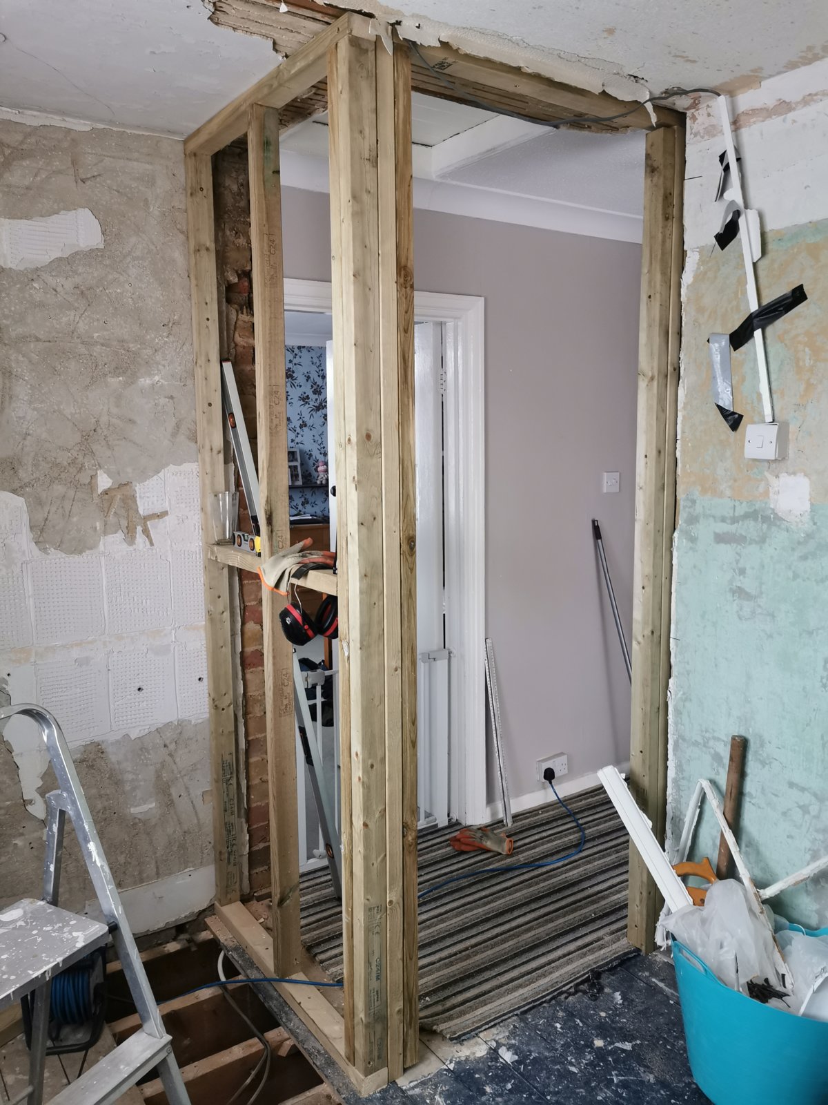

Well, continuing my failure to plan I've stripped out the old door way and built a new stud wall.
BCO was out because of a different bit of work and they confirmed that the walls weren't structural and didn't object to any of the intentions. The direction and routing of wastes was discussed and I really need to work those out soon.

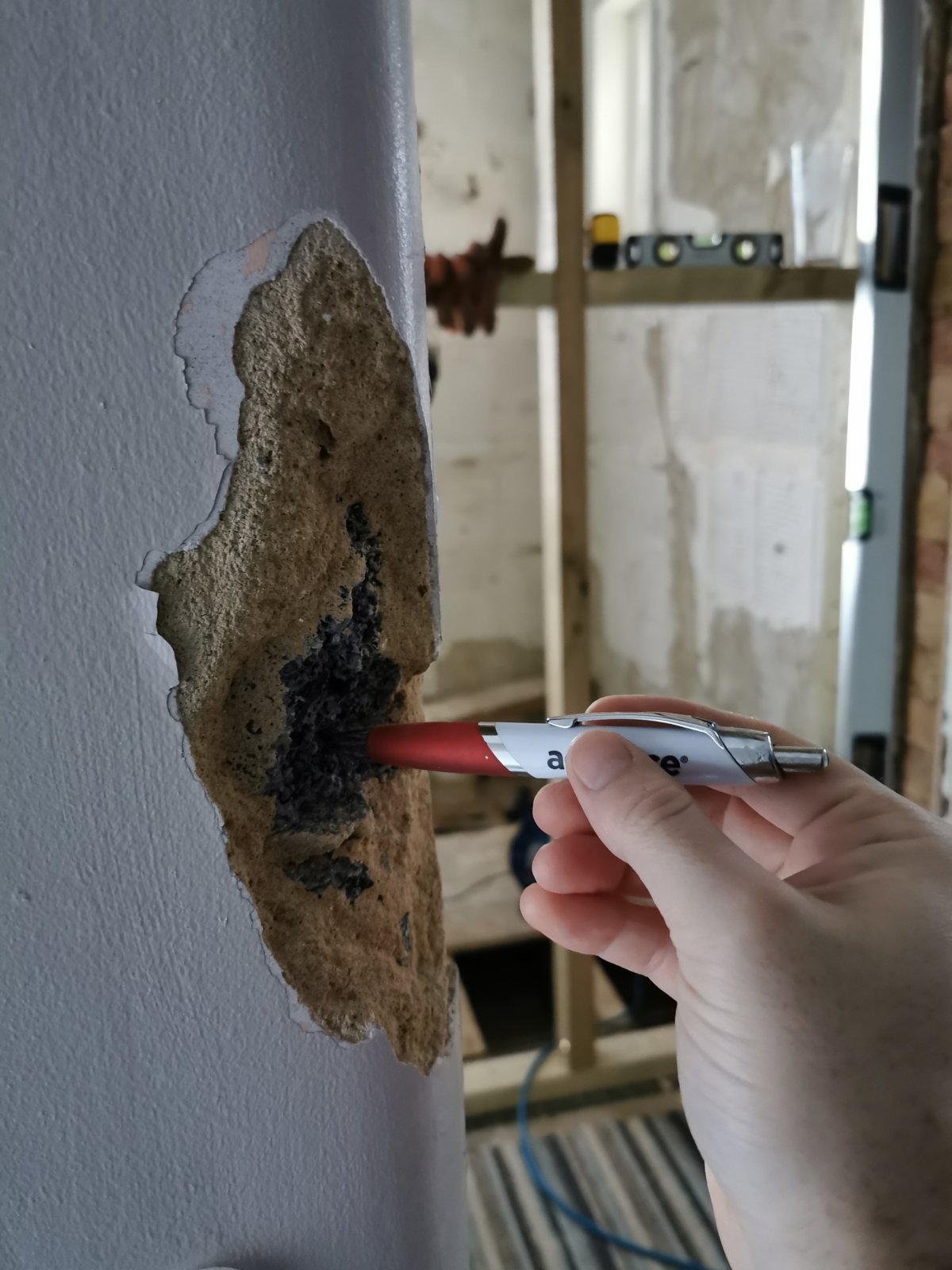

I've also knocked a nice big chunk out of ain internal cinder block wall. Any suggestions on how to patch this crater?
Have a read of the Approved Documents to get a feel of what is acceptable and what isn't for drainage. You don't have to follow them slavishly but if you can your work will be deemed to comply to the regs. Our BCOs up here don't like cowboys but they do like people who have at least read the books and present them with problems like 'here's what I want to achieve but I can't do exactly what the ADs suggest due to (all sorts of old house issues). I can do this, or I can do this, which will comply if any'. They've all come back with sensible compromises & in some cases much better (cheaper and easier) ways of getting round the issues then I had come up with.
Don't worry about that hole in the wall til you've finished attacking the place- several goes of filler or a couple of goes of plaster, sand back to match. Has anyone mentioned the A word with that slightly textured wall finish in there?
I think the bit you mean is the old tile adhesive. The rest is fairly smooth plaster.
No, I was looking at the wall finish around the divot on the corner (the pic where you have a pen stuck in the hole). It isn't full Artex so probably not hazardous but worth thinking about.

I thought the hole was old cinder block topped with binding plaster, then a layer of skin and paint.
