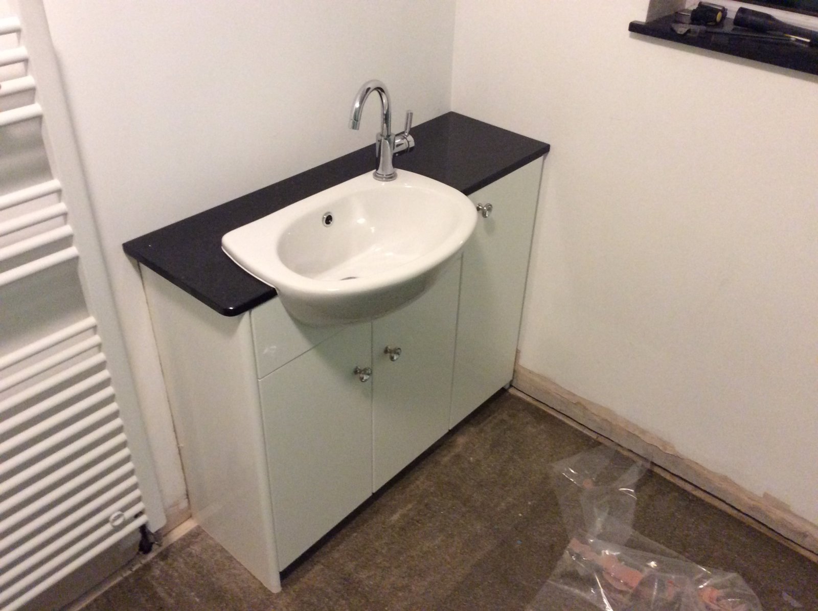

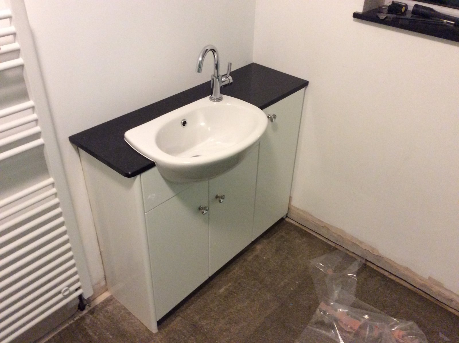

Ive just done the opposite as I wanted narrower which I made from a wall unit
Yes I did think that, and it may yet end up being done that way. Only possible complication is routing the waste.
Nice job in the pic
