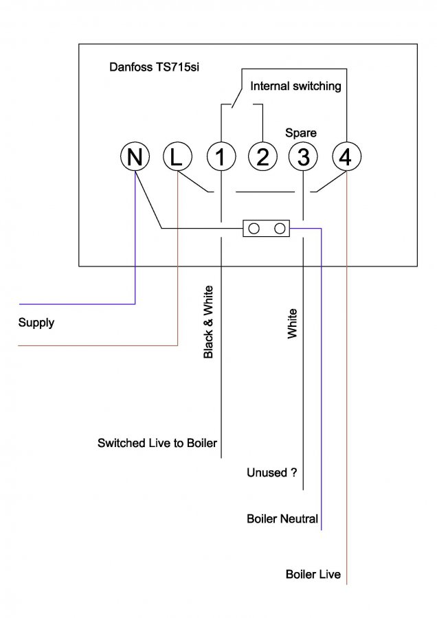

The SM300 didn't use terminals 2 and 3 for anything, so they were just be used as connectors for the wires inserted into them. The TS715 does use terminal 2 (although you won't need it) so do not make any connection to it. If you do, you may cause a short circuit. Just connect the wires that did go to terminal 2 together with a screw terminal connector. [No need for this if my drawing below is correct and the N wire from the boiler is long enough to reach the N terminal of the timeswitch]
There was no real need to swap over the wiring between termianls 1 and 4 they are just a switch. When the time switch is 'on' the two terminals are simply connected together, either way around would be fine.
This is what I would expect to find, it excludes the black & white wire that you say used to go from terminal 1 of the SM 300 that goes to the power switch because this is a puzzle to me. What is it connected to at the power switch?
As you haven't given details of the wiring at the boiler end, I have made assumptions based on where you say they went at the SM300, so please check they do go where I have assumed before making any connections.
I also assume that the pump is controlled by the Suprima. If so, you may have pumped hot water and heating, as when the boiler is 'on' the pump will also be 'on'. Can you confirm how the pump is wired?

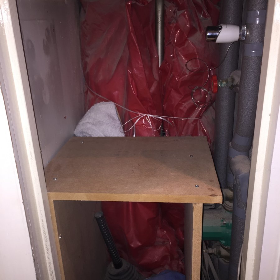

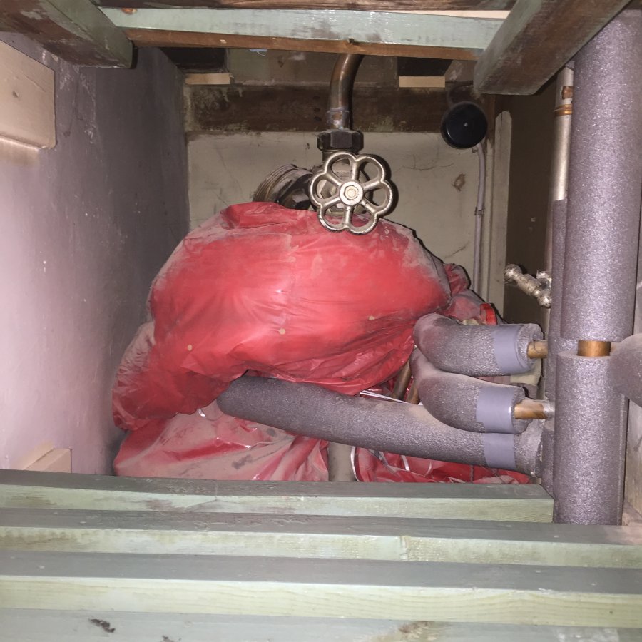

Hi stem,
I have attached pictures of my (rather dusty) siting cupboard which shows the pump at bottom right and the old school valves.
I will have to wait till tomorrow to turn the power off and check the wiring at the boiler end but thought the attached might help you envisage the setup at least.
Thank you and I'll be in touch soon.
Hi Tom
Sorry for slow reply, I've been on holiday in Cuba where the internet is poor / non existent.
Looking at your photographs, although I can't follow all of the pipes fully, it does look like a fully pumped system, so the pump will probably controlled directly from the boiler. So, if my assumptions for the wiring at the boiler end as shown on my diagram are correct, then you should have everything you need, if not, post back what you do have.
