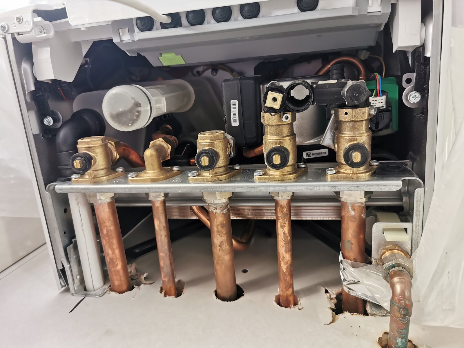

30kW will be more than enough to run your heating unless you live in a mansion, but if you're expecting it to be able to heat enough water to run two showers at the same time you're going to be very very disappointed. Unfortunately, as you've supplied the boiler yourself, your installer has no responsibility for it not meeting the performance you're hoping for, beyond correcting any installation faults that might exist. It looks like a decent installation from the photos provided though.
