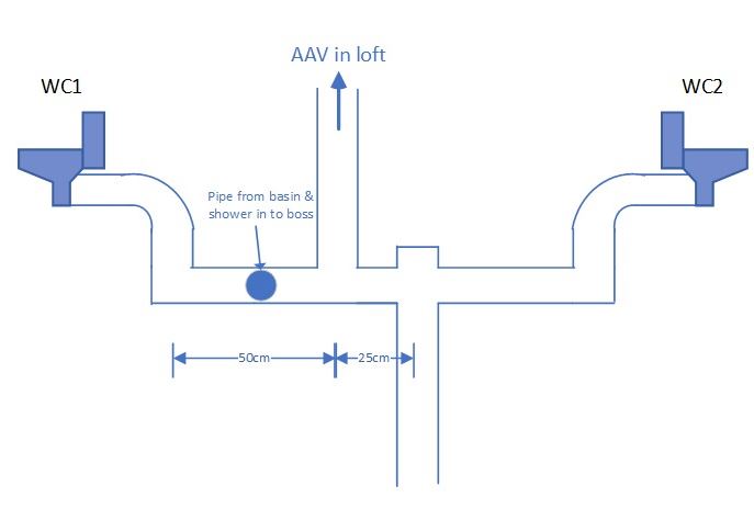

I'm looking to relocate a toilet in an ensuite. This ensuite is adjacent to and shares a soil pipe with another ensuite.
Current soil pipe setup is thus. WC2 is the one being moved.

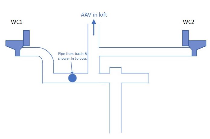

Would connecting WC2 into what is currently the dry part of the stack as per diagram below be okay and would it comply with building regulations (I suspect it would contravene the regs regarding soil pipe offset)? Pipework from new position of WC2 to the stack is about 1.5m and includes a single 90degree horizontal bend. Sufficient fall will be maintained.
Cheers
Not an issue with that with, as you say, the correct fall.
