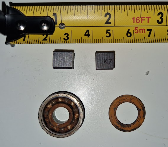

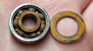

I have a Mira Elite QT electric shower and while it's working fine there is noise coming from it that doesn't sound too healthy.
As you can hear from the below video there is a loud screech when the shower is turned on
I had a look at the brushes and while there is a fair bit of use I don't think the sound is coming from having shorter brushes.
I think it might be the bearings rather than the brushes which would mean a new pump.
I'm debating on should I replace the brushes to see if it makes a difference or should I go for a new pump but if I'm replacing the pump should I just spend more to get a new shower which is like for like?

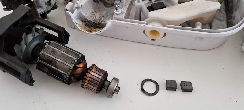

I still have the old shower as I want to open up the motor to see if I was right about the noise was coming from the bearings inside the motor. I still haven't done that yet as I don't know how to remove an elbow clip without breaking it (though I guess at this point it doesn't matter). I might try it again at the weekend.

Not sure if QT means quiet or not but it wasn't brushless. The SE version is brushless (see photo below) and is a lot quieter than the QT even before it started having an unhealthy sound. The QT I had was from 2016 so was only 8-9 years old which is still a good lifespan. I did have a debate about switching to Triton but as the layout is different I was afraid of the can of worms that it would open as I don't have a lot of room to play with and the current layout is covering broken tiles as you can see from below.

Well, some interesting developments. I received new brushes - they were 0.5 cm longer than the existing ones, so I suppose they had actually worn down quite a bit. I replaced them last night, and the shower sounded a lot quieter. I proudly showed my wife that yes, I COULD actually fix stuff. The proofs in the pudding, she said, saying she would try it today....
This afternoon, whilst at work, I got a text: "I had a shower. It blew up. We've got no electricity".
I wisely made sure that the first thing in my reply was querying her safety (I would never have heard the last of it had I not), and only then asked the details of what had happened. It hadn't, in fact, "blown up", but it had started making the loud noises again, this time accompanied by smoke coming from the top of the unit, followed by it coming to a sudden stop. Sensibly, she had got out of the shower pronto.
Looking at it tonight, apart from the burning smell, I can't see anything wrong. None of the wires looks burnt through, and there is no water in the case.
