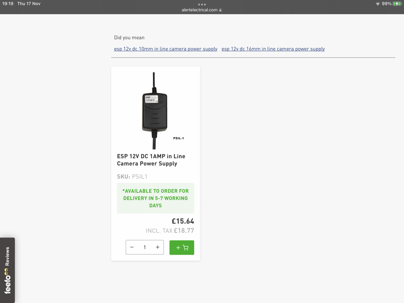

Do you have an recommendations on the type of 12v transformer I can use?
I've fitted Bell transformer before, which I believe was 12v.
Example ….1 amp is ample ….
