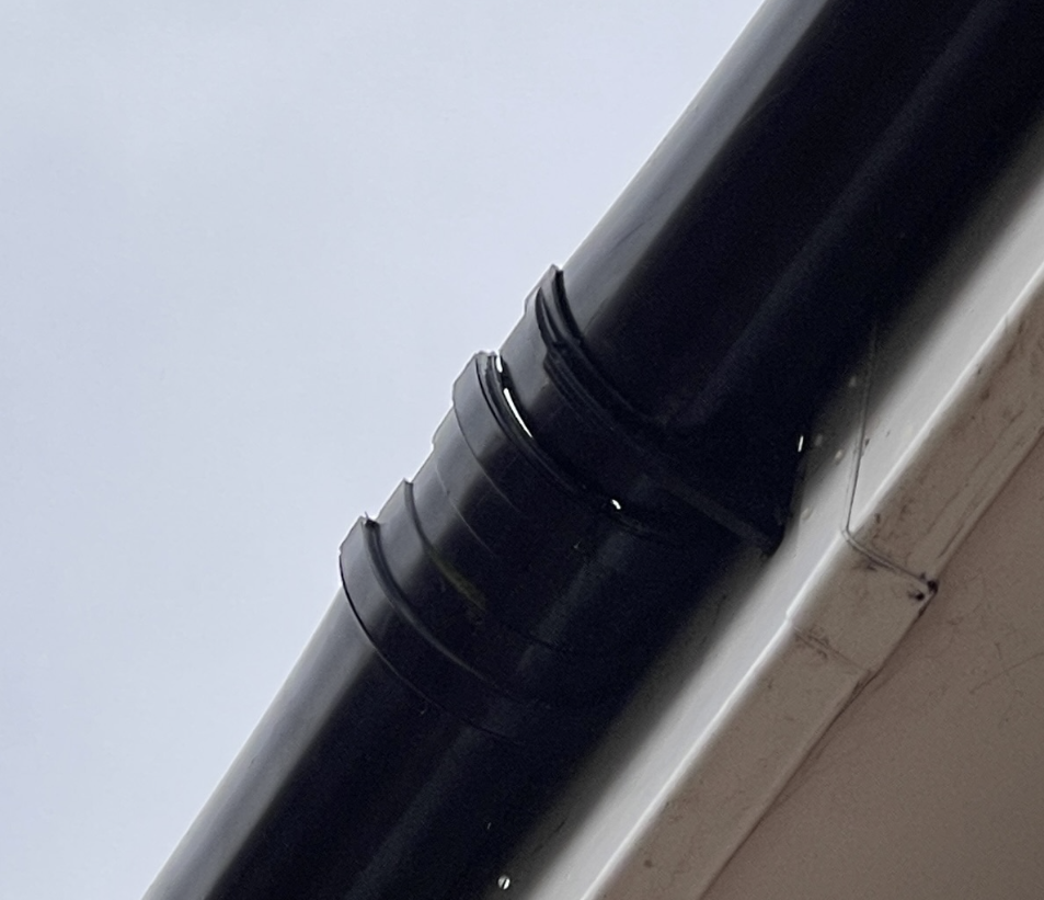

My house is 5 years old so almost still a new buildo_O.
I have had quite a few issues with the gutters and roof. Leaking gutters and tiles flying off of the roof. Several issues have been dealt with by the builder through snagging in the past.
The latest saga is the gutters front and back are leaking in exactly the same area - right between my house and my neighbour's. I am on the right, end of terrace, they are to the left. The gutter keeps moving off sligtly in their direction which is creating a gap and water absoloutely pours through when it rains. The neighbours don't seem bothered by it but I am as it is messing up the flower beds and makes the walls so dirty and moist outside.
My friend is a broadband engineer so had a large ladder. We climbed up and he re attached the gutters where they have come appart - the fitting clamps to the two parts of the gutter together, a week later and warm weather, both front and back have come appart again, exactly in the same places. I am convinced this is a heat issue and the black of the plastic is heating and then cooling overnight which is causing this problem.
Can anyone suggest what can be done long term?
I contacted the builders who tell me as usual, it is not covered under warranty. It has not been right since day I moved in and several parts had been installed back to front on the down pipes which is making me wonder if there is further incorrect installation here.
You may find the gutter has expanded in the sunshine and moved it’s entire length, so head back to a corner and start from there.
I found with mine - which were forever parting- a self tapping screw kept them in check but of course they do need to expand somewhere so allow for that.
John
As per @cross thread looks short. Is there “play” on the other side? If yes, remove the bracket and move the union up and fit the bracket further back. If no, then you’ll have to add a bit of guttering or additional union.

the gutter needs to be cut as per the marks on the union -it should leave enough gap for expansion but only enough that if the gutter works it way to one side, the other side still goes past the rubber seal

Probably expanded in the heat and didn't creep back to where it came from .. if it's cur short slip another union in and a small screw through the union and into the fascia at one end . That way it can still expand but has to go back from where it cam from

Thanks, I got a company in, looks like they drilled the two together and siliconed it all to stop any further leaks. It has been a week and so far, no issues.
