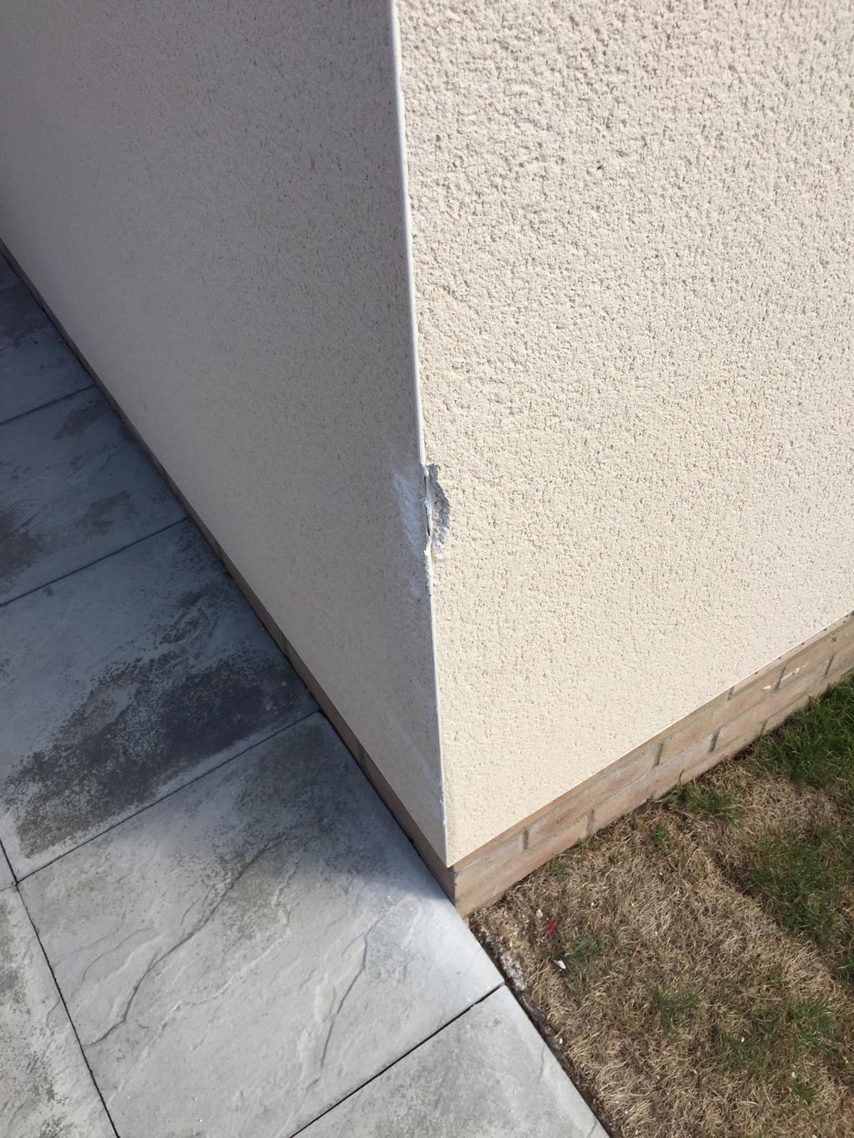

Hi
So we have a new build under 2 years old now, unfortunately my father in law reversed into the corner and of course a small chunk of both sides and the render corner, have been damaged.
Is this an easy fix with some render mix like this ->
https://www.diy.com/departments/u-can-render-repair-mortar-5kg-tub/258446_BQ.prd
How would I repair the plastic render corner?
A
Use any kind of exterior grade filler, take your time, try and blend it in and make it look right. don’t need an actual render mix as it’s such a small area, and filler is going to be more workable and stick better.
The existing render is k-rend or equivalent anyway, not sand and cement render.
A
You need to buy a length of plastic corner bead then cut a piece to fit - stick it in place with epoxy glue . Not a £ot of £
