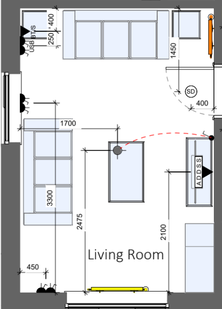

We just moved into a new build and noticed a radiator was missing from our living room (shown in orange). The plans state this is required to satisfy 2021 regulations. The developer has acknowledged the fault and has offered two solutions:
  1. Install the radiator as per the plans
  2. Upgrade the window radiator to a double that’s also larger in size
For reference, our living room is approx. 3.39m x 4.95m (11’1” x 16’3”) and doesn't have a window on the external (left) wall as shown.
Option 1 mitigates a potential cold spot, but the door will remain open most of the time, so we’re wondering if this cancels out any gain. This option also creates the most upheaval in terms of construction work.
Option 2 is easier, but I’m questioning whether a single radiator will adequately heat the room, regardless of increased size.
What would be your preference and why? Thanks in advance for your help.

If you are going to leave the door open most of the time, it's not going to be very cosy with one radiator at the other end of the room.
Get the radiator fitted and don’t leave the door open
Doing nothing is not an option
Prepare for lots of upheaval and making good
