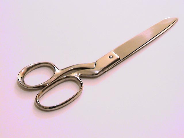

Try these.......dead cheap aswell....and your college lecturer will be satisfied.... :LOL:

hahaha, great stuff, like the idea of junior school safty scissors! :LOL: :LOL:
