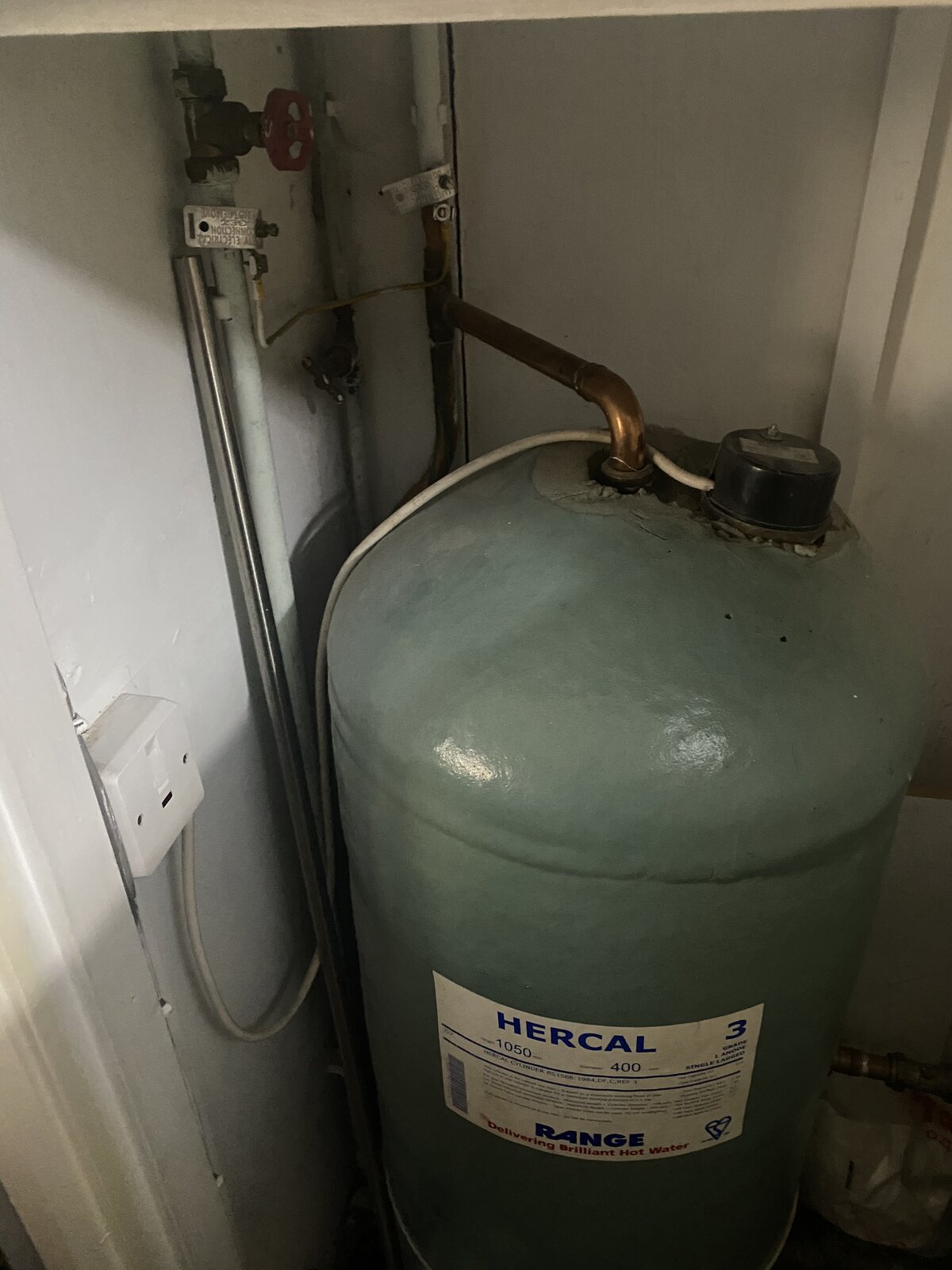

Also, could someone please tell me what this switch is for?

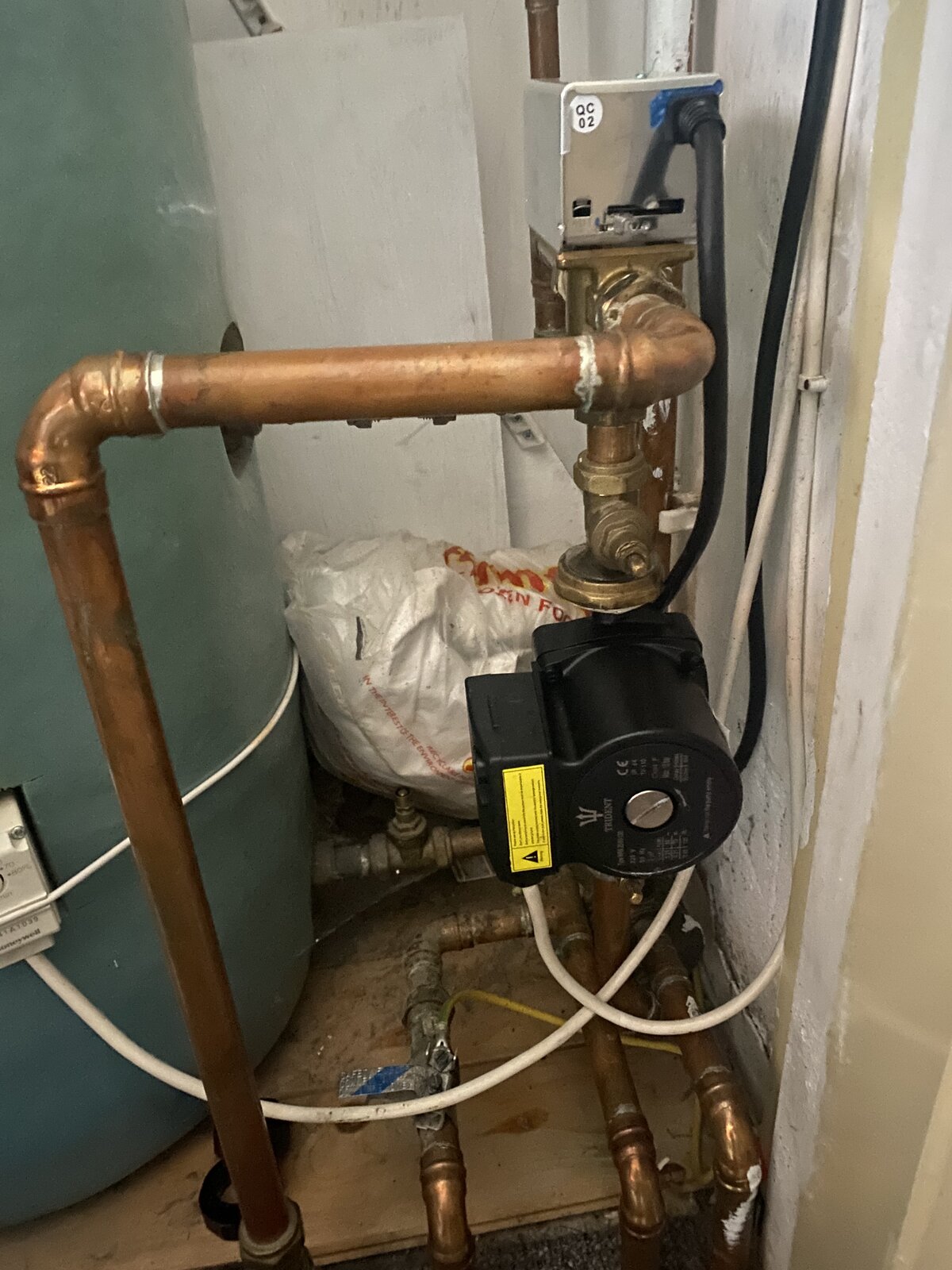

The switch is for you immersion, there is an air bleed valve upright next to the 3 port valve.
Andy
You open it to let the air out and the silver box with 3 pipes going to it is the 3 port valve.

And regarding switch for immersion, what does it do, and should it be switched on, we have never had it switched on because I don’t know what it does

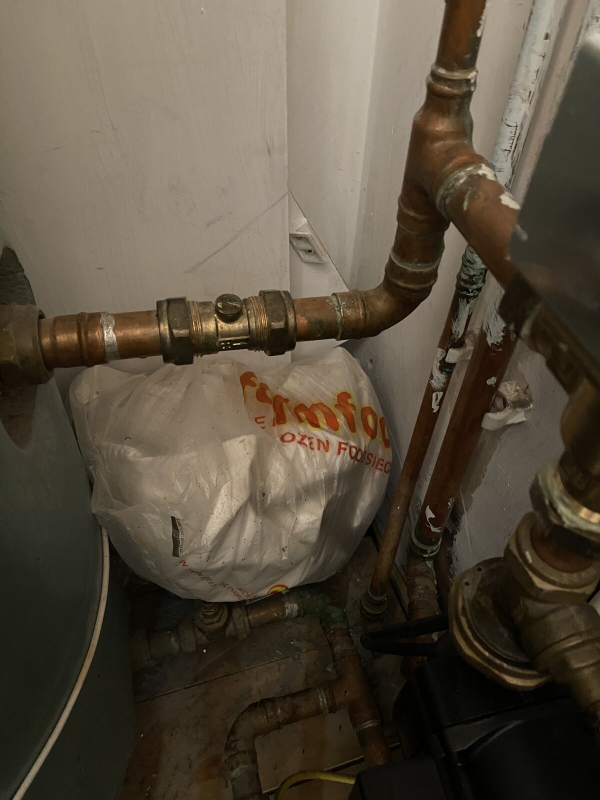

1. The manual air bleed valve is at the end of the vertical pipe in the first of your pictures above. Slacken the brass top screw with a screwdriver no more than a turn or two, and any air should hiss out. When water starts to bubble out, do the screw up again.
2. The screwdriver slot in your second picture of the horizontal pipe going into your cylinder is an isolation valve. It shouldn't be there, but leave it alone.
3. An immersion heater heats the water in the cylinder using electricity, rather than your boiler. Useful if the boiler breaks down, but expensive to run (3 to 4 times the cost of the same heating by gas). Worth turning it on with a cold cylinder just to check its working.
