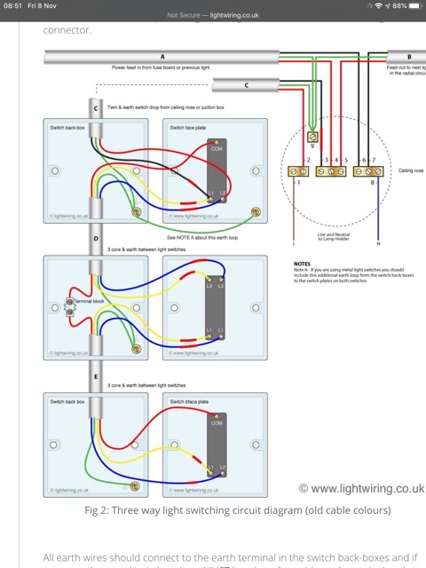

Hi all,
I’m looking to add a new circuit for a new landing light. I’ve ran a cable from the ceiling position of the light to an intermediate switch for an existing three way switch circuit. If I buy a 2 gang intermediate switch, can I run my new circuit from here? Hoping I can. Schoolboy error, didn’t pickup on the intermediate switch piece before running the cable. Thanks in advance, Chris.
intermediate switches can also be used as one-way or two-way switches.
Not quite sure what you intend to do, but you will not be able to power the new light using what is available on the existing switch.
There will (Edit - very likely) be no neutral.
Thanks. I thought there were two neutrals terminating at this switch in a block? Grr. Do I need to route the cable to another of the three switches? I have the third switch on the same floor.
Only if there are two blocks with two wires in each.
Probably not.
If there is a loft above it would probably be easier to run another cable from new light to an existing light.
... well, to some extent, you need to tell us - are there two conductors terminating in a block (but not connected to the switch) at the location of this switch and, if so, what colour are they?
A photo might help.
Mind you, even if there are neutrals at the switch location, I don't think you would be able to wire a new light from there such that it could be controlled independently of the existing lights.

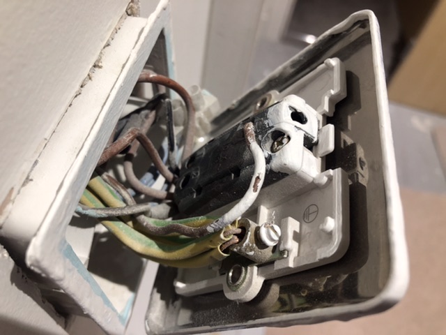

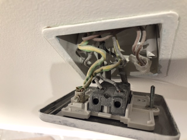

Guys, here are the two switches on my landing. Third switch is downstairs. Looks like I have fed my new cable to the third (top) switch in the diagram and not the intermediate. Difference with my switch to the diagram is I have two neutral coloured cables terminating together too...
