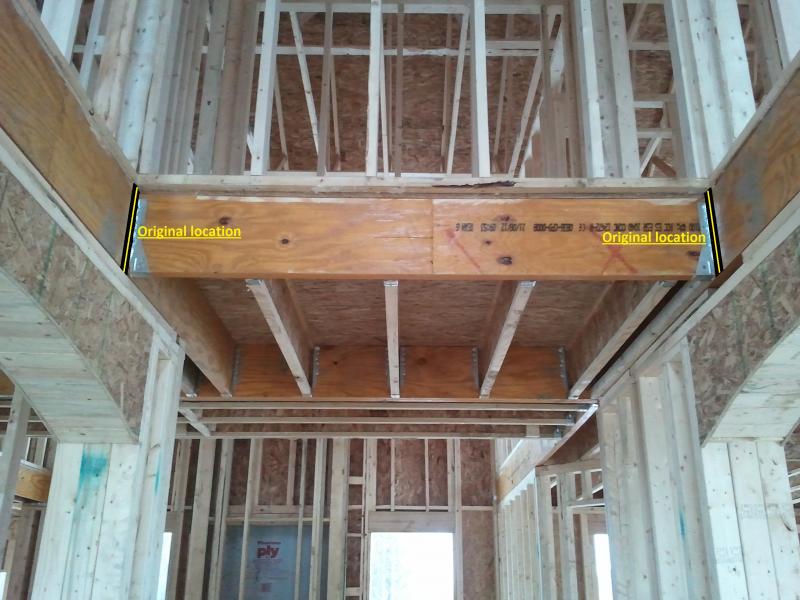

I'm having a home built and have an issue with a location in the home. My open foyer has a walk-in closet above. The sole-plate of the walk-in closet is overhanging the LVL structural beam, approximately %50. Is this a violation of bulding code?
The picture I've included is looking up at the back wall of the 2-story foyer. The beam location was originally marked to come forward, to the outside edge of the sole-plate. However, it was placed 1-1/2" back. It looks as though someone cut the joists 1-1/2" short, so the beam was moved back to accommodate.
I'm guessing the 2nd story framer didn't move the wall back and placed it according to blueprint. He did his job as designed.
Oops! He He. However, while across the pond this may be, I'm sure it's would still be a discussable part of code in the U.K.
What you have to remember is that there is still 50% of the wall that IS supported and that will likely increase as the structure is finished via flooring and further trimming etc.
From a purely structural aspect, that overhang won't be an issue, particularly if the sole plate is well-nailed to the LVL.
Your local Code may see it differently, however.
The framer should really have checked beforehand.
Thank you for all the replies. The construction coordinator assured me that it still meets code. He said at least 50% of the wall is still supported. The framer thought there would be a double beam there. He didn't realize a LVL was to be placed there. I still wish the framer would have doubled up anyway. I'll show you his fix shortly. I'm not happy with it. Oh well, as long as it meets code.
